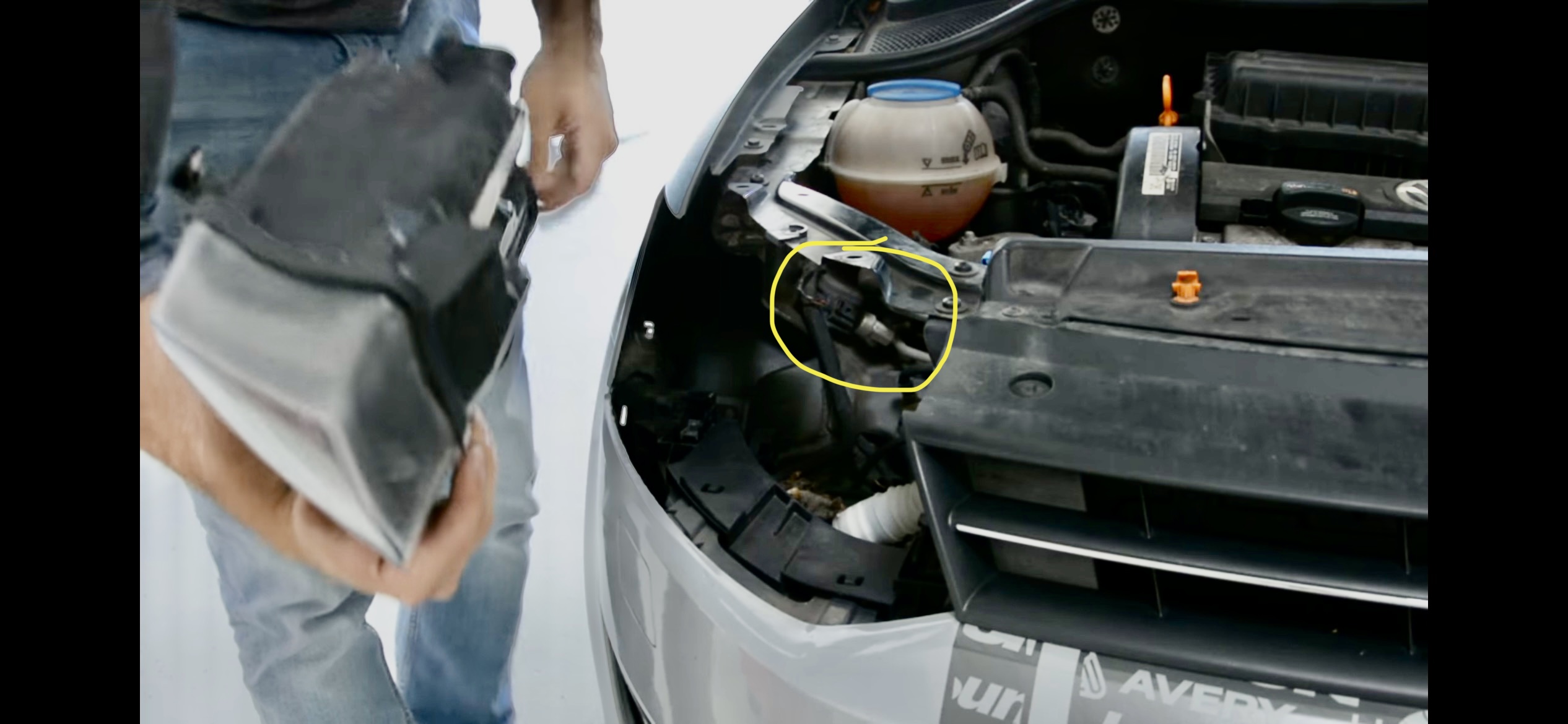

Is this the sensor , with the headlight removed?
g65?
g65?
Re: Polo 6R - G65 sensor air conditioning pressure switch replacement
Yes, that's the high pressure sender for the AC circuit.
