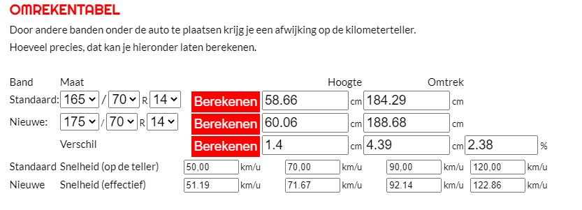

Schermafbeelding 2023-04-18 132617.jpg (55.78 KiB) Viewed 3282 times
Standaard (the ones you have now)
Nieuwe (the ones you want to fit)
So according to this, your actual speed with the new tyres is higher than with the standard tyres
This is in kilometers per hour not in miles per hour :wink:

Ah thanks Maarten ,so it's fractional .. are you a Nederlander ?

On standard tyres, car speedos over-read by up to 5%.
So fitting slightly bigger outside diameter tyres such as 175/70R14 instead of 165/70R14 will make the speedometer more accurate, not less accurate.
Google maps has a GPS speedometer which shows the actual speed, so it's easy to use that to compare the car's speedometer reading with the actual speed.
Many cars will only be doing 47mph to 48mph when the speedometer is showing 50mph.
Car manufacturers are not allowed by law to sell a car with an under-reading speedometer. Hence, why car speedos usually over-read when on standard tyre sizes.
