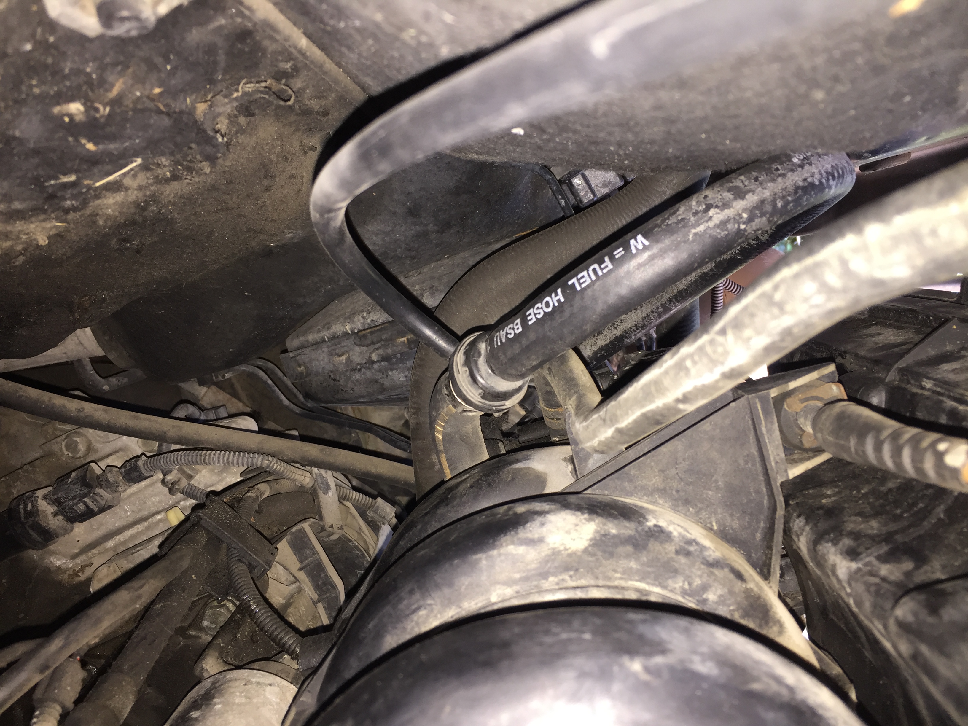

Hi friends,
I hope someone could help me pls.
When I turn my polo 6n2. 1.4. 16v 2001 AHW on and its on idle it starts to vibrate and shake a little bit and then the rpm goes up and down above 10.
I know it could be vacuum leaks, EGR system malfunctions, malfunctioning oxygen sensors, dirty fuel injectors, fuel pump malfunction, faulty spark plugs, a faulty mass airflow sensor, or a faulty throttle position sensor, so I was thinking instead of paying for diagnostic test 100usd better I would invest buying a car diagnostic tool that I will be able to use it for my polo and also for my ford mondeo titanium 2009. 2.3L
Any idea friends what should I buy?
Going back to my polo issue, I notices a broken little air pipe, maybe this could be the problem?
I attached a photo.
Thanks in advance for any help from you!
Best regards!

Re: Idle problem polo 6n2 1.4 16v
Scan tool:
If I may give you my advice, based on my own experience, I would surely recommend iCarsoft. There are many manufacturers which make good products, but I've only worked with iCarsoft. Depending on your needs and finance, iCarsoft has base entry-level OBD tools as well as high end all-purpose OBD tools. Interface is simple and service is good. So yeah, I would surely recommend it. But please inform yourself correctly, there are many scan tool manufacturers to choose from.
Air pipe:
The gray/metal part in the background to which the hose/pipe is attached to, is the fuel pressure regulator. So I'm almost certain that this can cause faults with your idle. My Polo has the same engine and the hose goes further down into the engine, but I cannot see where it leads to. Search around that area for a thin hose which should be loose. That hose goes into the part you are holding in the picture.
Air pipe:

Hi dear Juul,
Thank you very much for helping me again!
I am much appreciate your detailed reply!
Regarding icarsoft, what is their lowest model they have, That can do the work. If I had a garage of course I whould prefer to buy the most expensive tool.
According your answer about that little hose/pipe, I believe that it could be my problem!
I will check that pipe line where it should be connected and fix it. I will update if it fixed the problem.
Thank you so much again dear Juul!
Best regards,
Eli

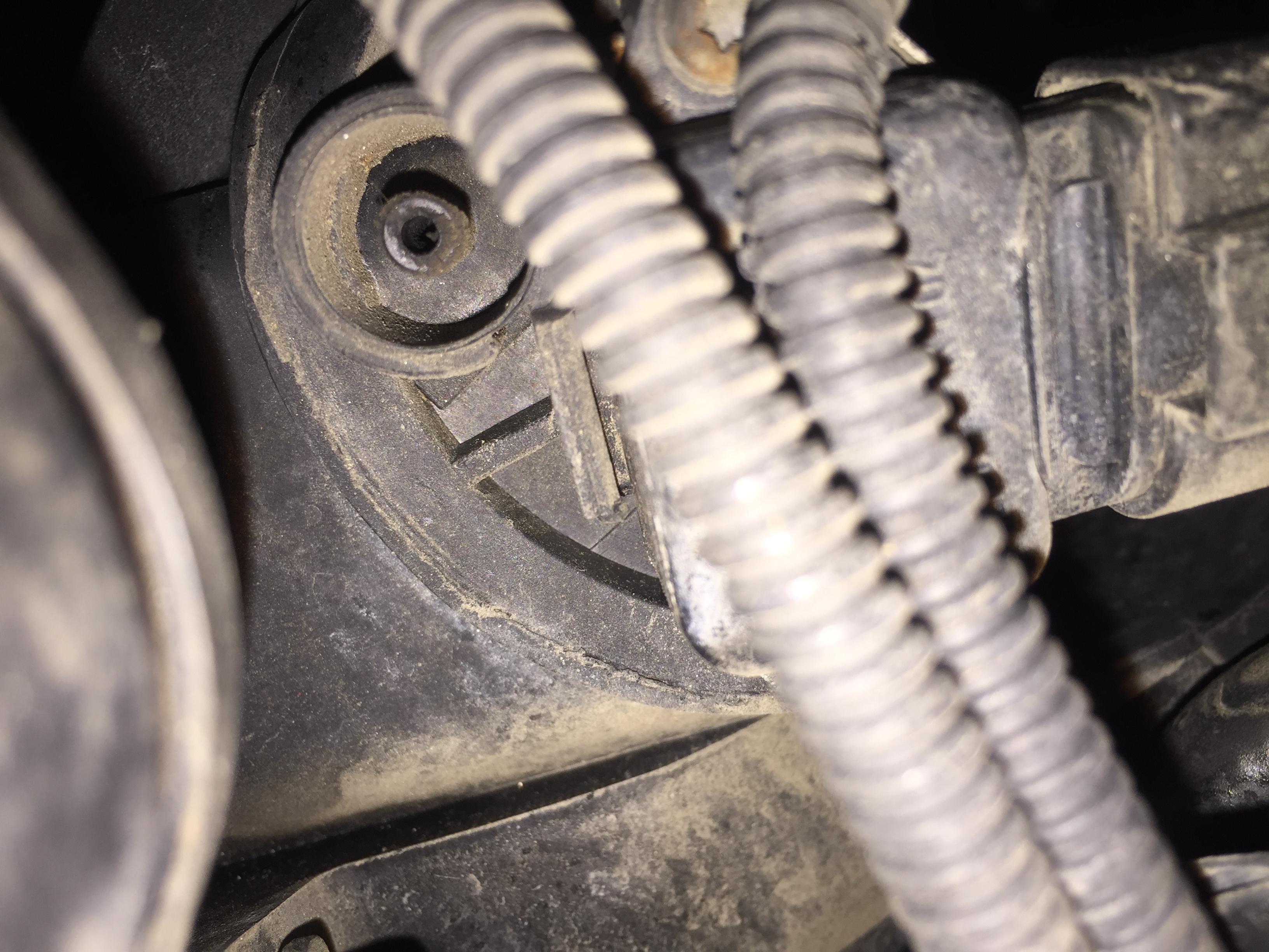

Hi Juul,
How are you? Hope you’re fine.
I have been searching again and again and find that this hole on the inlet manifold is connected to other place, But I noticed that there is a little air connector on the air valve that leads air to the Vacuum servo that was not connected to nothing.. and it has the same diameter of the fuel regulator connector, so I connected them with the pipe and now the Car idle went back to normal, and the engine works smooth and not smoking!
I attached a photo of this pipe, hope it could help others to solve this problem.
Thank you very much Juul my friend,
God bless you!
Eli
Hello my friend, I'm very glad to hear your problem is resolved. Luckily it was something simple and inexpensive. Don't worry about it, I'm already happy I was able to help. Uhm...I'm an atheist...but I respect and accept your blessings. Now you can enjoy driving your car once more. Good times ahead

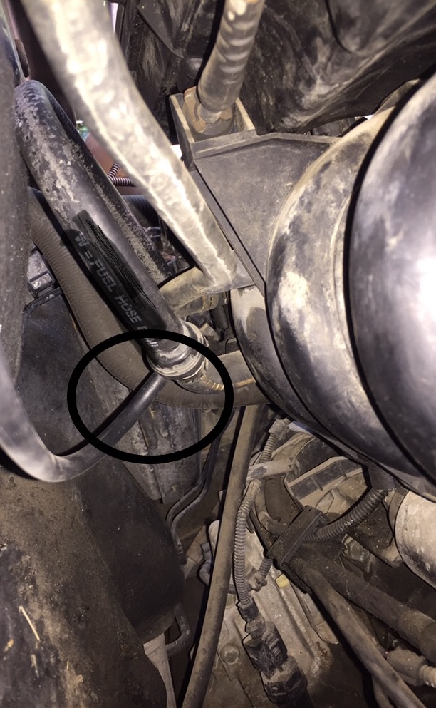

Hello Juul my friend,
I just wanted to update you and all the other users for the right solution I had with that vacuum pipe..
I discovered the right hole where the fuel regulator vacuum pipe should be connected too. It’s at the side of the engine just below the fuel regulator!
(so now I have another issue, where to connect that tiny vacuum hole from the break servo? )
I attached a photo, hope it will help everyone who has this issue, on polo 6n2. AHW 1.4 16v cause I didn’t find any clear photo or information about this on the web.
Enjoy and special thanks for Juul for helping me along the way..
Best Regards,
Eli

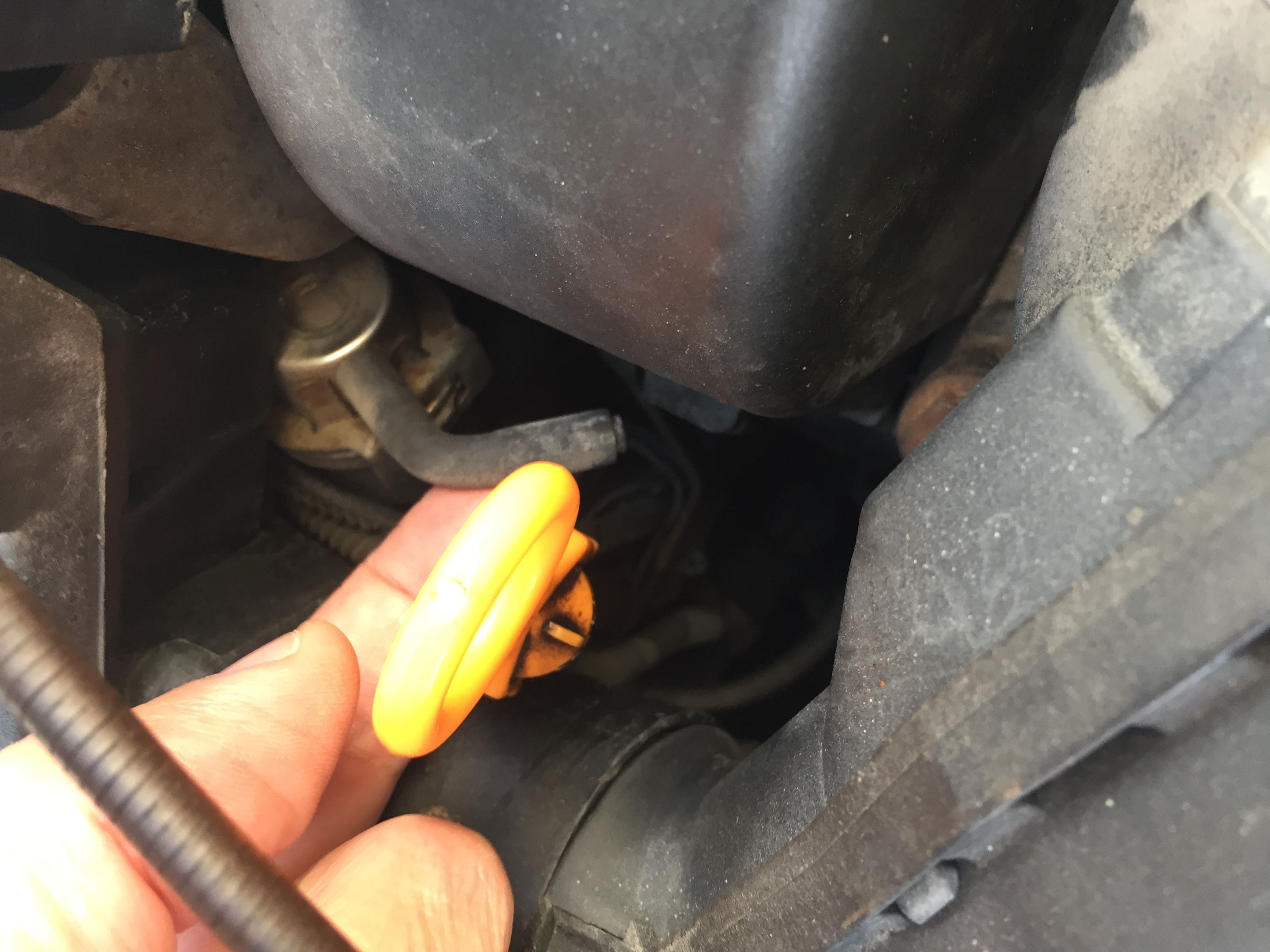

Now I need to find out to where this tiny air vacuum hose should be connected to? (marked in black round on the attached photo).
The big hose is connected to the break servo, this we know.
thanks for any help from you friends,
best regards,
Eli
Hi friends,
Please could someone help?
It’s not such a big request
If you have polo 6n2, when you check oil or water level have a quick look where this hose is connected to.. that’s it very simple
I know there is a tiny hose down the throttle, should it be connected to there?
Thanks a lot in advance for any help from you.
Best regards to you all,
Eli
