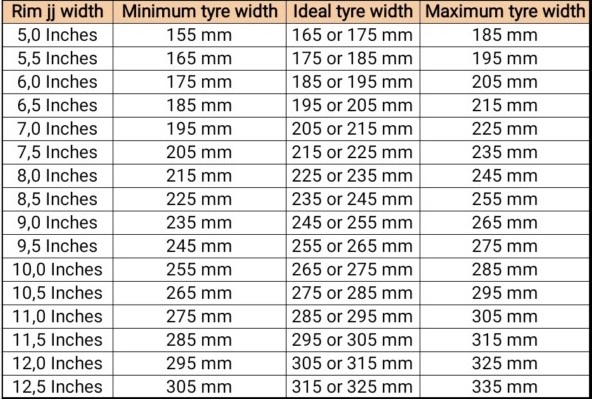

Also, IMHO a 205mm wide tyre is very narrow for an 8.5J alloy unless you’re going for the extreme stretched look (would a 205 width tyre even stretch enough and still be safe on an 8.5J alloy?). I personally wouldn’t fit a 205mm wide tyre to anything wider than a 7.5J wheel. The ideal tyre width for 8.5J alloys would be 235mm or 245mm; see below;
If you go wider than 205mm tyres;
- there’s an increased risk of tyre rubbing with an 8.5J wheel with adapters fitted, as the face of the wheel and outside wall of the tyres will poke out quite a bit further than the factory wheel / tyre set up.
- you’ll need to go lower profile than a 40 section tyre; if not, you’ll get a speedo reading error.

That chart is over-simplified, as it doesn't include the tyre's aspect ratio.
Here's a useful chart, that's been extracted from a 2016 ETRTO manual.
All of the big car companies such as VW, and all of the big tyre companies such as Michelin, have to follow ETRTO's Rules.
ETRTO approved rim widths for passenger car tyres
