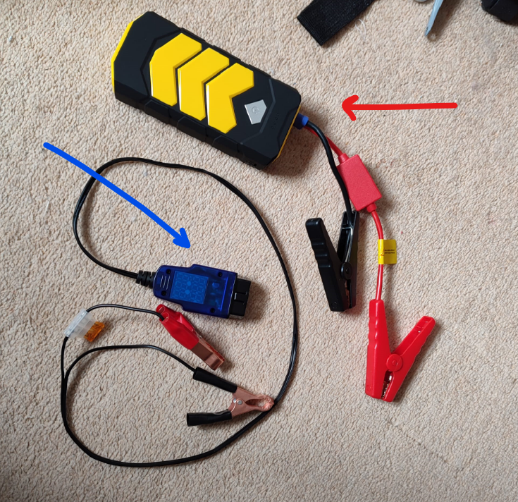

First of all - you NEED a memory saver and a power source for it: If you don't keep the car's memory powered you will lose all sorts of settings you have made for the car and the Radio security code etc. See photo of my kit below... An OBD plug for the OD socket (blue arrow) and something to power it - My 12v car starter battery (red arrow) was perfect and I knew it could keep the power going long enough to last the battery changing time.

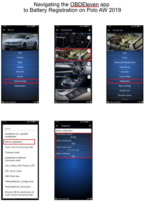

from other YT video... It seems there are a few different ways of battery adaptations out there for OBDEleven app. some require you to enter the three sets of data in one line separated by a single space and others are a lot simpler Just four fields to enter battery data. I didn't know without looking first and it put me off doing it myself at first; for two reasons.
The battery I bought does not have the OEM type code on it and I would not be able to input the single line adaptation code without that information. So.. check with the app FIRST just so you know what you are letting yourself into! If you check after it is fitted and you don't have OEM coding on the battery you won't know what to enter. and second .. It would be frustrating to get all the heavy work done only to stall at this point.
However IF (as in my case) you have the simple adaption method.. it won't matter either way.. all the information you need will be on the battery - AMP Hour (60 in my case) Manufacturer (I put YUA for Yuasa) Serial number. (it was already, for original battery) 10 x 1s in my case so i entered 1111111112 to register a different battery) then the type of battery (it was already EFB so I left it as it was)

Now put your battery details into the adaptations section of the app. Phew!

forgot OBDEleven app route to battery adaption .. on my version.

The more involved way to reg new batteries really only applies to much older VW Group cars when BEM was king, that restrictive nonsense was thrown away years ago, my old 2011 Audi S4has that "way of working", but my wife's 2015 VW Polo is the newer easier way of reg'ng a new battery.
It is, in my simple mind, a bit strange that VW and possibly Skoda just preload the "serial number" field with "1's" whereas Audi and SEAT do actually load that field at the assembly line, with the actual battery serial number, I'd think that the QR on VW Group is there mainly to make that easy to do at the assembly stage, but who knows why VW and Skoda save a bit of time by ignoring that.

regarding the long route to battery adaptation.. I got put off initially because in a particular YT video (and i must have seen tens of them LOL) it had more steps to it (on the same OBD11 app) and it was on a young-ish vehicle (2017 Audi)
it could be the app has since been updated but the route to it was similar to my first three images in second post and then went awry and away from mine.
Regarding the battery booster... I guessed there would be some capacitance in the ECU but i was already anxious about doing it and 'if' the battery didn't come off as quick as expected, didn't want to risk it; not knowing the full implications. I will say check the output of the booster... I found mine has timed out in the past after 20 seconds on the 12v utility socket unless there was a certain draw on it.. whereas the jump/crocodile leads were, on a similar low draw load, able to keep live for 20 minutes.
I did toy with the idea of using the battery I bought and some fancy wiring... it could have worked on paper but again the anxiety showed up.. I suppose this is all amusing to many here who know coding backwards and have a lot of expereince in all of this.. I'm just hoping it will be useful for a newbie (and still am) like me.

With regards to your capacitive jump starter, my lack of knowledge of what exactly it was offering was why I was questioning using one of them, but it seems that it offers a "12V support" output, so okay. Really just a better safe than sorry way of thinking for others to consider before using one of them.
One question on that capacitive jump starter, can or do you check it for its ability to boost a battery now and again, I'm asking that question because I'm sure that I've read maybe on another motoring forum of someone ending up being let down by his one, when trying to give another car user assistance! So, as his father also bought a similar but not the same brand one at the same time, he thought that he'd check that one out, it too failed, both maybe 4 years old. Root cause of failure was unknown. They do seem extremely handy and compact things to own though, I've just not bought one yet.

My booster: I have used it on my neighbour's car many times last winter when the battery on his diesel let him down. I had it for a year before actually needing it so did wonder what was going to happen when the neighbour knocked the door 8 am Sunday morning and asked if I had jump leads.. (I don't) It spun the engine so fast a few seconds after hooking it up!.. from the few times I used it without charging it back up I guess I could have used it up to 7/8 times esp as it started quickly rather than labouring. I did start my brother's 2.5 straight six, petrol, BMW.. that turned over well but took at least three seconds of turn over before coming to life. So perhaps just 4 times for that scenario before recharging it.
This pack has jumped in price, as has everything else, since I bought it.
