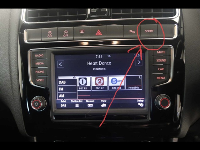

where is the button located so I can check if I have it?

WaltD96 wrote: Sun May 21, 2023 11:26 pm
SRGTD wrote: Thu May 18, 2023 5:22 pm My previous car - a 6c Polo GTI with manual gearbox - had the Sport select button which was part of the optional Sports Performance pack. When the Sport button was pressed, you got;
- firmer suspension than the ‘normal’ default setting
- increase in the fake engine noise
- increased throttle sensitivity
- weightier steering
