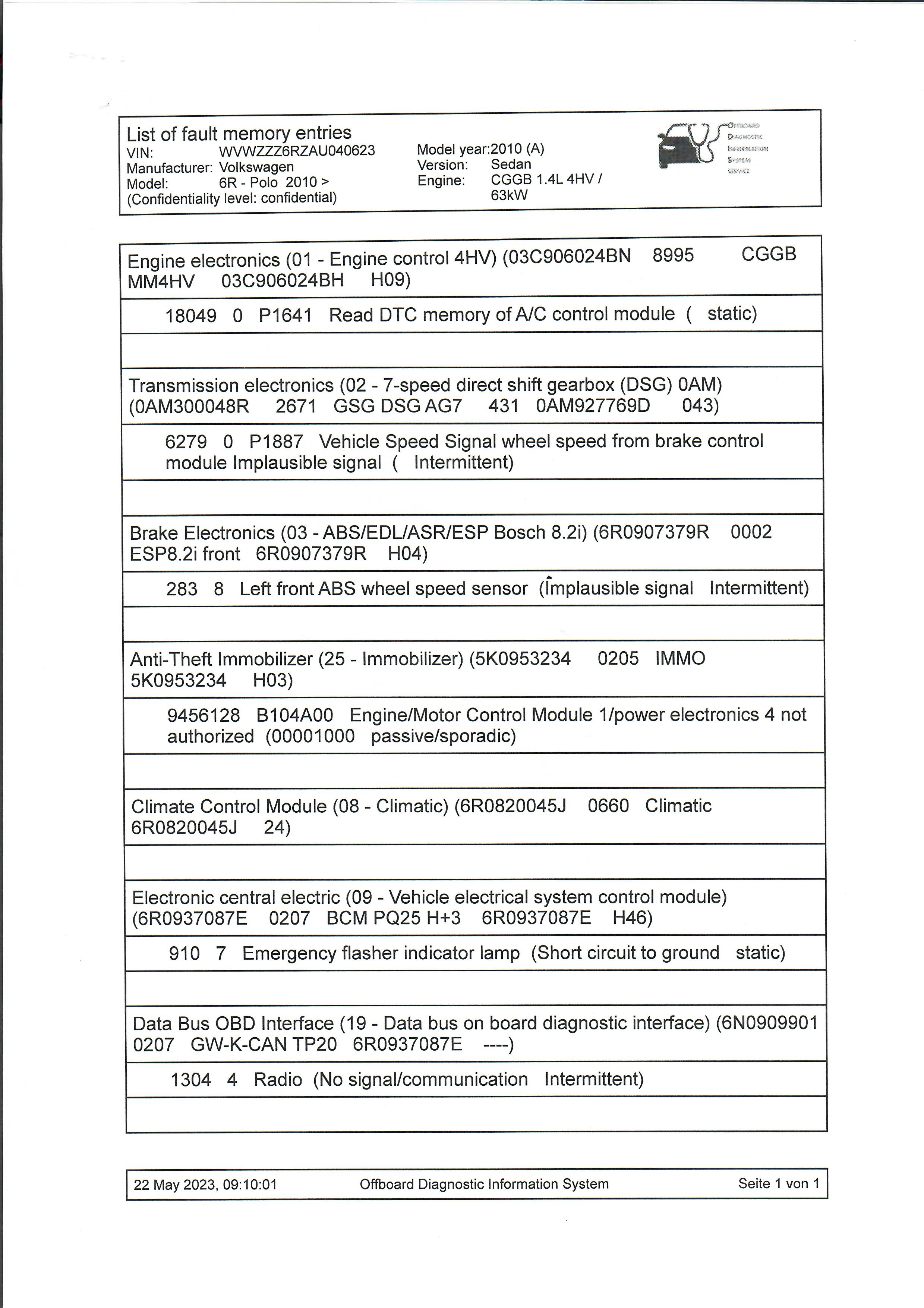

Hi
I had the dealer read my car's fault codes. See attached. That is all I asked them to do, and that was expensive enough.
They wanted to do diagnostics, but for waaaayyy too much money.
The reason I asked them to read the fault codes was because I was getting 3 orange warning lights, all related to speed.
The symptoms are consistent with a bad wheel speed sensor or module.
The report indicates module or speed sensor faults. I suspect the sensor, only because it is located in a hostile location.
Do these cars have a history of wheel speed module/sensor failures?
- List of fault codes
- Image (196).jpg (803.91 KiB) Viewed 5008 times

Re: Dealer read fault memory codes : wheel speed sensor
Yes, it's possible for a sensor to fail. Another possibility is for the wiring to be damaged.
Hi
OK I removed and tested both front wheel speed sensors.
The left sensor measures 2.2kohms.
The right sensor measures 28Meg ohms.
If the sensor is a coil, then the left one looks OK and the right one is faulty. However that is the opposite to the VW code report.
I also measure the voltage from the car loom when the ignition was switched to run, but engine off. The sensor was marked +ve and -ve.
Left connector -1.48VDC
Right connector -2VDC.
That indicates the wiring is OK. Not sure about the voltage values. I expected to see positive volts and more of them.
I read someone had similar symptoms that turned out to be a bad ECU earth. Where would I find that? Note that salt is not used on roads where I live, so corrosion is not too much of a problem.
So one of the wheel speed sensors is not like the other. I suspect the right one is faulty, but that is not what the mechanics VW scanner said. It is possible I have multiple faults, but the car drives OK.
Any hints?

- Posts: 9037
Hi
I would buy and install two new front speed sensors (L&R) in hopes of fixing the problem.
They have been replaced by new ones with B letter at the end of the reference number, ... can be found in various places at very reasonable prices.
If you have any diagnostic tool that can read wheel speed sensors, connect it, and turn the wheel by hand and see if the lice data changes.
What wheel doesnt thats the one
