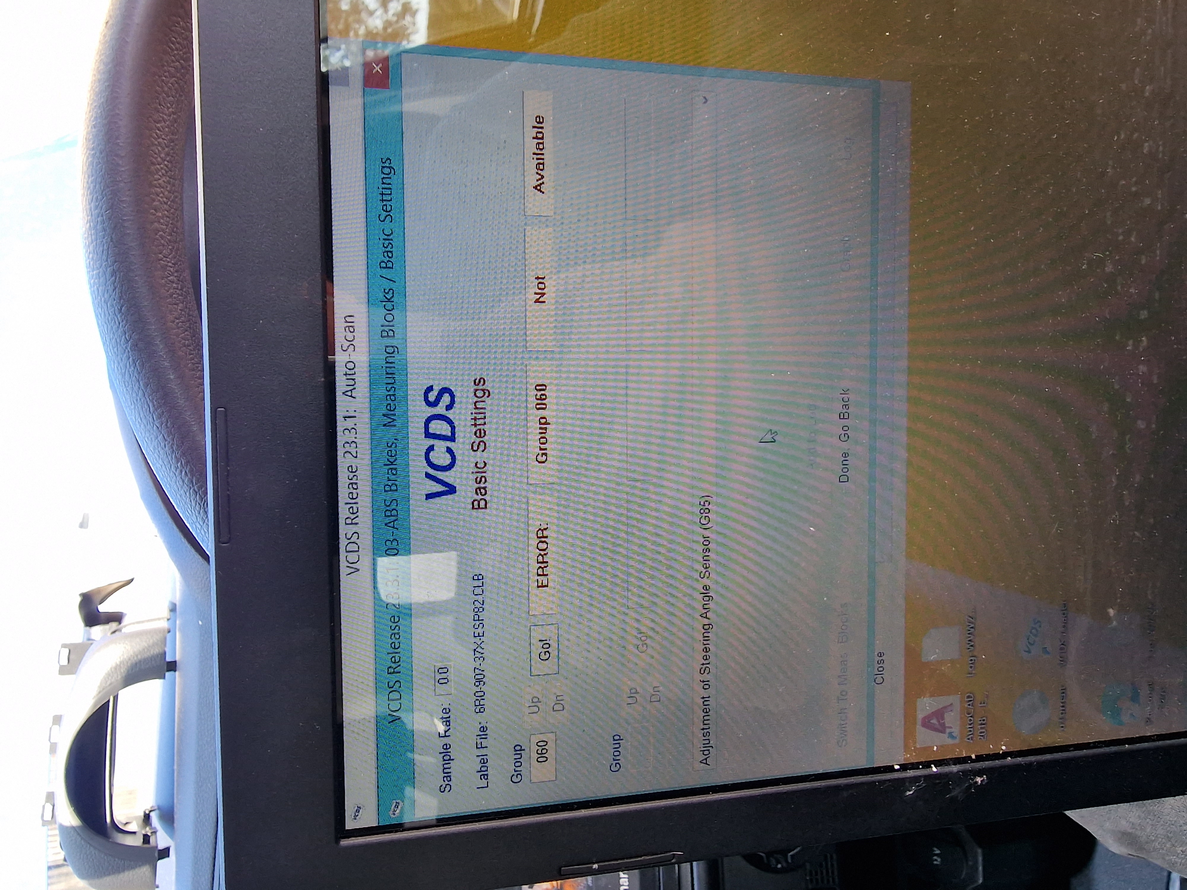

Re: Steering Angle Sensor Problem
I have tried the full lock left right and centre then drive under 15 miles hour but still won't set.
It comes up with error for steering adjustment g85 as well.
I must have tried at least 5 to 10 times now.
Is there anyway basic setting can be put back in with a code.
Thank you
Thank you

This is what I get
- 20230603_154737.jpg (2.95 MiB) Viewed 6045 times
- Posts: 9037
Do this procedure (it doesn't matter if it's for Polo 9N3, it's the same principle).
http://wiki.ross-tech.com/wiki/index.ph ... Bosch_5.7)
Remember to enter the Security Access 40168 before going to the Basic adjustment.
Remember to do the procedure with the engine OFF/ignition ON.
Recommendations, notes:
Before doing the basic adjustment, drive completely straight for about 20 meters on a completely flat surface, stop. Considering the center position of the G85 sensor, mechanically/manually adjust the center position of the steering wheel and the combi switch levers. You will find markings/indications on the parts and also use common sense so that everything seems centered. ....They are usually a little more than two turns of the steering wheel on each side.
Again drive as straight as possible another 20 meters, stop, Engine OFF/Ignition ON, and start with the above procedure for the basic adjustment of the G85.
Once you click on the procedure, you will not see any progress, everything seems not to work, because the angle data is captured when you close the dialog (Done, Go back) and exit the ABS unit. If you help yourself with the measurement of values (G85 angle) you find those 0º +/-5 more easily.
Then the warnings/lights on the instrument panel will go away and the Basic Adjustment will be done.
Here, on occasions, the breakage of the internal ribbon cable of the G85 has been reported due to incorrect previous installation.(in case of not taking into account the markings/indications of the center position)
By the way, ODIS S does not have a guided function set for this procedure.

Thank you I will give it ago tonight.
- Posts: 6695
Just making sure, did you install stalks with a 6Q0 or 6R0 part number?
From my experience, your ESP8.2i is not compatible with the 6R0 steering angle sensor, that comes with 6R0 stalks.
The 6Q0 steering angle sensor, that comes with the 6Q0 stalks and are factory for your car, should be fine.

I would just like to thank you both for helping me out with this.
It has worked this time.
I think the key to it all was stay away from basic settings until security has been done and the ignition on but not running (think I always tried it running but not sure.
Thank you very much.
