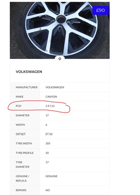

2226 wrote: Wed Jun 14, 2023 6:23 pm Don't forget the Canyon in 17x7.5 ET38.
The Canyon is an alloy for the VW Caddy van and has a 5x112 PCD (see screenshot below) so won’t physically bolt onto the Polo’s hub assembly as the Polo’s PCD is 5x100.

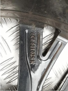

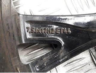

2226 wrote: Wed Jun 14, 2023 6:23 pm Isn't the ET on the Parabolica on 6C a ET35?
No, genuine OEM VW Parabolica alloys - part no. 6C0601025K - have an offset of ET44; see screenshots below of the reverse side of a genuine Parabolica. I’ve seen cheap replicas in the style of the Parabolica’s with an offset of ET35 though - see link below;
https://www.redpowermotorsport.ie/produ ... le-wheels/
Genuine Parabolica alloy; size/offset and part number;

2226 wrote: Wed Jun 14, 2023 7:13 pm I run Canyons.
The Cross Polo was never sold in the UK, so it’s unlikely there’ll be any Canyon alloys in the UK with the correct PCD of 5x100 to fit a Polo.
