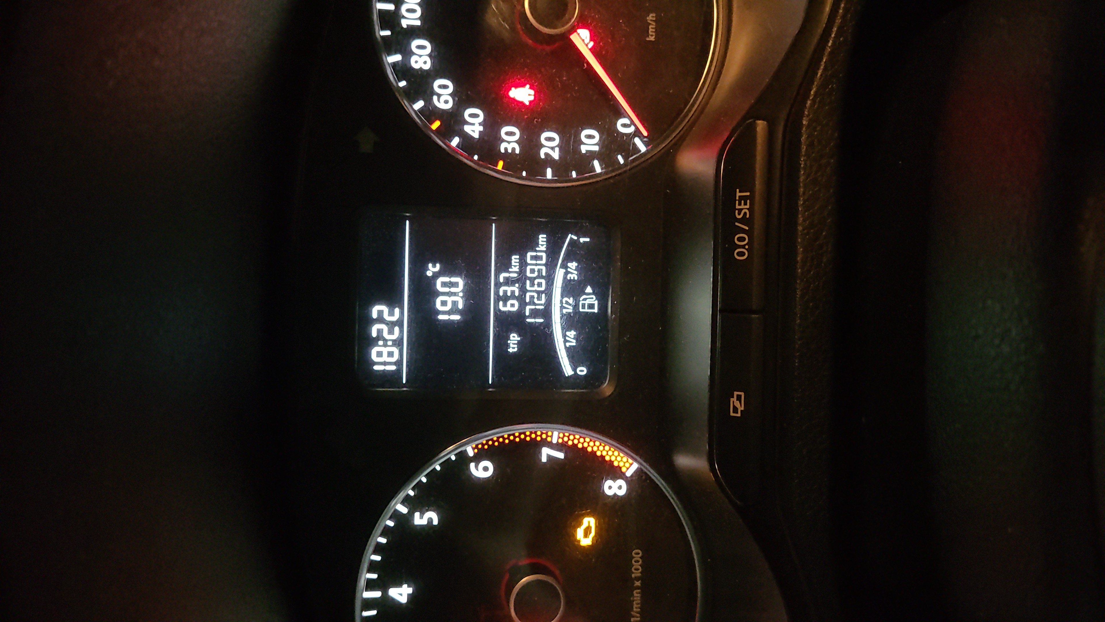

Hi Again,
I have some problems:
1. Front fog lights works but during they are switched on, doesn't light indicator on dashboard. How ever indicator of rotary swith lights correct.
2.Rear fog lights works, indicator on dashboard works but light on rotary swith doesn't work.
3. Full beam headlights work only if I swith lever to my side. If I push it to the front, full beam headlights doesn't work.
I don't know how it works before retrofiting.
Best regards
Lukas
Posts: 9037
Re: Again - auto headlight retrofit. Where to get harness?
wide23 wrote: Mon Aug 14, 2023 8:45 am Hi Again,
Best regards
Lukas
1 and 2 is correct, it is as it should be.👍
3 for high beams to work permanently (by pushing the lever), the low beams must be ON. ... :?:

Another topic:
Can I setup more parameters to display?
I have cruise time only and outside temperature.
Dot
Dot
Posts: 9037
With your MFD-low, if you have or install :arrow: viewtopic.php?t=65096 the right stalk/lever with the TRIP - OK/Reset switches you can access some more information.
:arrow: :arrow: https://www.team-bhp.com/forum/diy-do-y ... st3484474🙏
With a new IC with MFD-High and a multifunction steering wheel*/*2 you will have access to more information and menus.
* Several models. Configuration depending on the year of construction.
*2 Everything has dependencies, do not purchase parts without properly informing yourself of what is possible.

I dont have column swith like this. So I have to switch it to 6Q0953503EE or 6Q0953503EH (DT, EJ?) (with cruise control)?
Does it require any other mods (say nothing of coding) if I want to keep MFD-low?
Regards
Lukas
