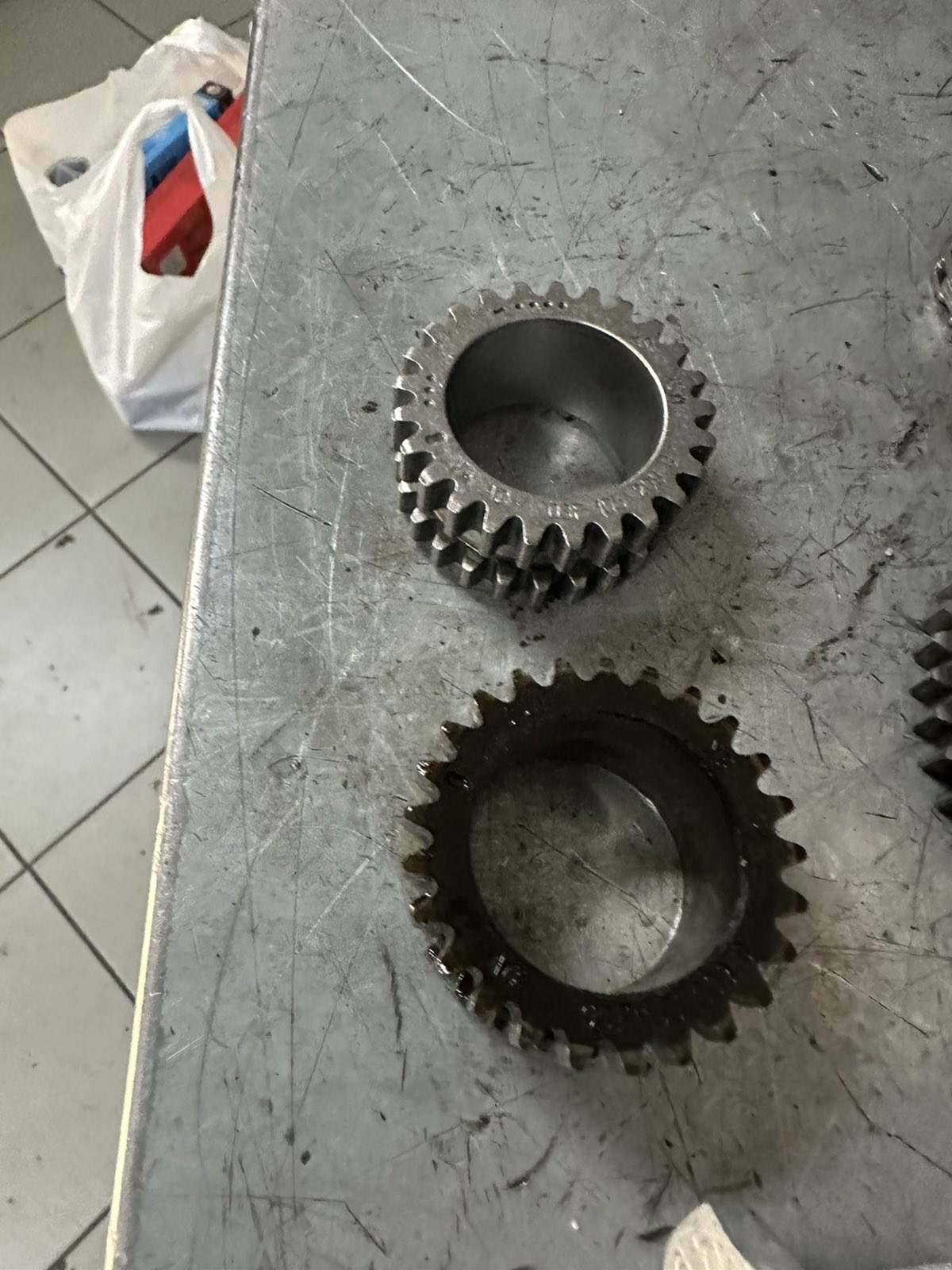

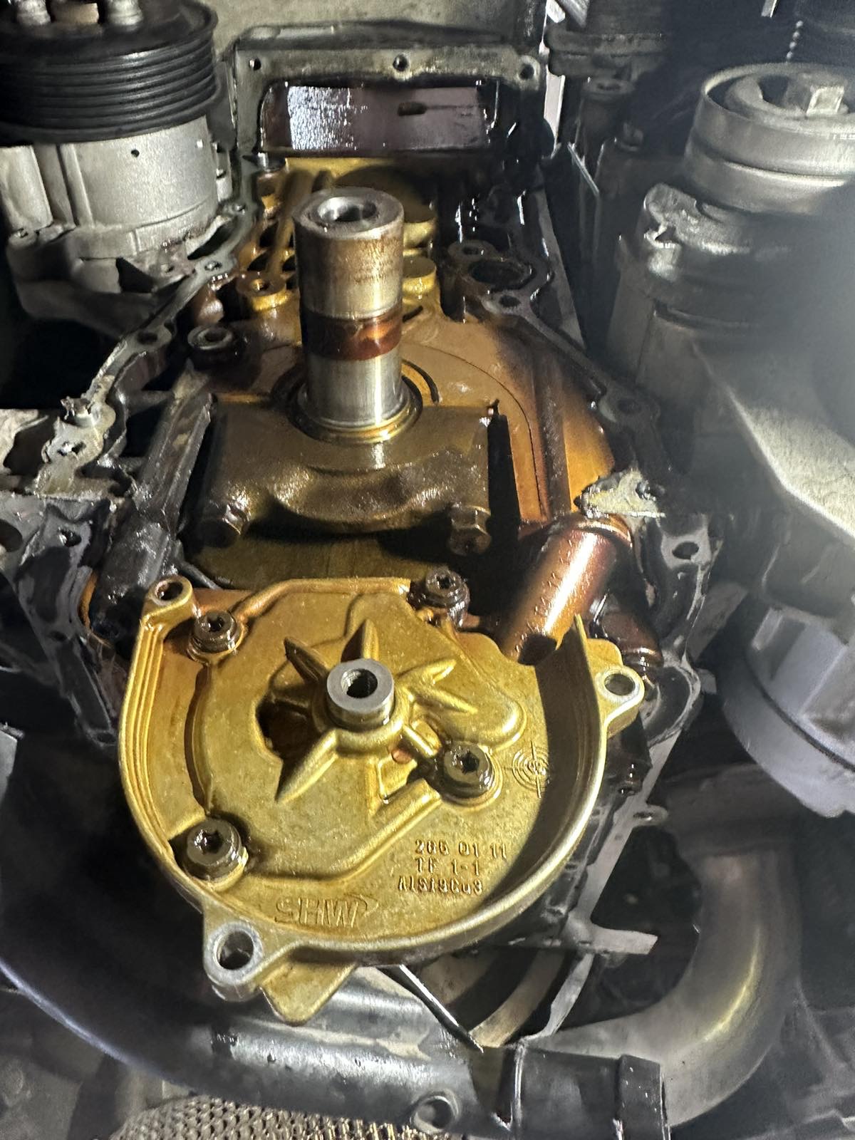

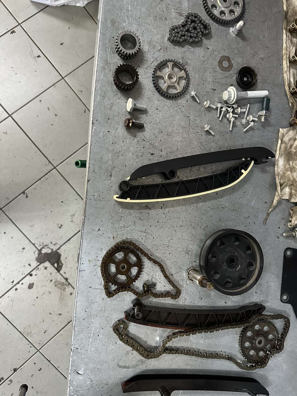

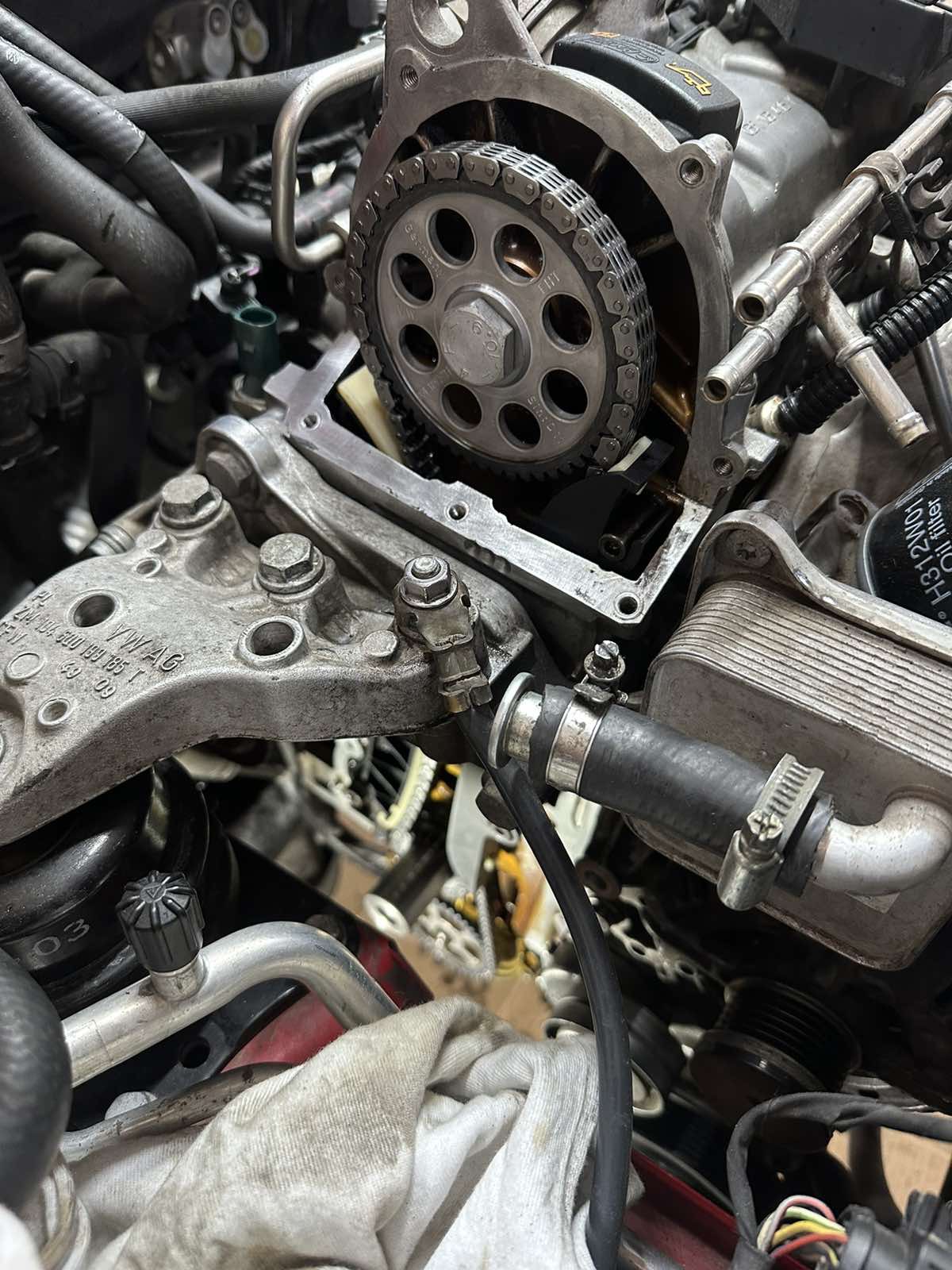

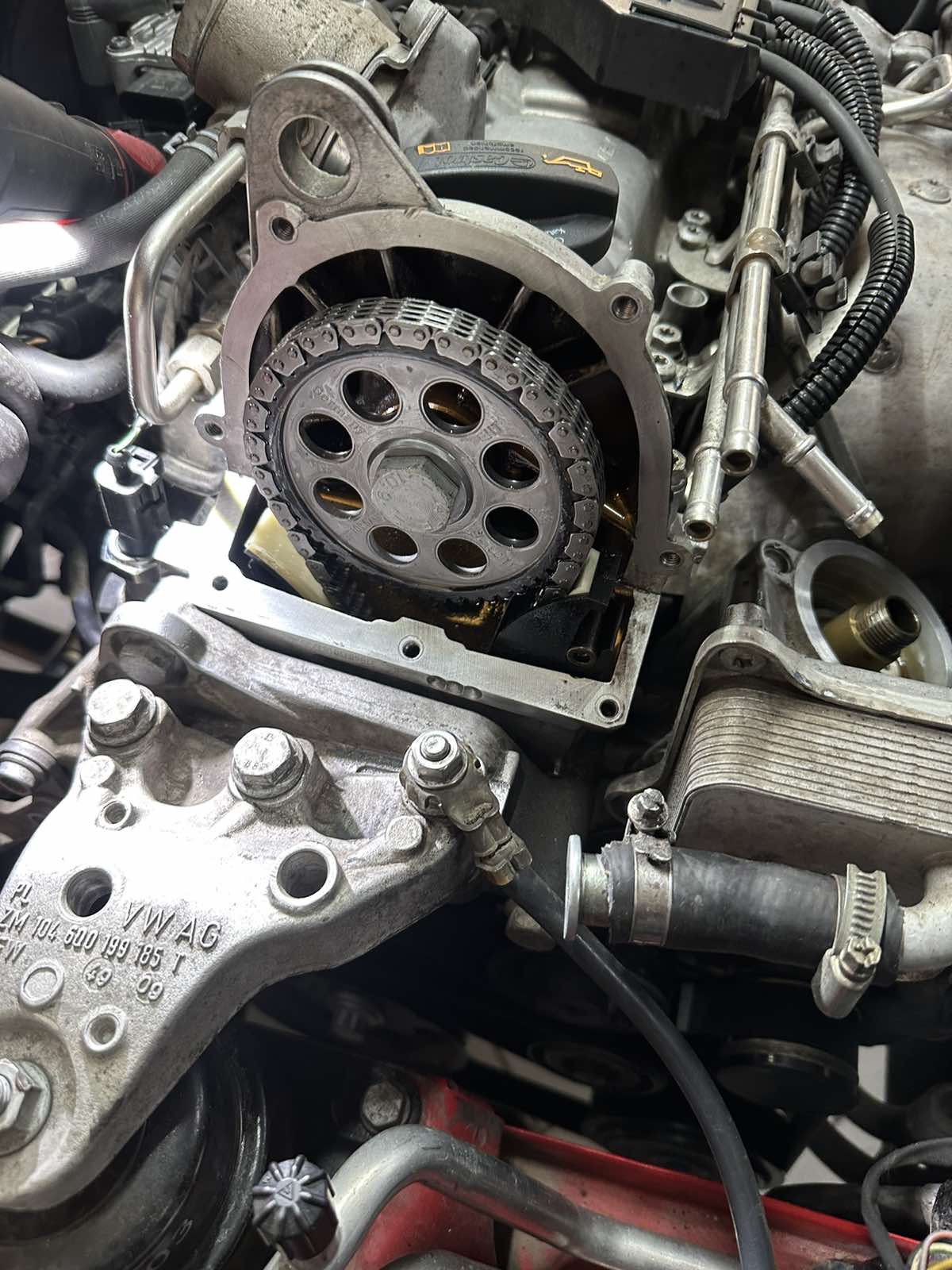

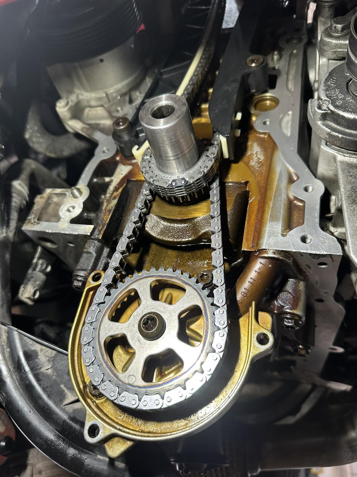

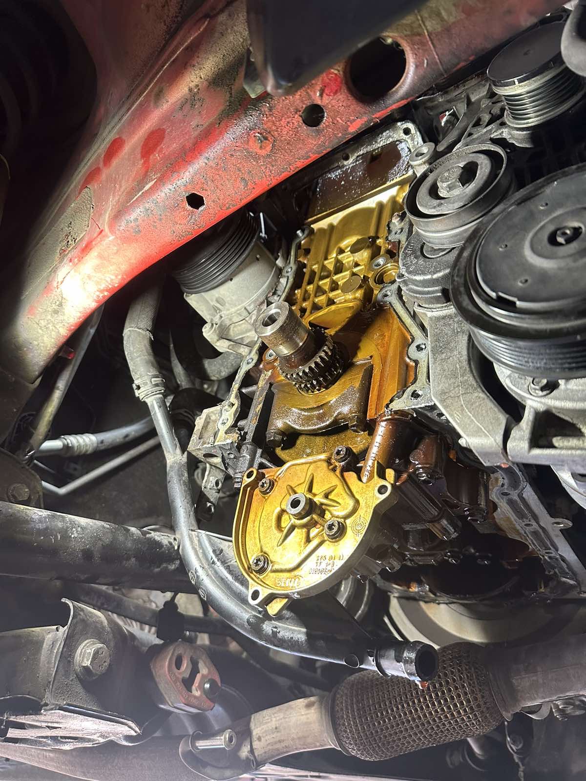

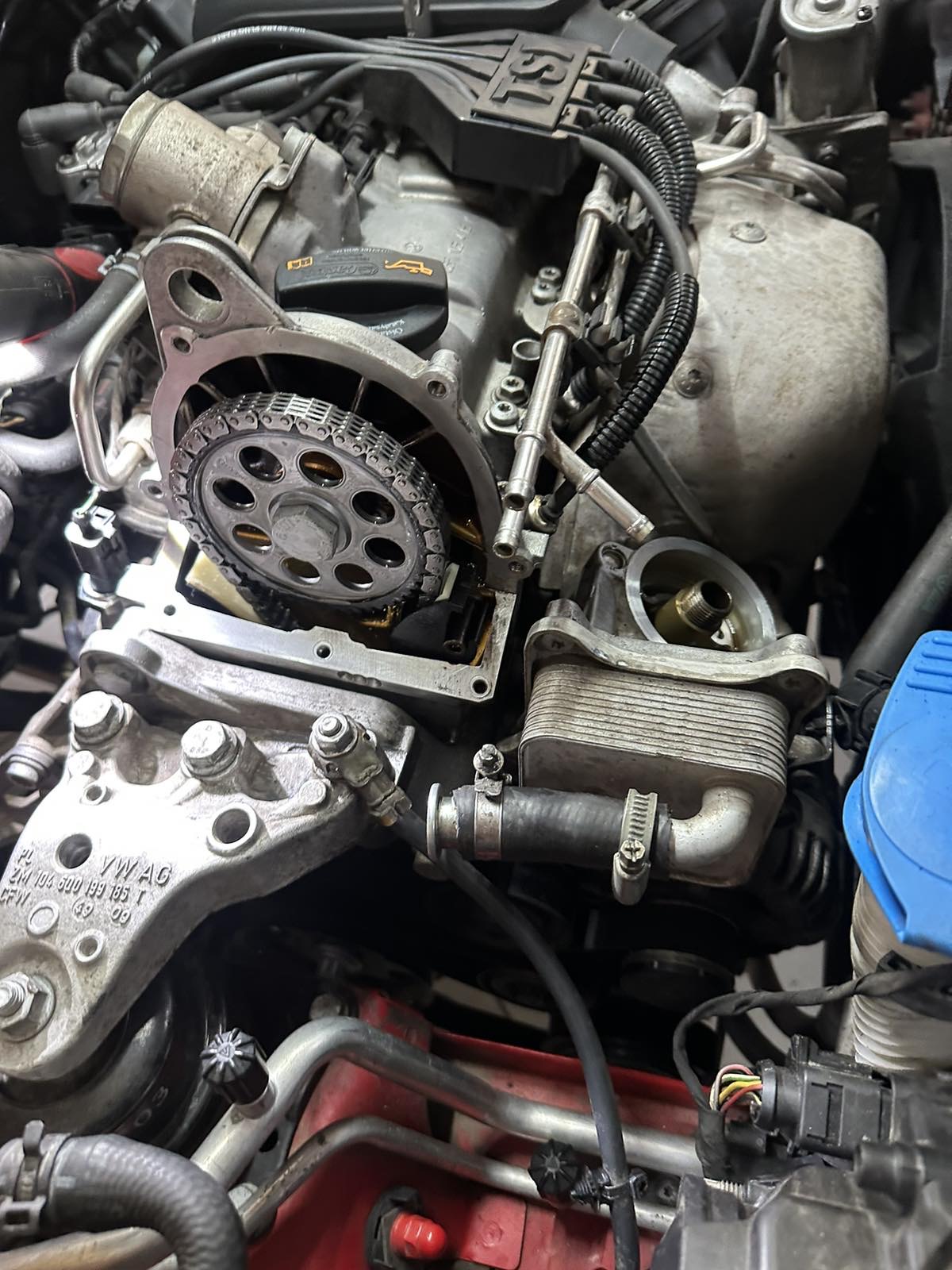

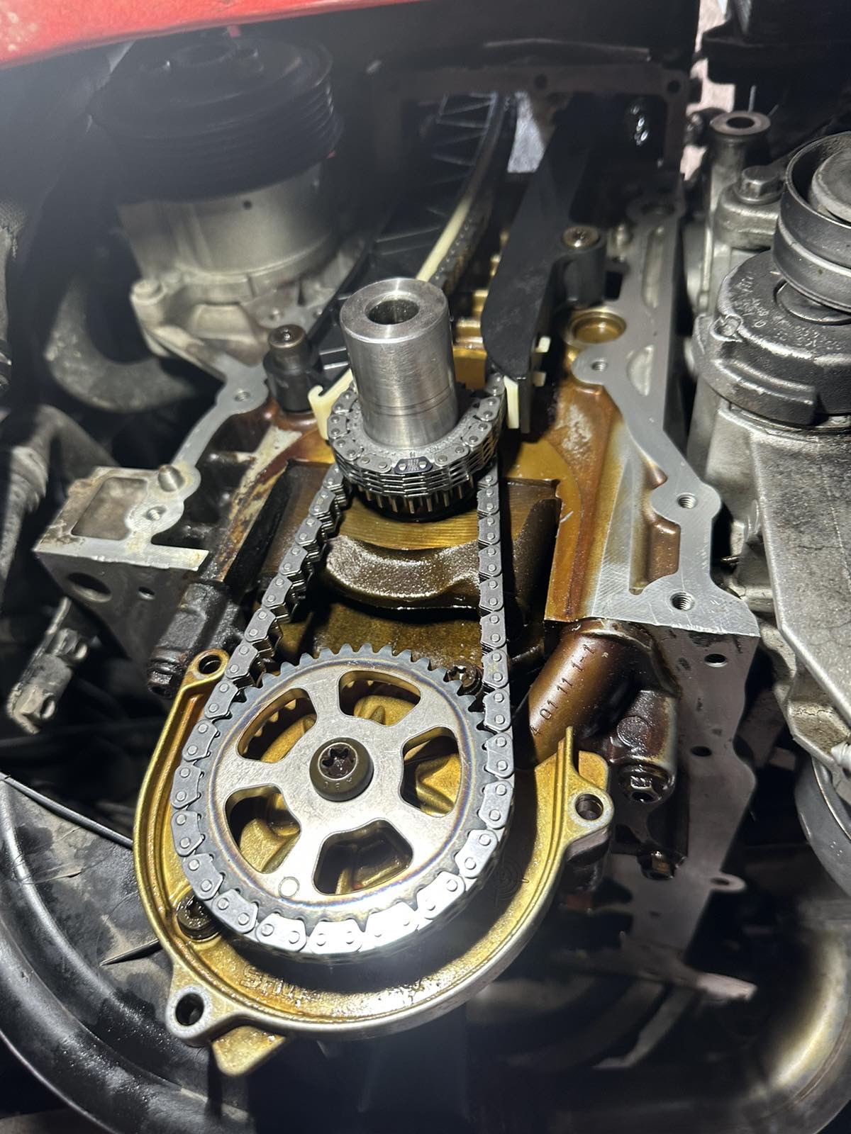

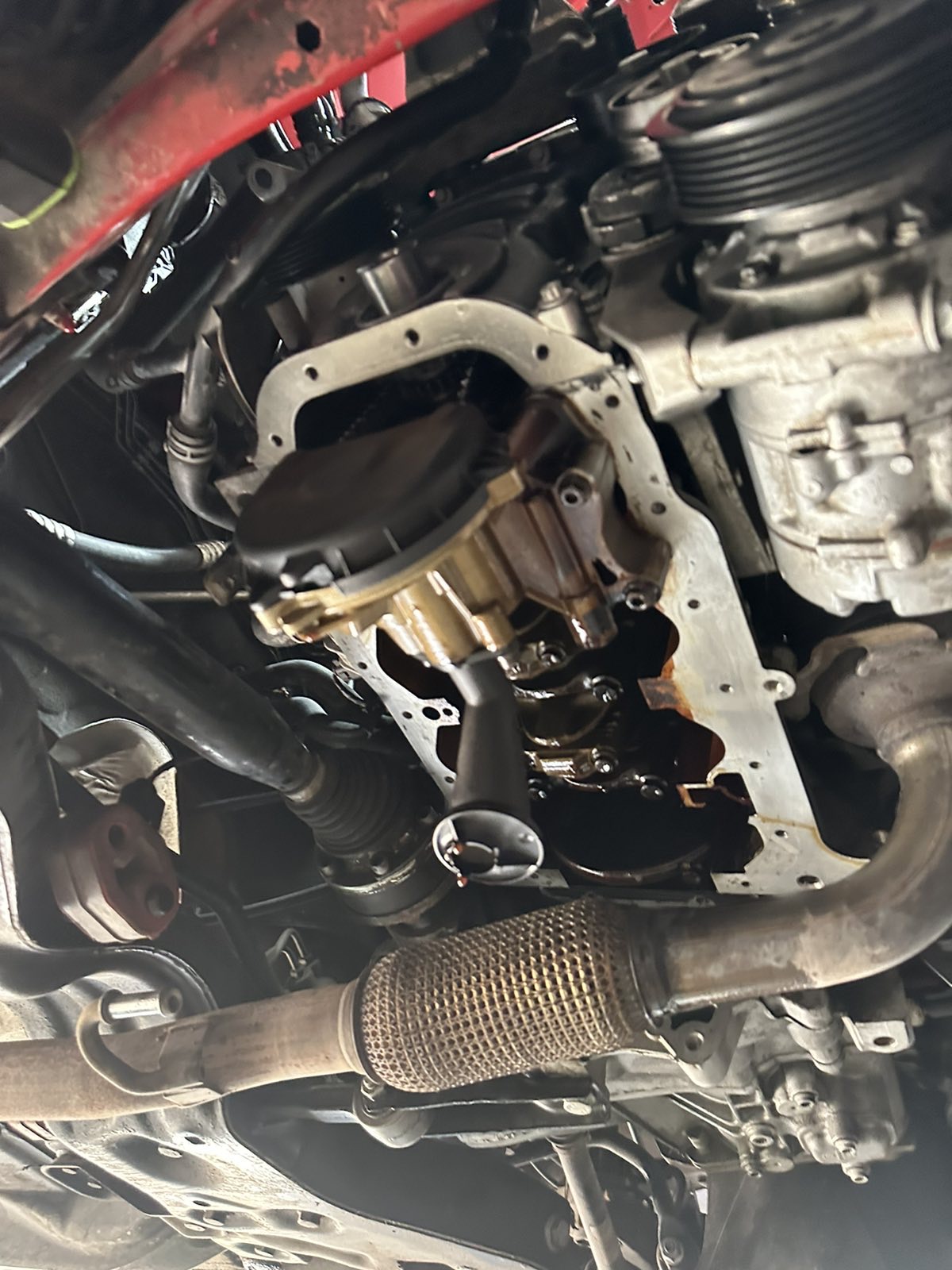

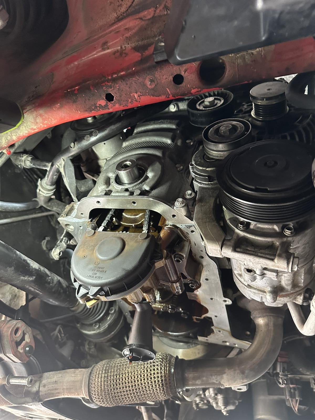

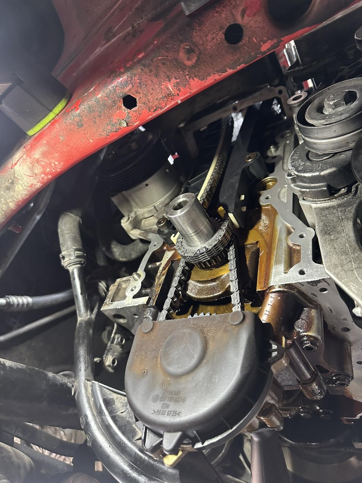

2. Finally found a mechanic to install me the kit B cam chain kit, along with new oil pump gear and chain
Comments on this job:
The engine was in good condition, oil pickup was clean and the oil pan was spotless.
