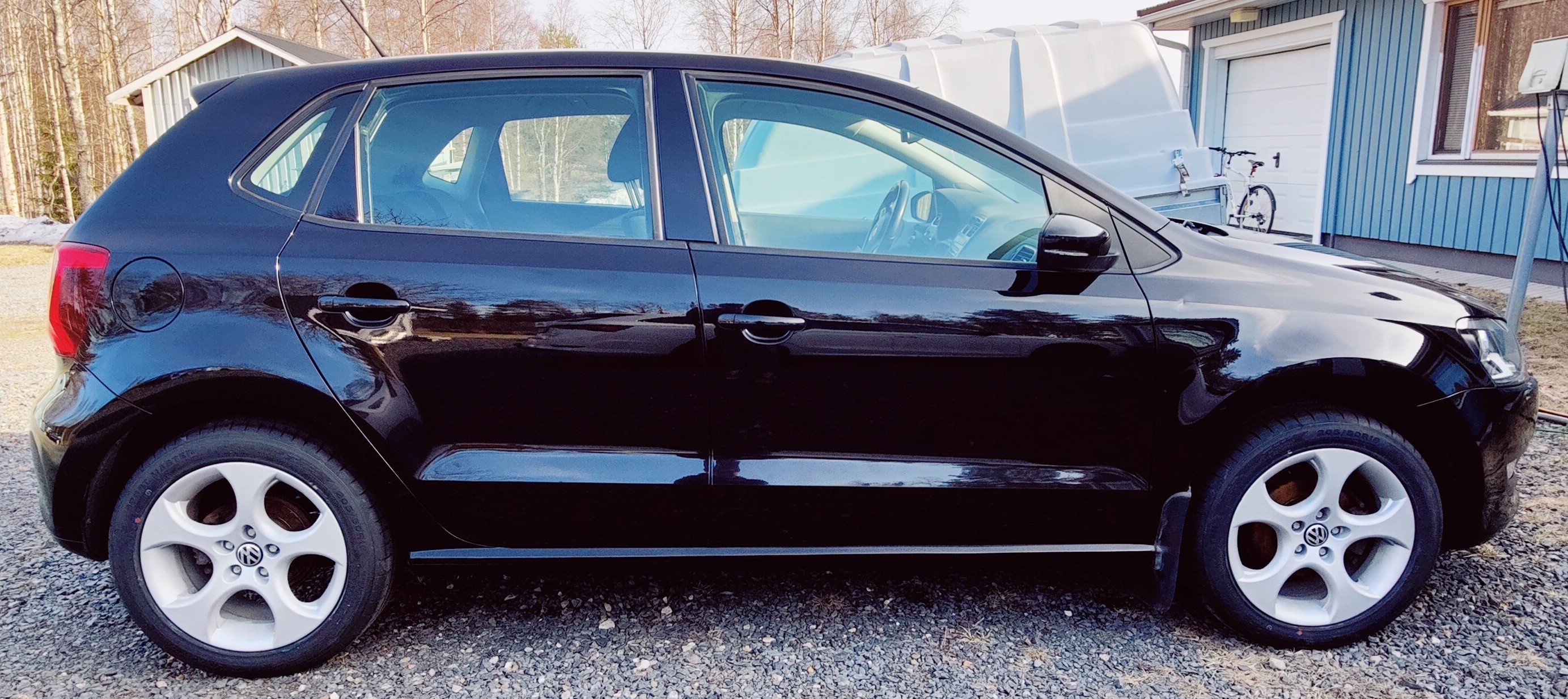

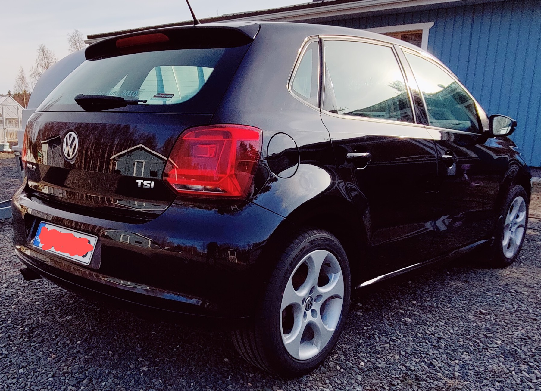

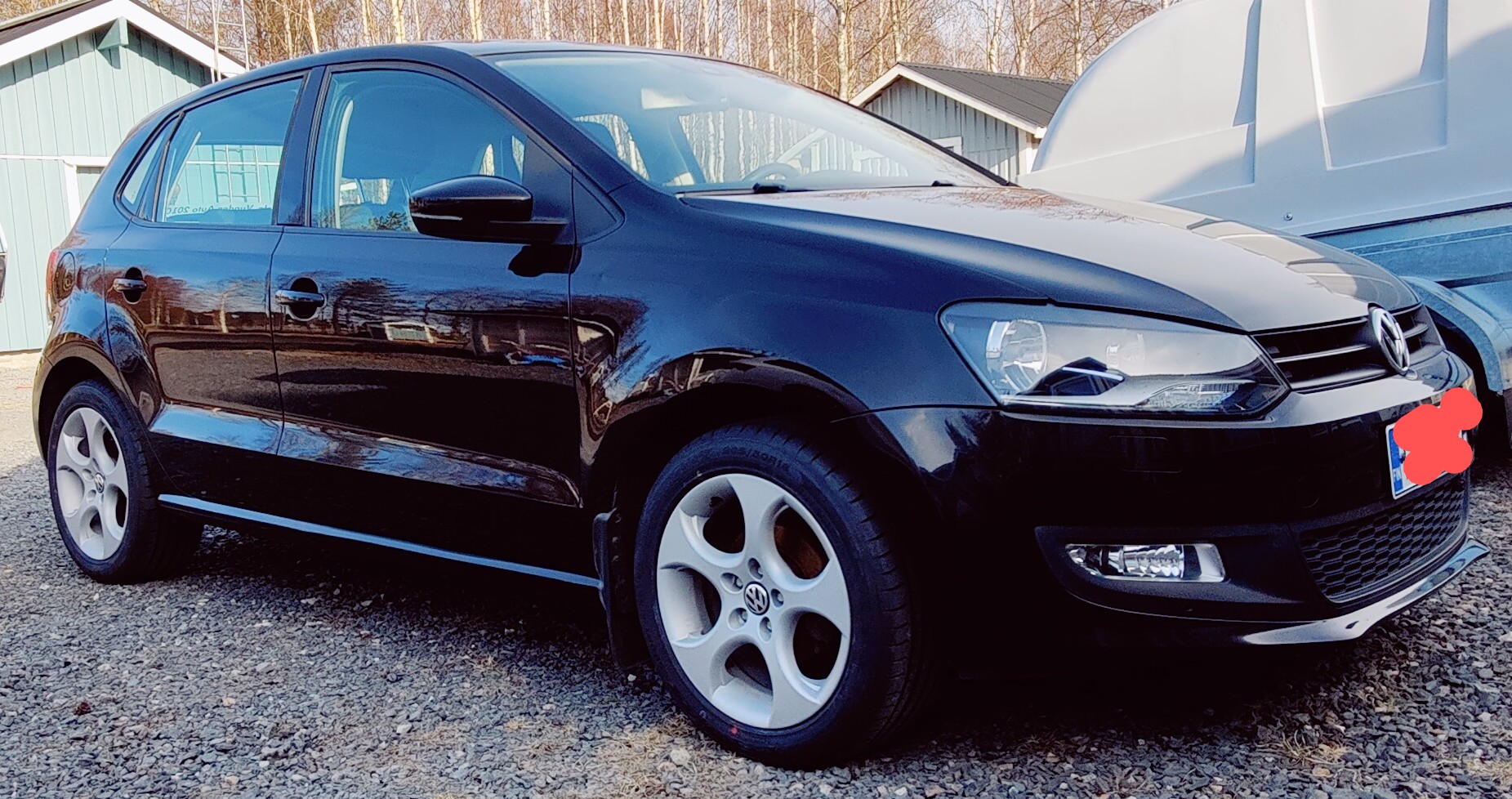

Polo after 13 years and 203000 km. It's still OK but body definitely needs some work when you look closer :) Bottom of the car is still holding up extremely well. Just the few dents, small rust and scratches that need to be repaired.
Turtle Wax Color Magic, Jet Black makes big improvement but it's only temporary until you need to wax the car again.
Looking forward to fit the R-line rear bumper.

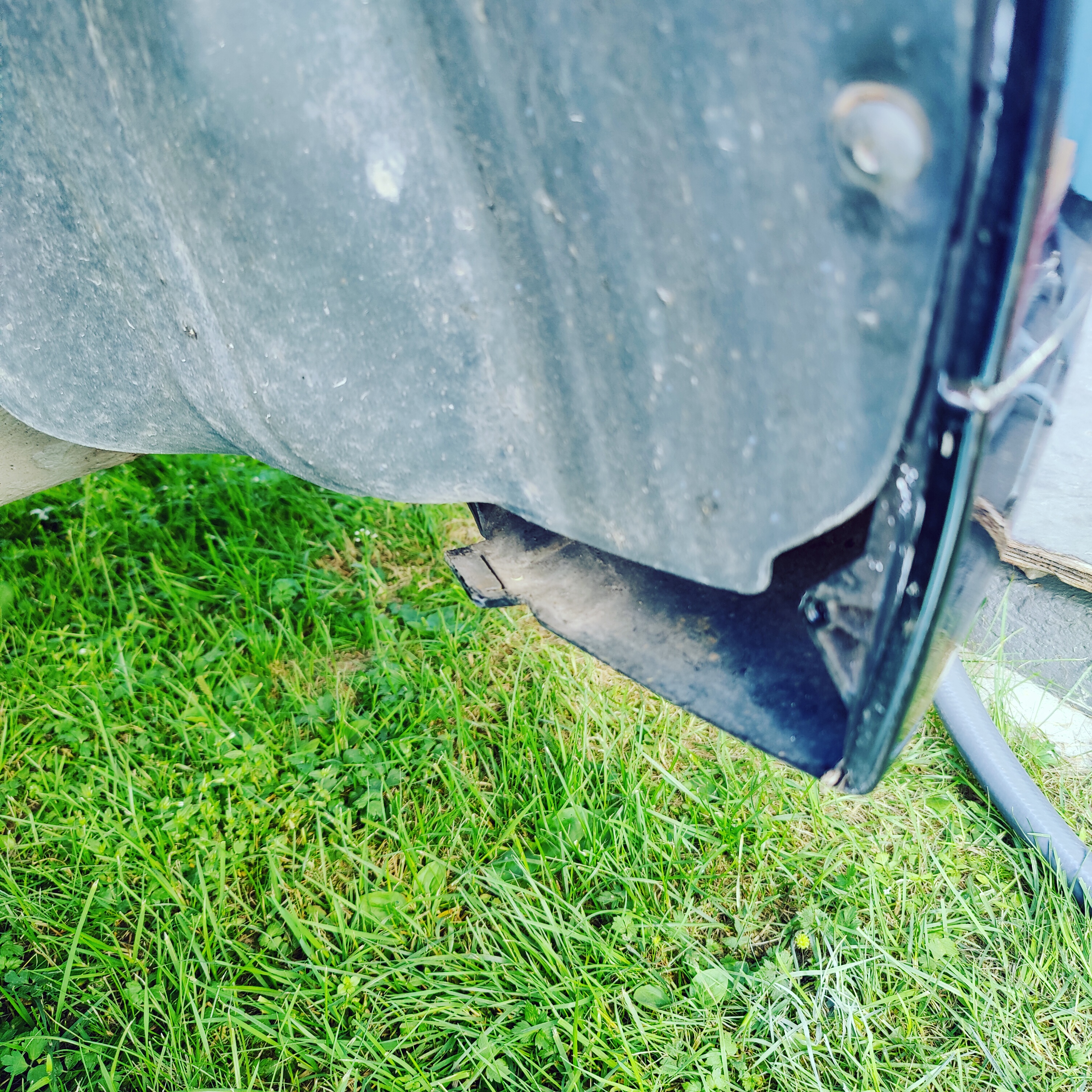

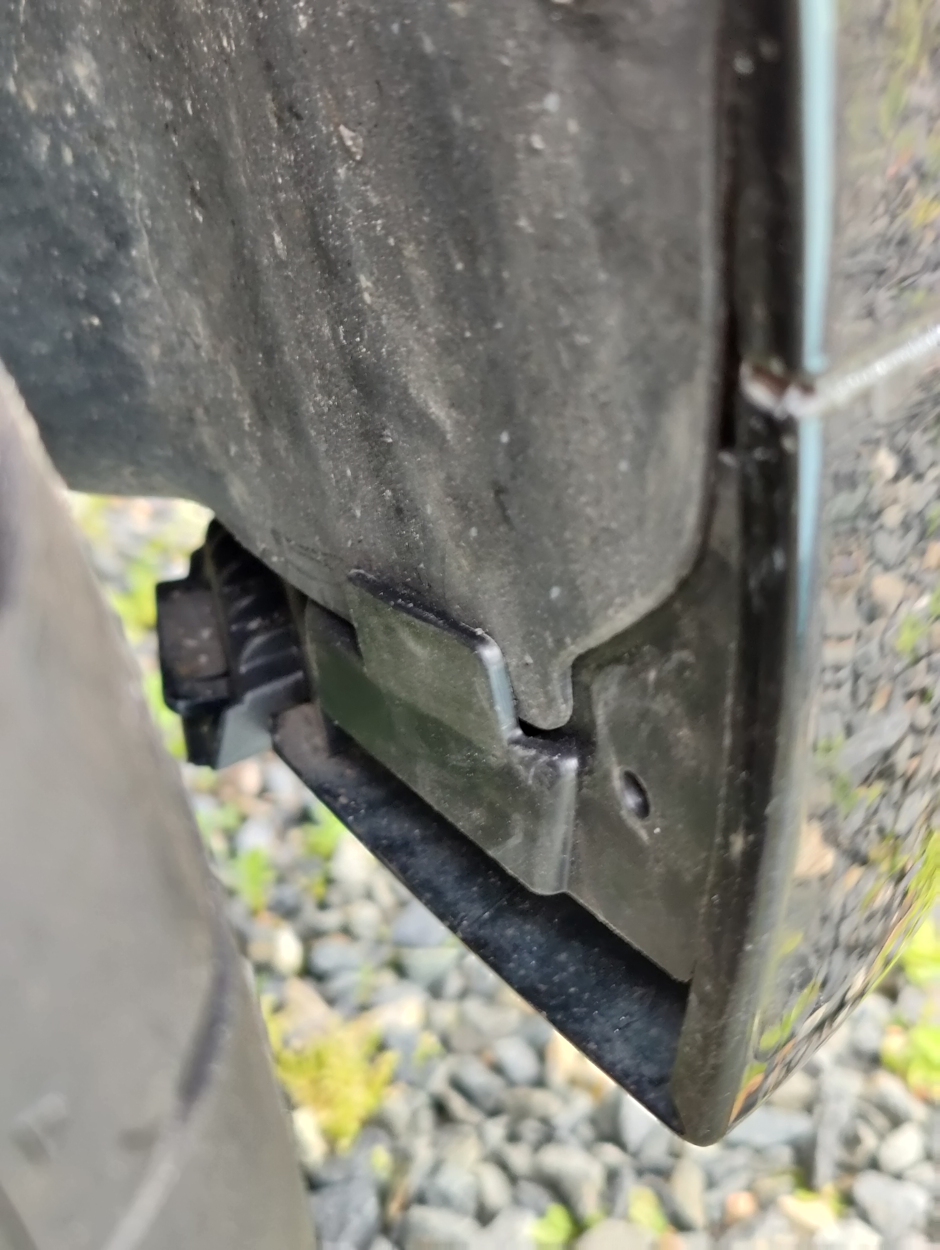

Question about another topic. So I finally fitted R-line rear bumper. It was pretty easy one man job but how have people dealt with this gap? I am thinking about mud flaps but what are the alternatives?
Edit: checked Iichels thread and maybe I need these brackets 6R6807409 + 6R6807410? Just seem that they won't fill that whole gap there?

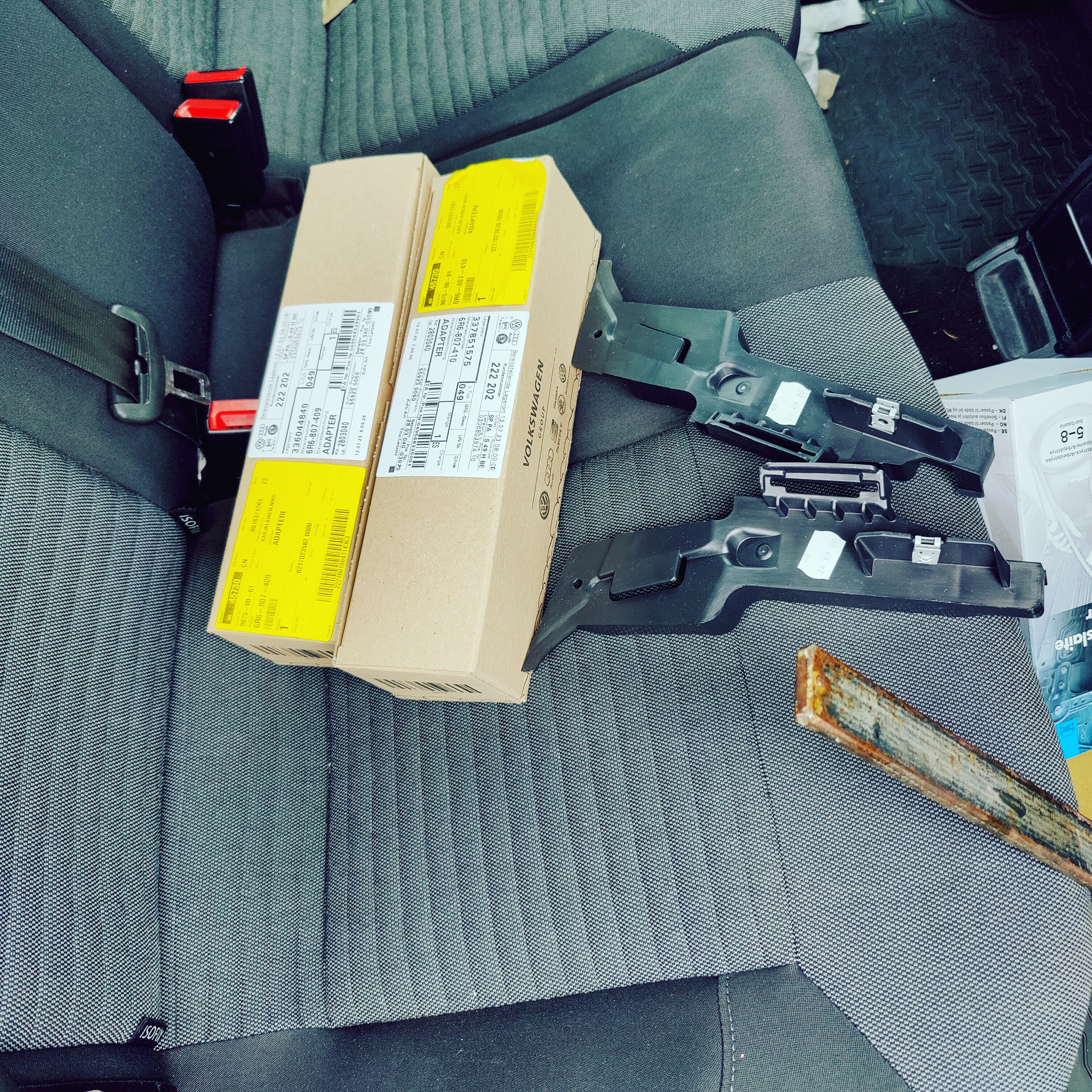

Installed R-line rear bumper adapters (6R6807409 + 6R6807410) today. As I thought they won't fill the whole gap, but that's how VW has designed it I guess. Looks much better now though and the bumper is better supported now. (Screws are missing in the photo below, it started raining) :D
