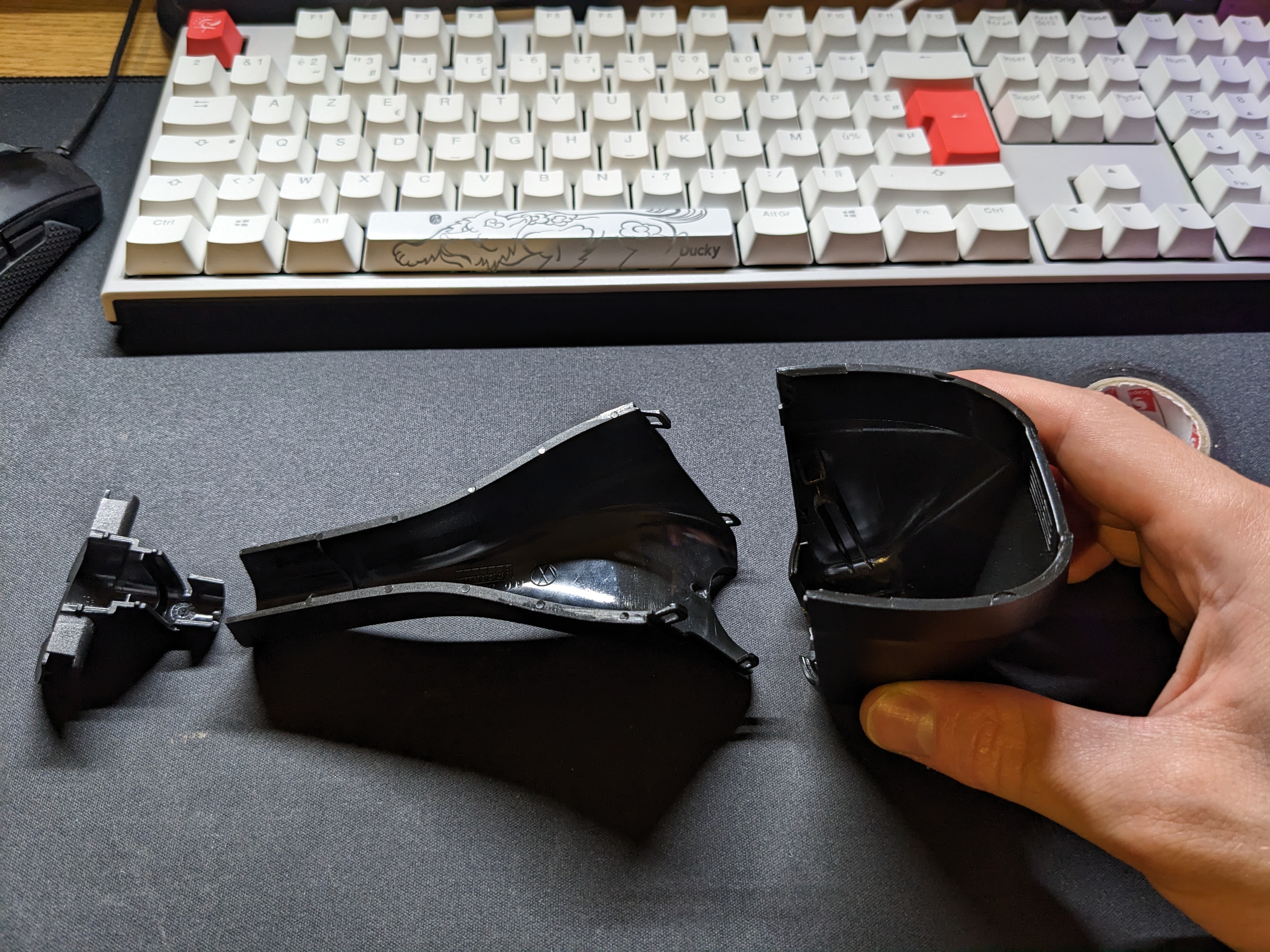

Thanks for the tips.
I broke it when I didn't have any trim tool.
Removing the part "2" from the part "4" is the easiest part.
No, the worst part is removing the part '2" from the part that is installed on the headliner (the part I broke).
Here are the parts involved:
From the left to the right
-Part attached to headlined
-Part "2"
-Part "4"

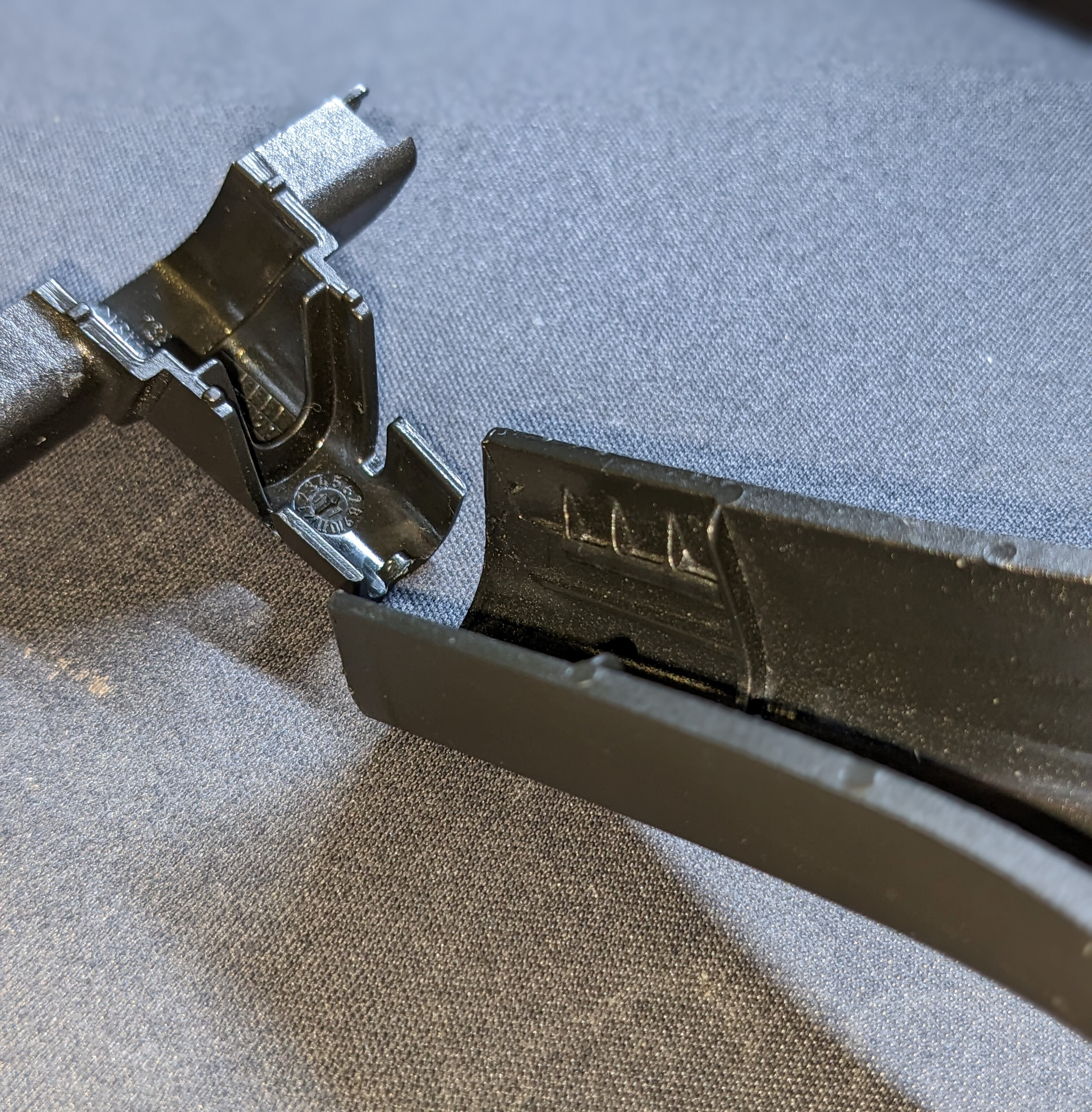

To remove part "2" I have to unclip it from the part "4" had I said before: very easy.

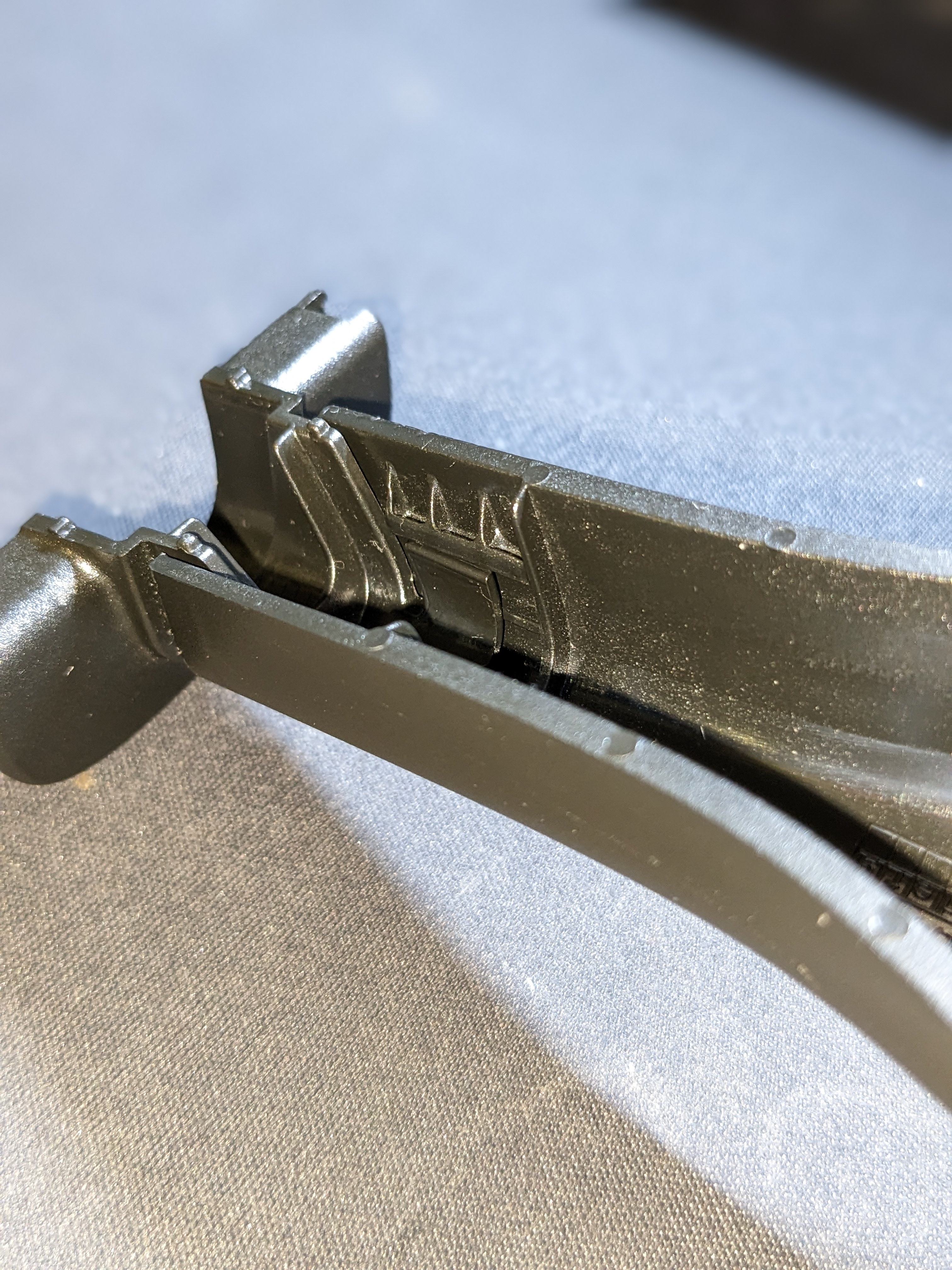

The most complicated part is here:
The part "2" is clipped to the part that is installed to headliner.
This is the worst part because the plastic used on part 2 is really, really strong. And I can't slide the part 2 out because it's to tight

Remove part 4 and rotate/turn the mirror as indicated to remove it, so you get the clearance/room you need to remove part 2.
For the broken/stuck part, if you blow hot air with a hair dryer at medium power, the broken part might slide down from the part installed on headliner. 🤷‍♂️
