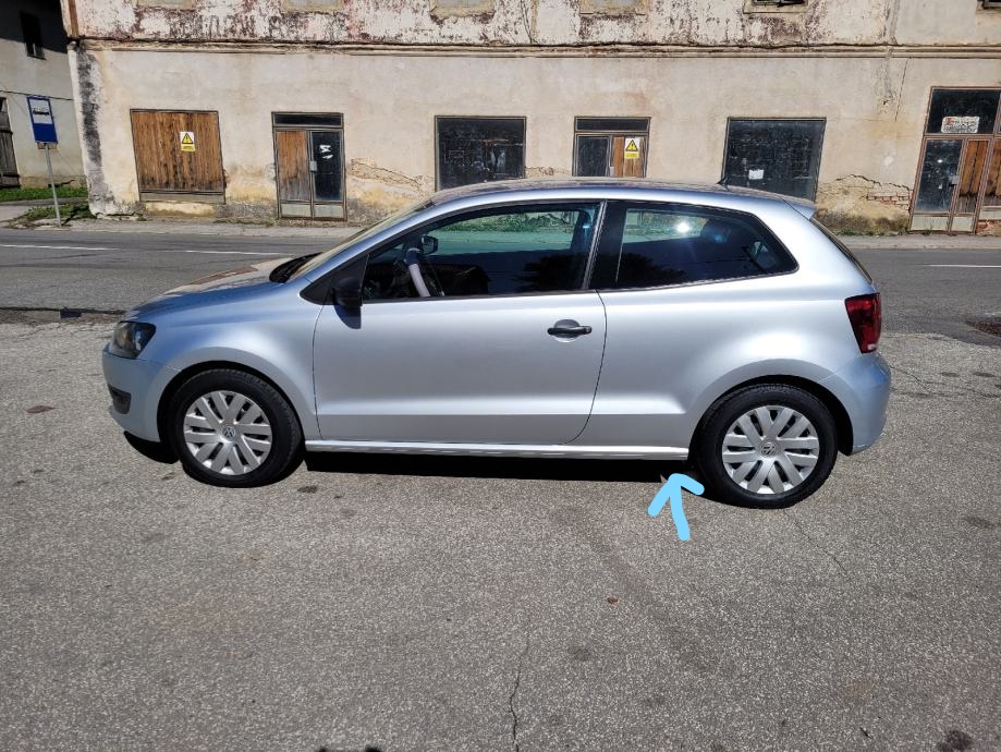

I was cleaning today my car, a bit more detailed way. And I found out something shocking. Rear wheels, when you undo the bottom tx25 bolt (the one thats under the sill) that holds the inner fender, and you move it away so you can look in rocker sill direction (bottom) it's OPEN :shock:
Does you car have some kind or grommet or am I missing one??
I was shocked, because dirt, water, salty snow slush can get and travel all down the rocker (towards the front wheels) and eat it inside out.

Guys remove this bolt, and move the inner fender towards the tire.
Get your self hand of this
and spray inside the sills. They are open, and dirt, water etc will run inside your sills. They will rot from inside
ps- if you are going to r
wash them first, open the large grommets on the front and back because it will fill up with water.

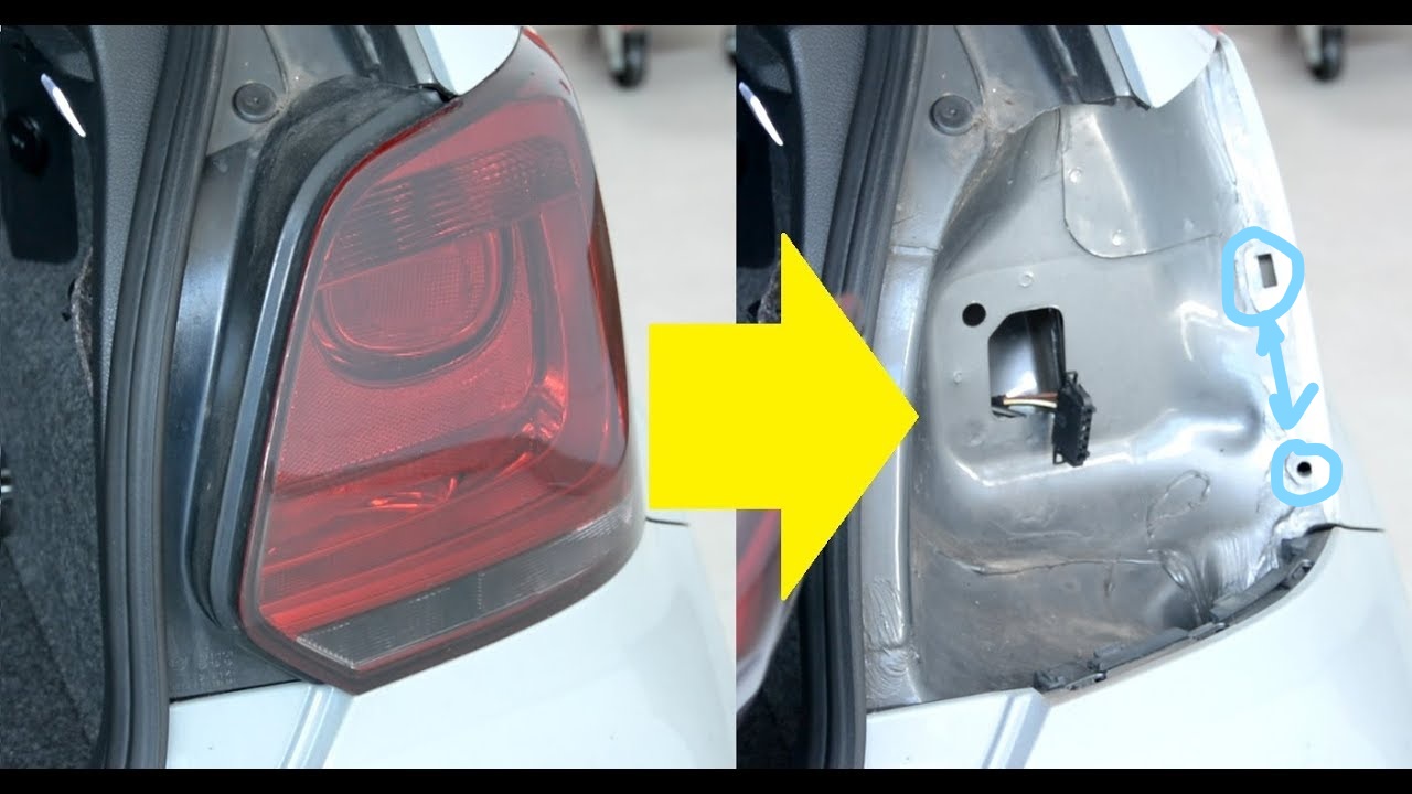

Rear arch rust prevention
spray cavity wax in those holes, easier than removing rear inner fenders, and removing the plugs at the top (12 o'clock)

Well not been near the Polo much because of some health issues but finally managed to give the car a long deserved wash. Much to my horror I've noticed a tiny rust bubble on the passenger side sill right in front of the rear arch. It looks like water has somehow crept under the seam-sealer on the rear of the sill/arch. It's only cosmetic but just really annoying. (my polo is 2011 so 12 years old now) I checked the other side and low and behold tiny bubble in exactly the same spot.... Grrr... I've had the arch liners un-screwed just to check if its more serious or a build up of muck but it's all relatively clean.
Anyways, I've washed all the back of the sill where its open and blasted it with Bilthamber clear wax. Think I'll be booking the "Chips-Away" man or similar to sort it prior to winter. Sorry can't host any images or I'd have posted some images. It's looks like a manufacturing/age issue as the seam sealer runs right to the very edge of the sill and over time the edge lifts just a tiny bit just enough to let water under. Mud flaps hide that bit of the sill at the front but I'd put money on the front edge being the same. Gonna need to check.

Be careful with how much water because it overflows to other areas outside off sill.
When I blasted water from front towards back, it filled the compartment near the rear beam ( there are rubber grommets)
Just blast wax from inside it helps a lot. I also added wax on bottom, along the edge.
I think you help your sills alot by spraying wax
