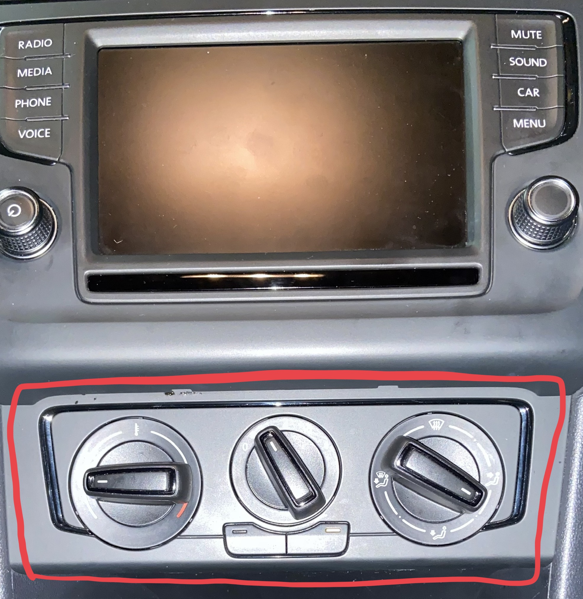

Do I have to remove the trim around the infotainment unit before removing the trim around the climate control unit in my 2016 Polo? I am trying to get rear access to the climate control buttons as they are sticking and I want to clean them or lubricate them. Could anyone provide the exact removal steps? I don’t want to damage anything.

yeah remove radio frame, remove clima frame, remove the screws that go in the bottom of your climate panel and you can take it out.
Re: Steps to remove climate control unit trim?
there is a screw underneath, but when you try to pull the unit its hard i think there are cables for the flaps.
use a search option one member described this in detail
