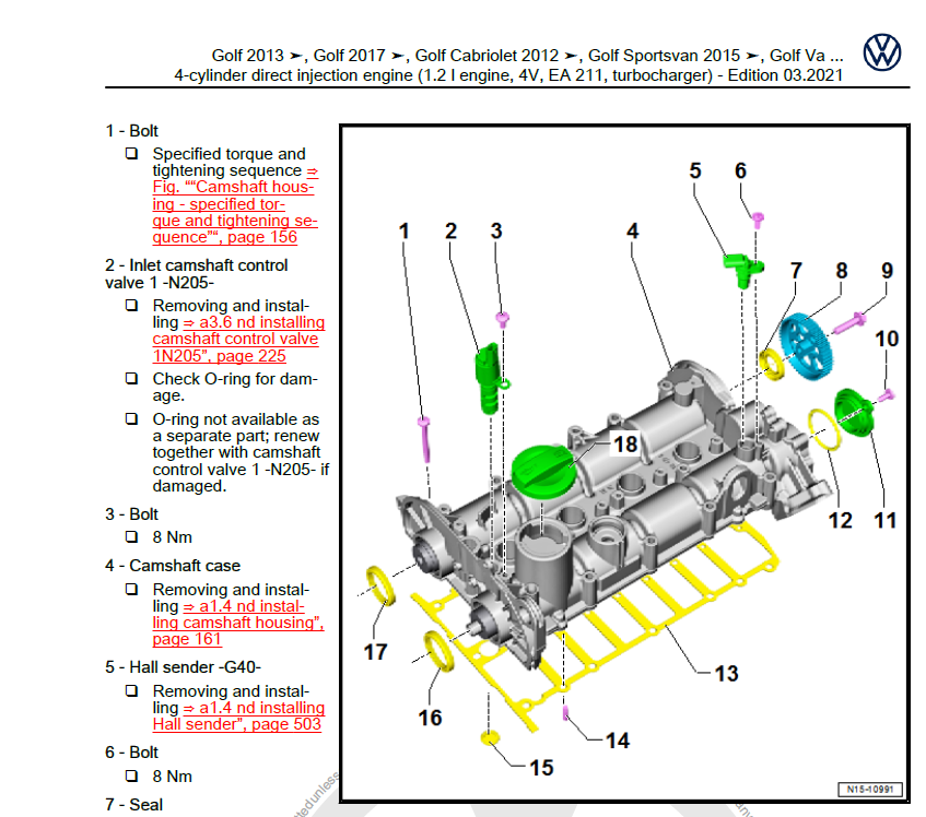

Camshaft position sensor location?
Hi, it’s my first time on here and I’m hoping to get some help if possible. I’ve got minor stuttering in first gear on low revs, Scan says mis fire 1234, so changing cam position sensor first. But I can’t locate it! if someone could tell me where I can find it, I’d be very grateful. Part number Bosch 419442210

Right there:
Item N°5
