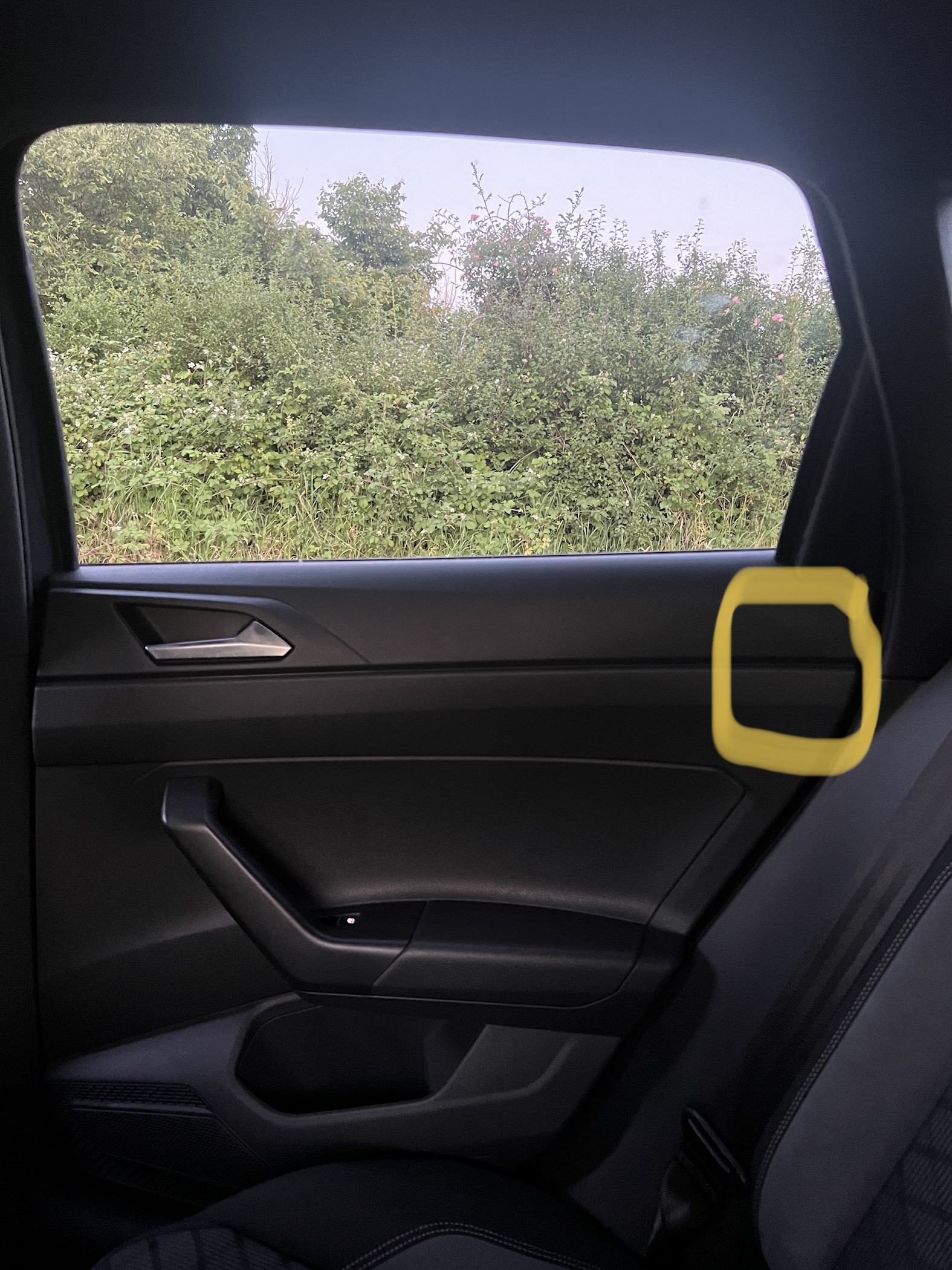

I finally cracked the code on those obnoxious vibration noises that plague my car whenever I blast some music. Turns out, the culprits are the rear door cards, specifically the side closest to the door lock mechanism. And when I lightly touch that spot on both doors, the noise stops.
You'd expect Volkswagen to have their act together when it comes to this stuff. They should've definitely thought about adding some foam or a sound deadening pad in that area to nip those vibrations in the bud. I don’t recall it ever doing it in the past, until the recent very hot weather. Maybe that’s expanded some of the plastics and they are vibrating more.
I snapped a pic to show you where these annoying noises originate from. It's right there on the rear door cards, close to the door lock mechanism. It's like they missed a vital spot that's just begging for some TLC.
VW, or any car manufacturer facing this kind of hiccup, better take note and step up their game. Throw in some foam or a sound deadening pad in that specific area, and voila! We can all enjoy a kick ass audio experience without any of those pesky vibrations ruining the vibe.
Take a look at the pic I attached It'll give you a visual on the exact spot where these infuriating vibrations and noise are driving me up the wall.

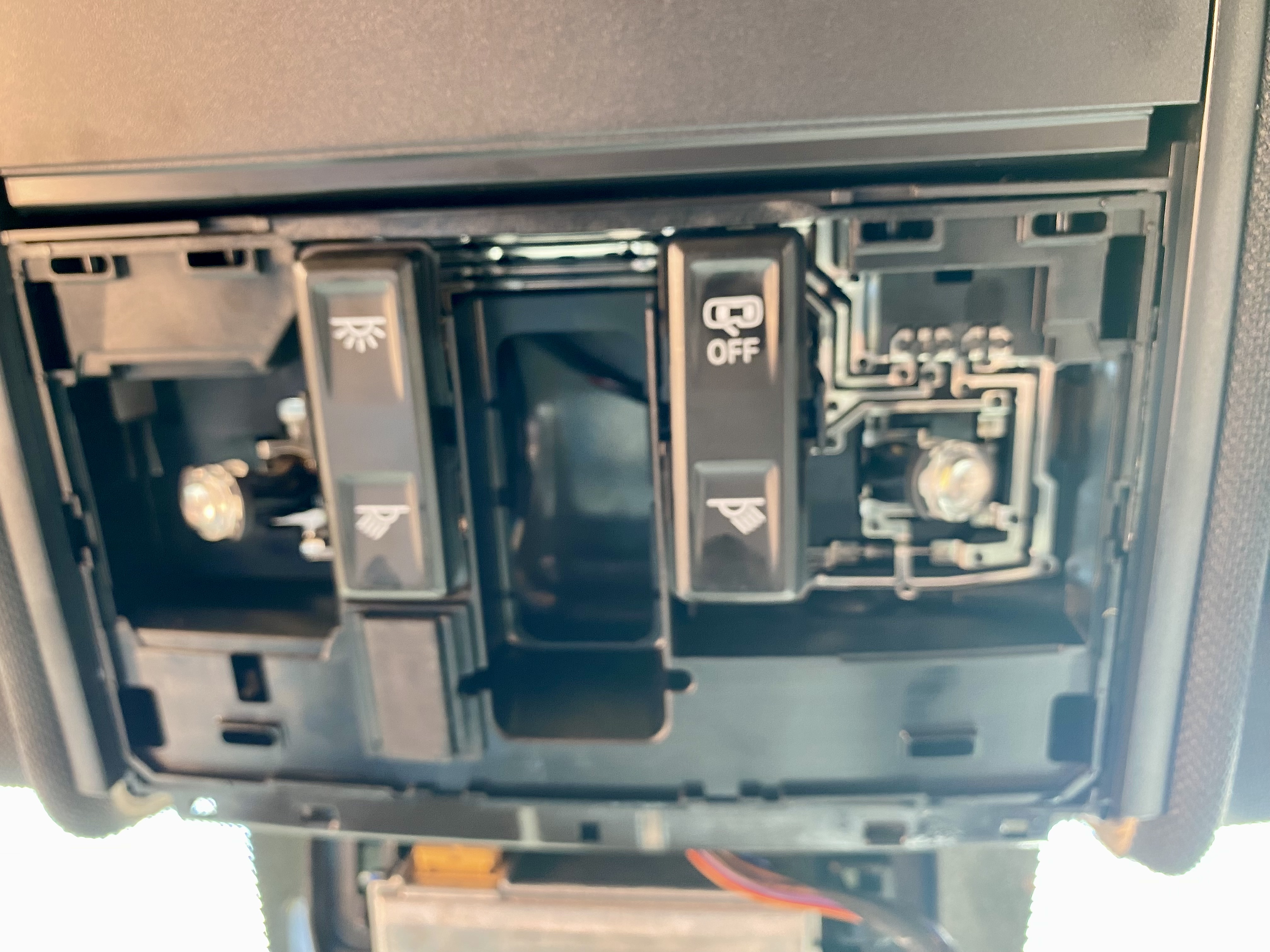

I had the rattle from above and have fixed it today, it was the reading lights, if you take the panel off you will find that the housing that the actual bulbs and switches sit in is slightly loose insode the cradle and this rattles like mad, well mine did.... I shored it up with rubber pads each side to stop it moving and no more overhead rattle ...GTIMICK wrote: Wed Jun 07, 2023 11:34 pm Hi All.

This is the bulb cradle that was rattling for me

Dealer fixed the noise which was coming from the overhead reading lights, they put in some 'Special sound proofing tape' as they called it and its now cured.

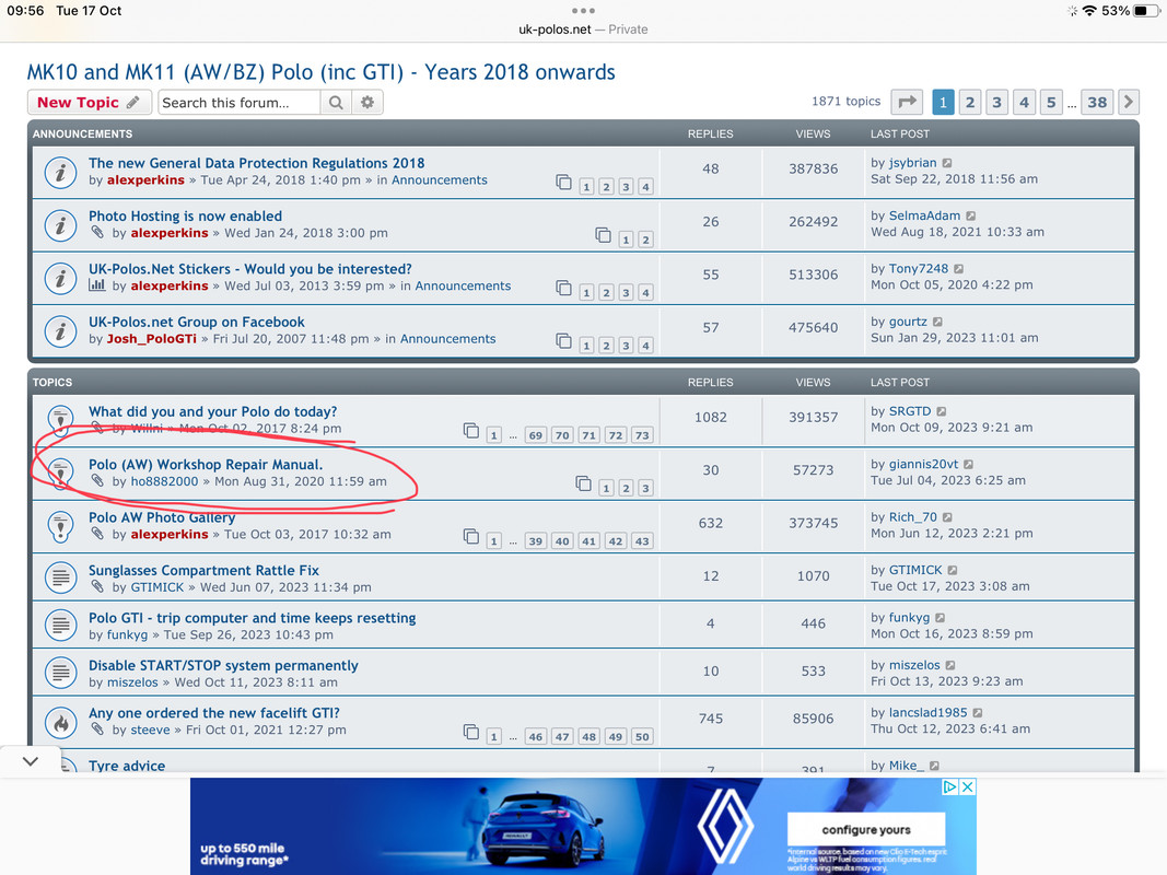

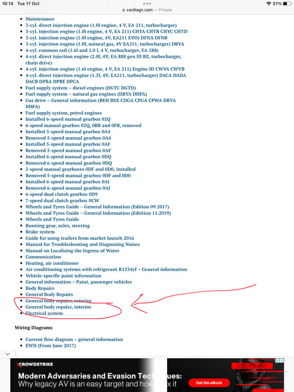

There’s a ‘sticky’ for a set of workshop manuals for the Polo; second topic from the top of the forum board for the AW/BZ Polo (see screenshoot below). The first post in that discussion thread includes a link to the workshop manuals - second from bottom of the list of manuals is the one for ‘general body repairs - interior’ and it includes a section on how to remove the centre console and centre console trim. Be aware that the manual is for the pre-facelift Polo, although I dare say the centre console in the pre- and post-facelift cars are the same.
