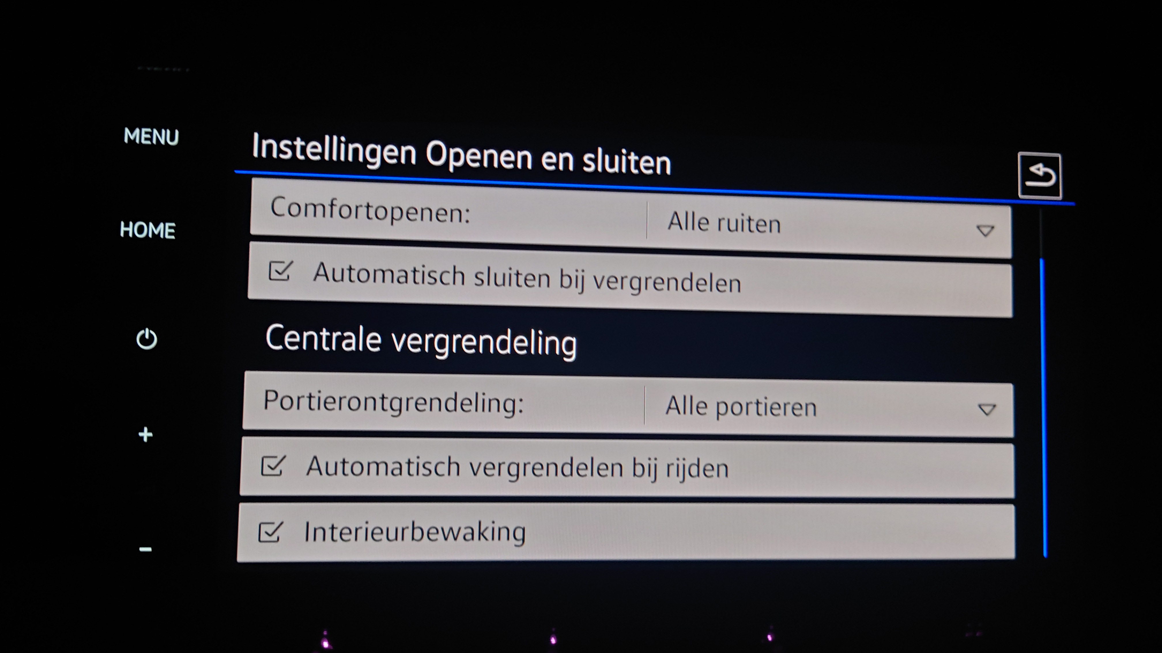

Menu->Car->Open & Close ->Automatic close

Seems the Auto locking disable/enable function is not included on a UK spec car..

Maybe via VCDS programmable?
My other option is close all windows when locking the car.
That was programmed with VCDS

I can set the option on or off and the speed at which it operates on my lowly 2019 Polo 1.o TSi via the multi display unit.. UK spec
strange to leave it off...
I guess it could be coded with VCDS or OBDEleven or similar device.. know anyone with access to one or other?
