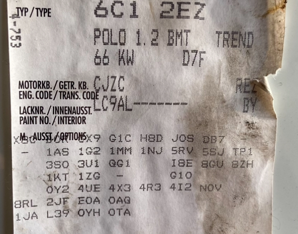

I am trying to get better at using PR codes. As 2226 mentioned, there are two versions of the fuel filters, being the 4 bar and 6.6 bar version, with part numbers 6Q0201051J (PR: IA3) and 1K0201051K (PR: IA2) respectively. I found this information from CarProg2 ETKA with the restriction of 6R-G-000 001 for my 2016 VW Polo 6C. My vehicle sticker is:
I cannot see the corresponding PR code on the vehicle sticker so how does one know that the 6.6 bar version is required?

Did you look up the part that is installed on your car?
There should be a partnr on it.

I haven’t had a look under the car yet, but was wondering how 2226 knew that the 6.6 bar version was needed for my car. I’m also wondering how to use the PR code that is from ETKA. I’m going to have a look at the filter that is currently installed tomorrow.

As far as I know, 6.6bar for the TSI.
I am running the 6.6bar on my CJZD 1.2TSI.
WK 69 - 6.6 bar:
https://catalog.mann-filter.com/EU/eng/ ... er/WK%2069
W 69/2 - 4.0 bar:
https://catalog.mann-filter.com/EU/eng/ ... /WK%2069~2
Look at the application tab and you will see that the 69/2 is for non-turbo applications, 69 is for turbo.

I see what you mean. Like you said, the Mann website does support the 6.6 bar filter for the 1.2TSI, which I have.
