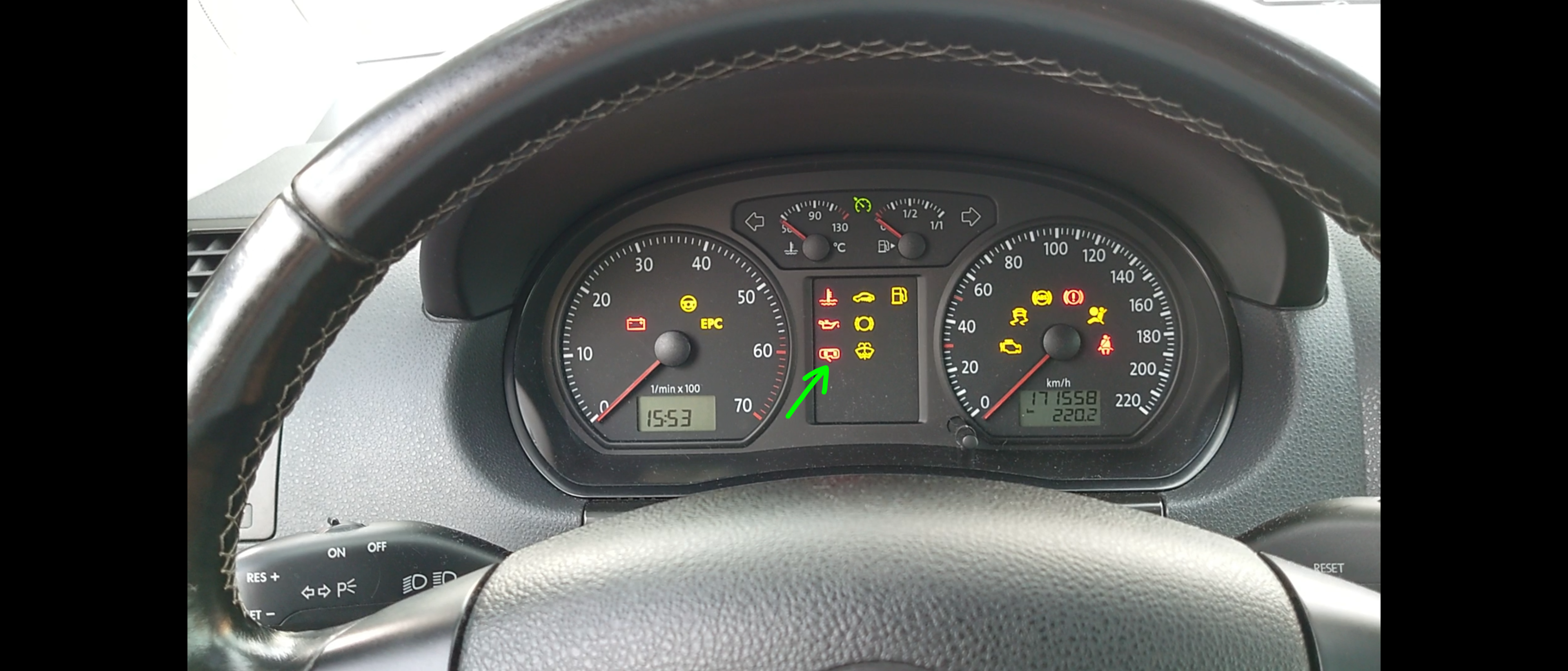

This door open symbol
Do you have factory alarm?

Maarten wrote: Fri Nov 10, 2023 5:33 pm Screenshot_20231110-185523.png
It doesn’t have that icon on the cluster.
