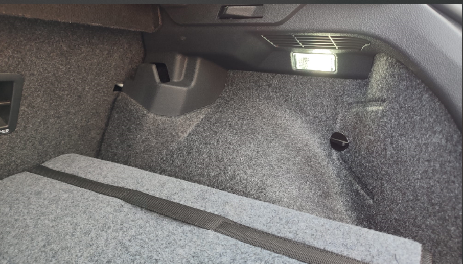

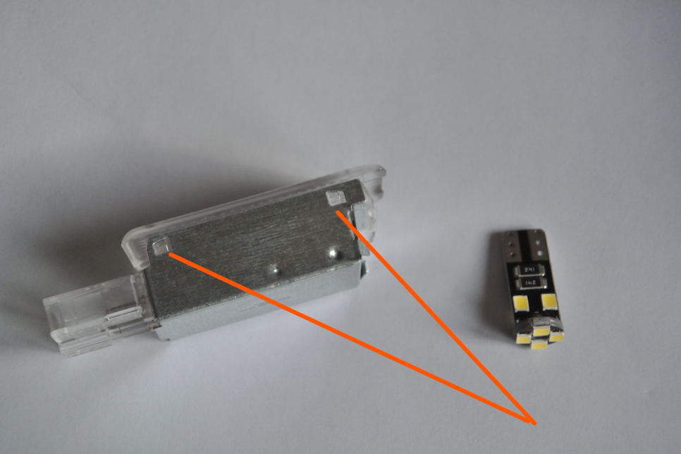

well.. the LEDs arrived labelled for each function/lamp and got it all done inc the trunk/hatch.
Not as simple as it looked... the hatch light came out easily but the bulb is not accessible without prising the metal shroud off! The metal is very thin it bends easily so be careful..
Screenshot 2023-11-14 141259.png (797.64 KiB) Viewed 2958 times
the tabs are indicated in orange in the photo and are the same the other side of the lamp.. after getting the metal free it was easy to replace the bulb.
when fitted and tested..trunk/hatch light..

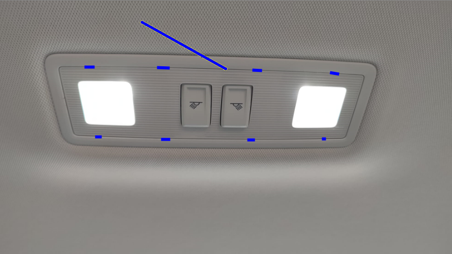

The rear dome light was similarly awkward to get at..
There are tabs approximately near the marked blue lines.. you need a very thin screwdriver blade to get into the trim.. marked by a long blue line.. once you have an entry point you need a plastic trim lever to open it up... The bulbs were quite recessed inside and hard to pull out and I have thin fingers!!!!

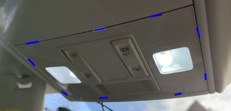

The front lights were not easy to get at either... the beige trim was supposed to come of but in the end the backing came off with it!... see video above in the threads for this but you start by prising in the blue line areas)

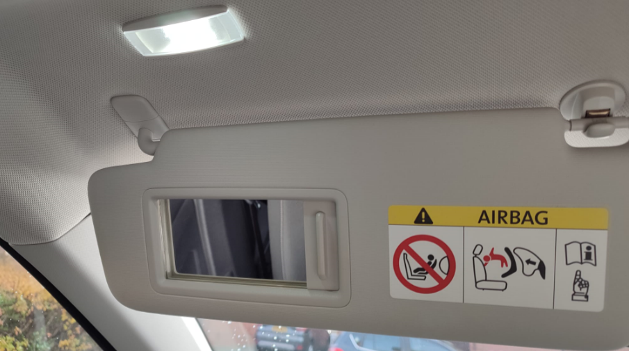

vanity lights were a breeze.. pull out with a fingernail... and replace with a festoon type LED

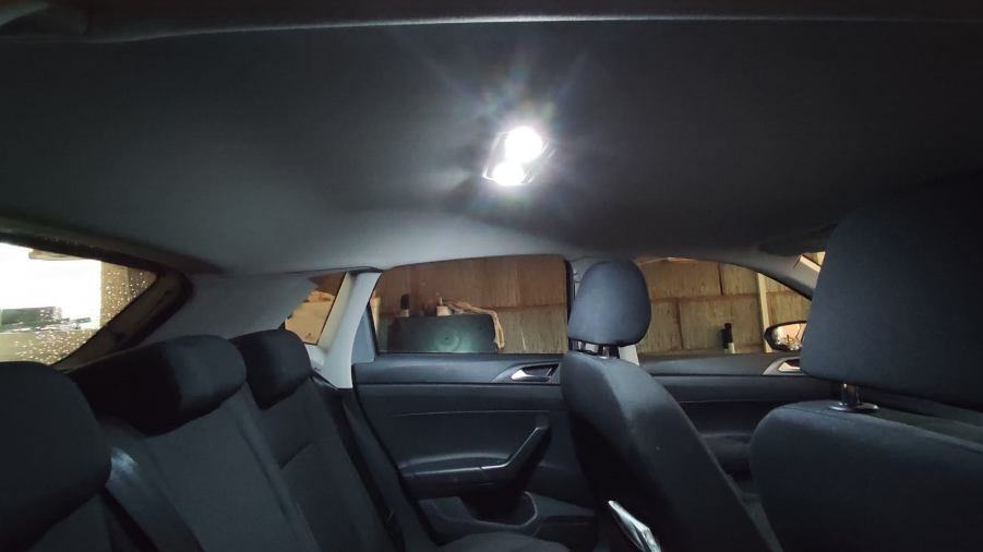

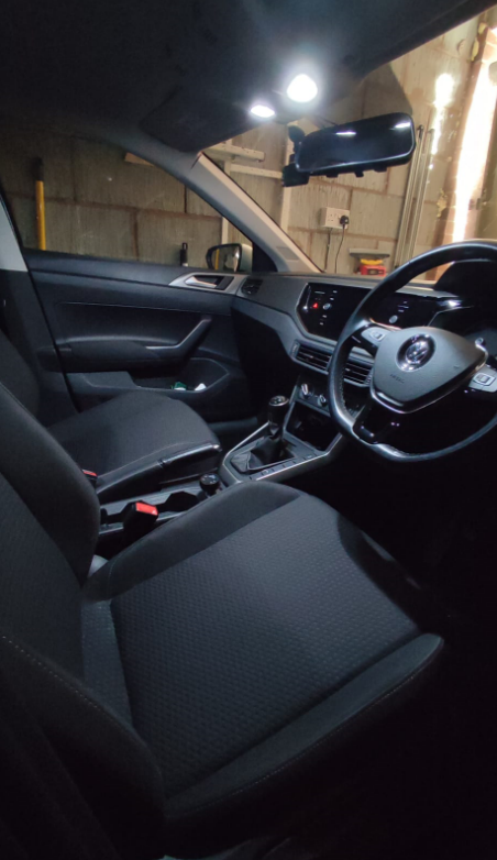

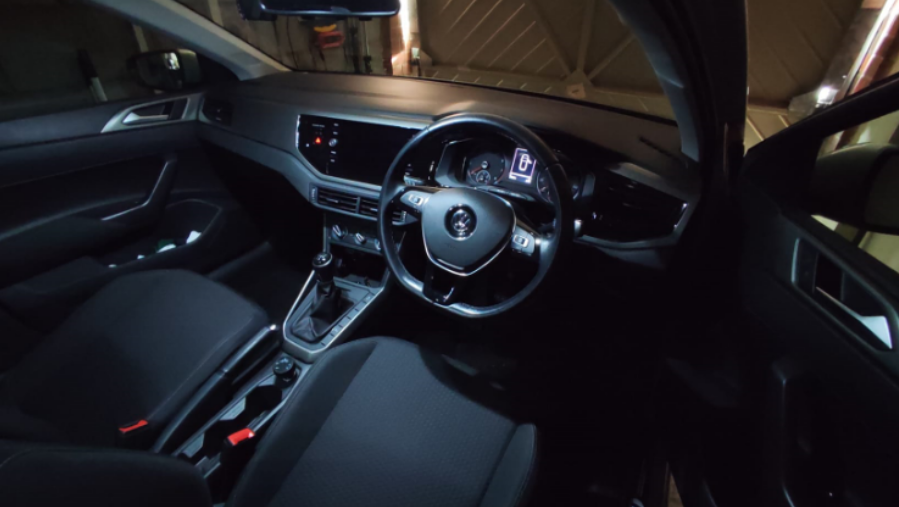

I put the car in the garage and took a few shots of the interior and is a good representation of the ambience..
Screenshot 2023-11-14 140909.png (451.57 KiB) Viewed 2958 times
Screenshot 2023-11-14 140845.png (365.67 KiB) Viewed 2958 times
Screenshot 2023-11-14 140823.png (411.67 KiB) Viewed 2958 times
I have to admit the results are very good... little to no heat compared to the Tungsten bulbs (the vanity light used to get VERY warm!..
Someone mentioned in a thread that they wished the lights faded like tungsten bulbs... but there is some fading on mine they don't just come on and go off in a millisecond.
No errors expected or received on the dashboard.
