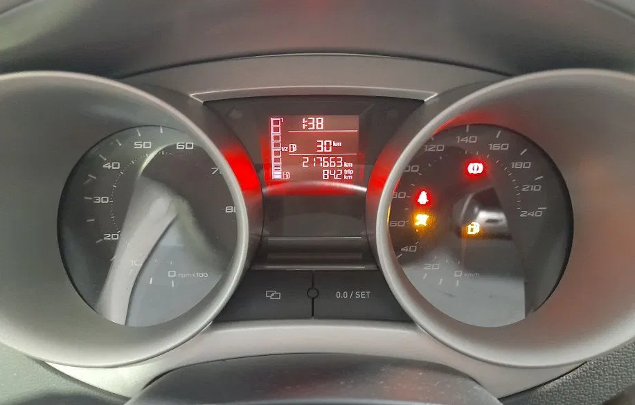

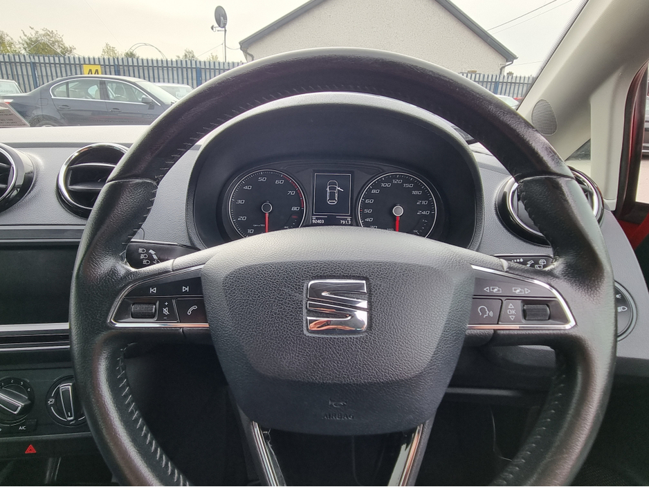

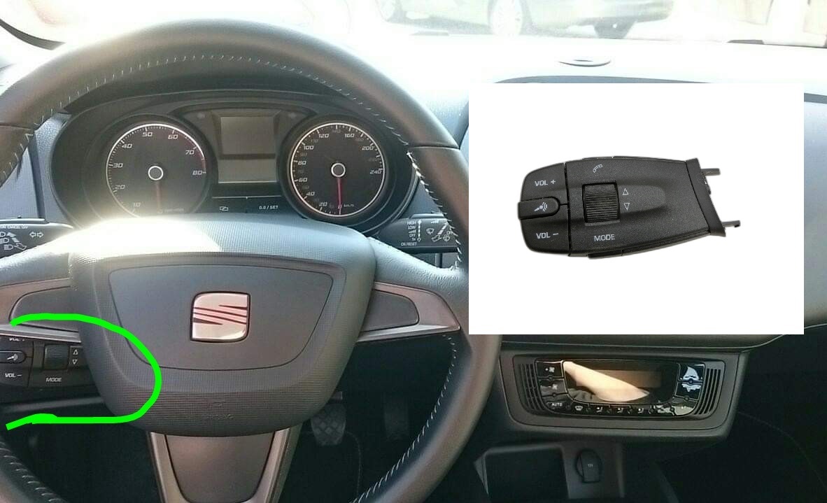

Only concern that I have it's how good will the new MFSW buttons correspond/transfer to the 2011 Ibiza 6j... please if you have some input on this:
My style of MFA (dumb) with no submenus/selections:
MFA+ from the 2016 Ibiza:
Not to forget the old command stalk corresponding to the left part of the new steering wheel:

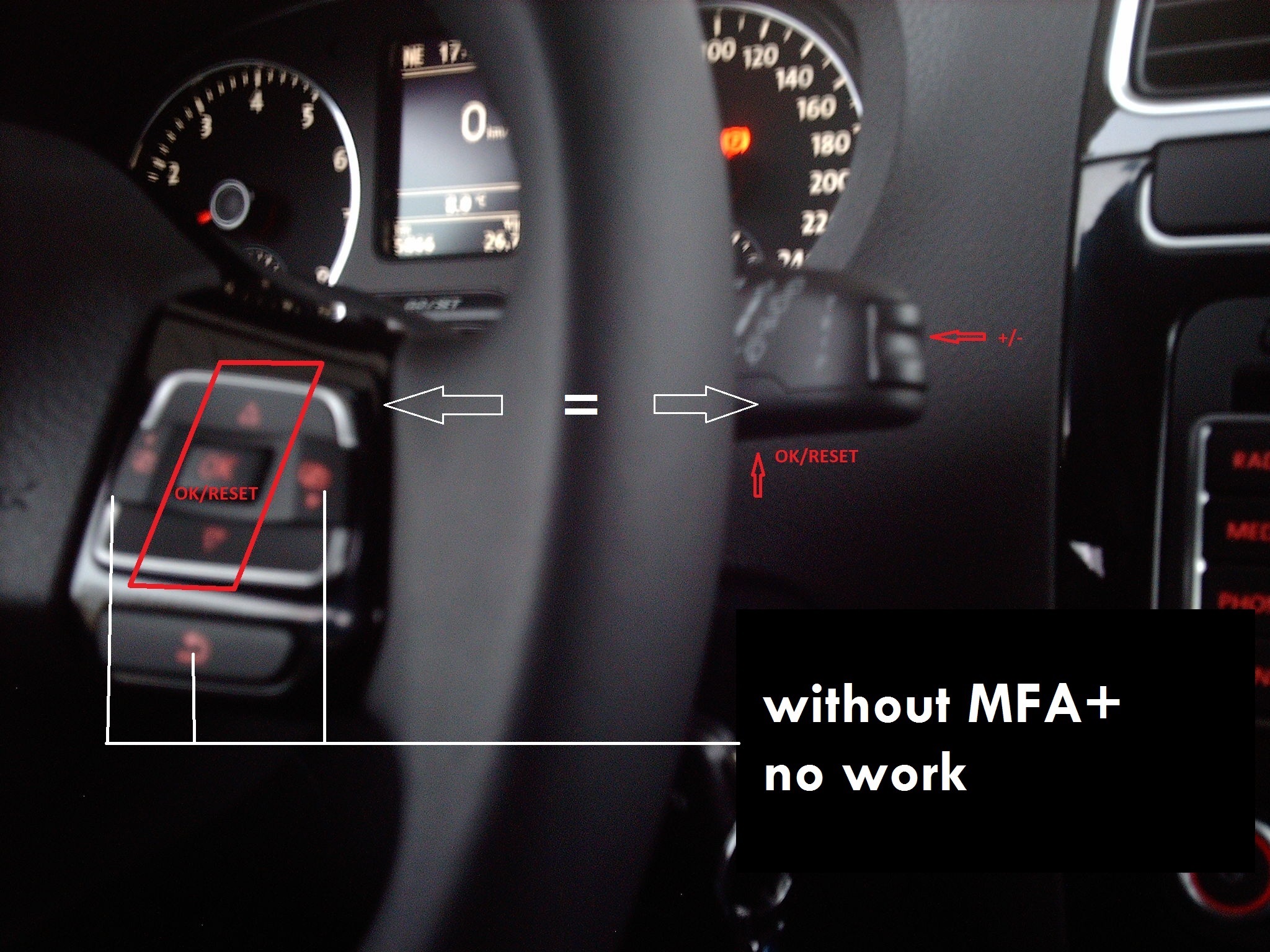

I found this from an old post of yours that you pointed out that on Polo without a MFA+, some of the buttons will not work (probably same on Ibiza):

I assume/think that you will not lose any current functions, although without MFA+ you will be missing the menus that MFA+ has.
