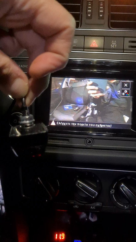

Re: Polo 6c Composition touch possible rear camera retrofit
The engine was running when i tried this.iichel wrote: Mon Dec 11, 2023 10:14 pm are you trying with engine on or off? does it make a difference?
can you make an adapmap of 5f please?
I will post the adaptation map to 2 separate posts because it is too big to fit to only one post.
I am starting from this post

giannis20vt
- Posts: 425
- Location: Greece
update:
I connected the camera to constant 12V power and test it with the infotainment system.
Works fine !!!
So the only coding needed is the Byte19-bit4 from 0 to 1. (rear view low activated)
Now when i put the reverse gear i can see the view from the camera in the screen. Super. When I shift from reverse to another gear the screen still shows the view from the camera for another 2 or 2 seconds.
This is nice. But I wonder: If by pulling out the reverse gear the camera doesn't get power, the screen will show blank for those 2 to 3 seconds. Is there a need for a device that supplies the camera with power for a little while longer?
Something like that:
Works fine !!!
