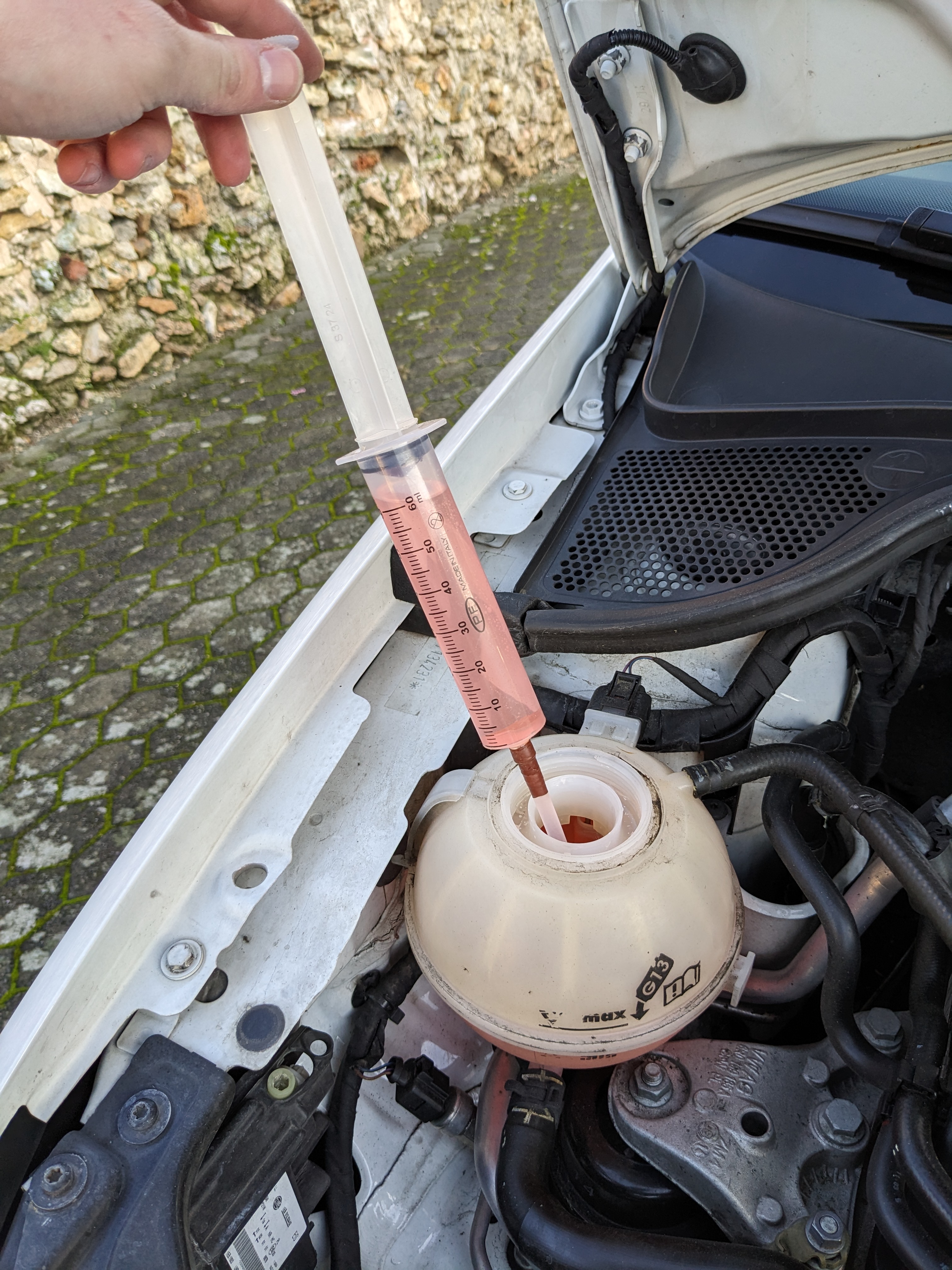

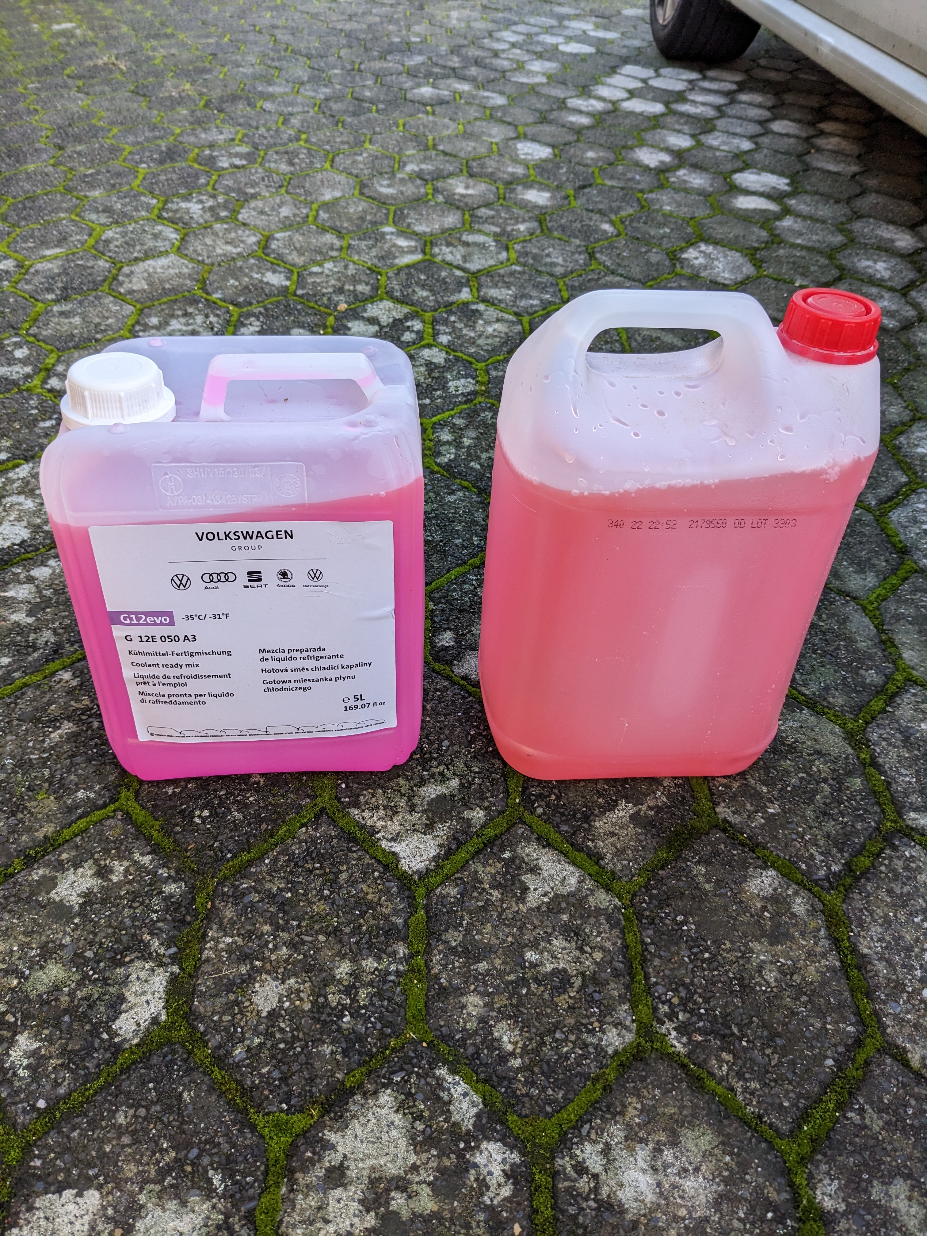

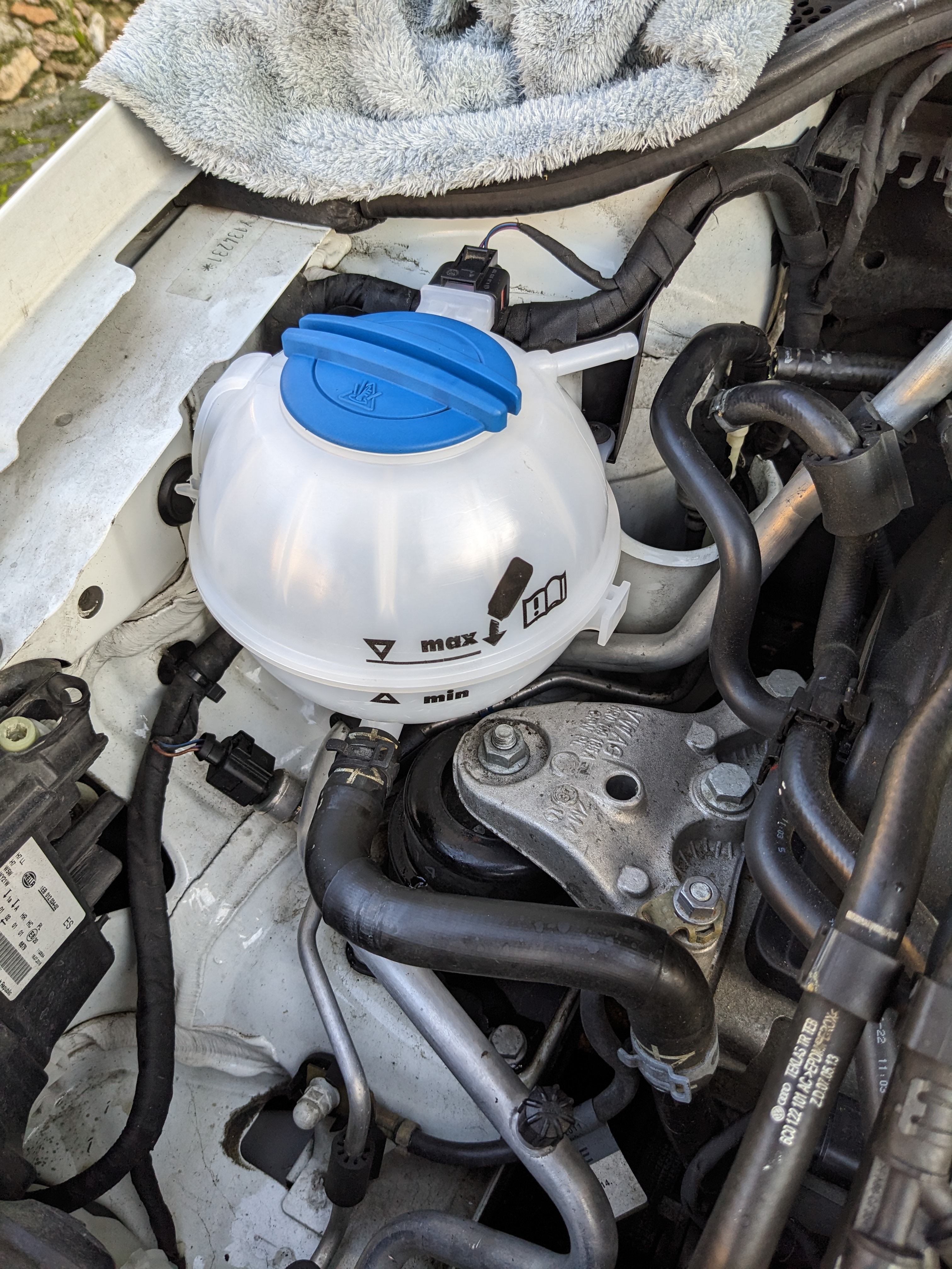

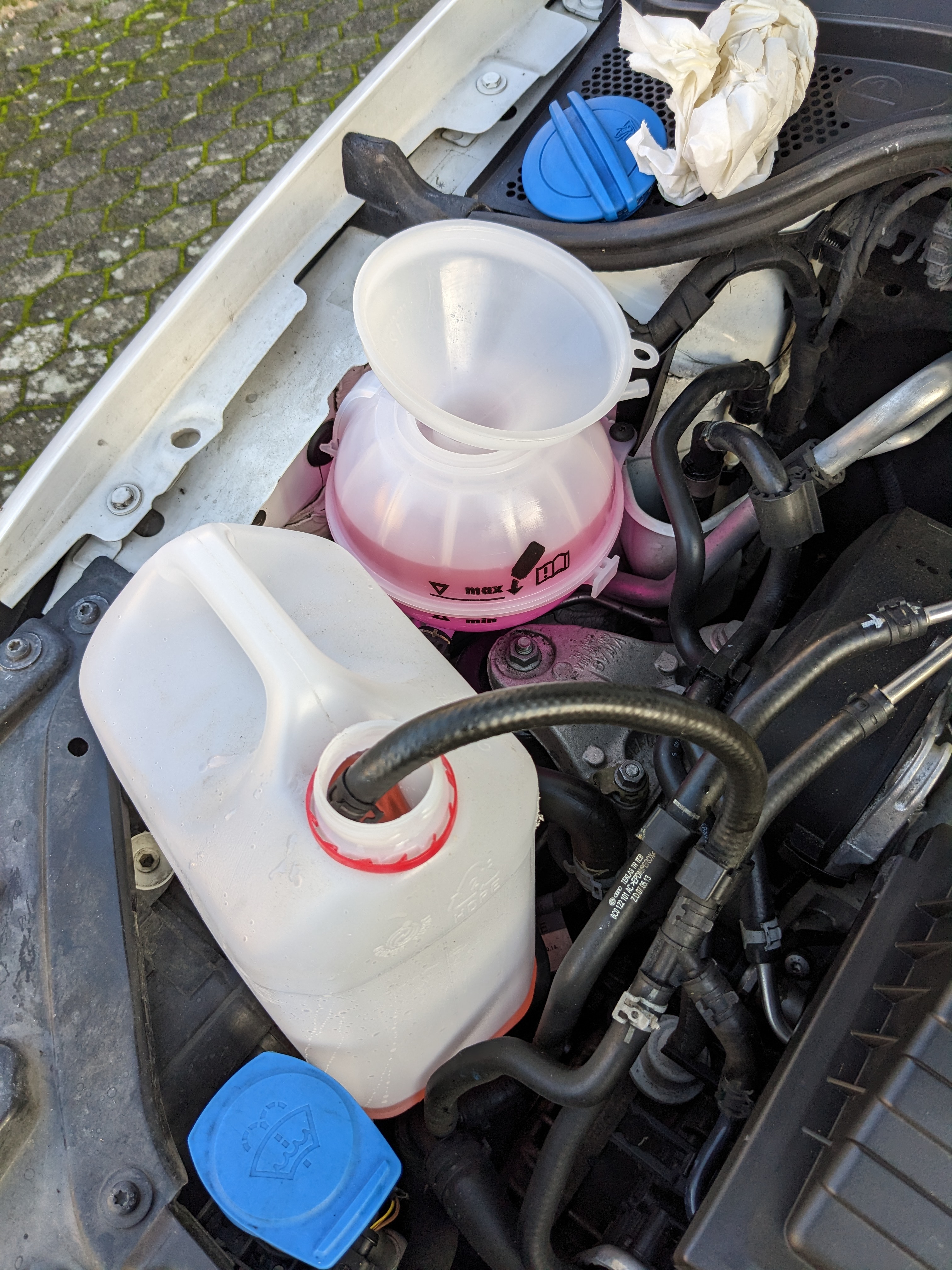

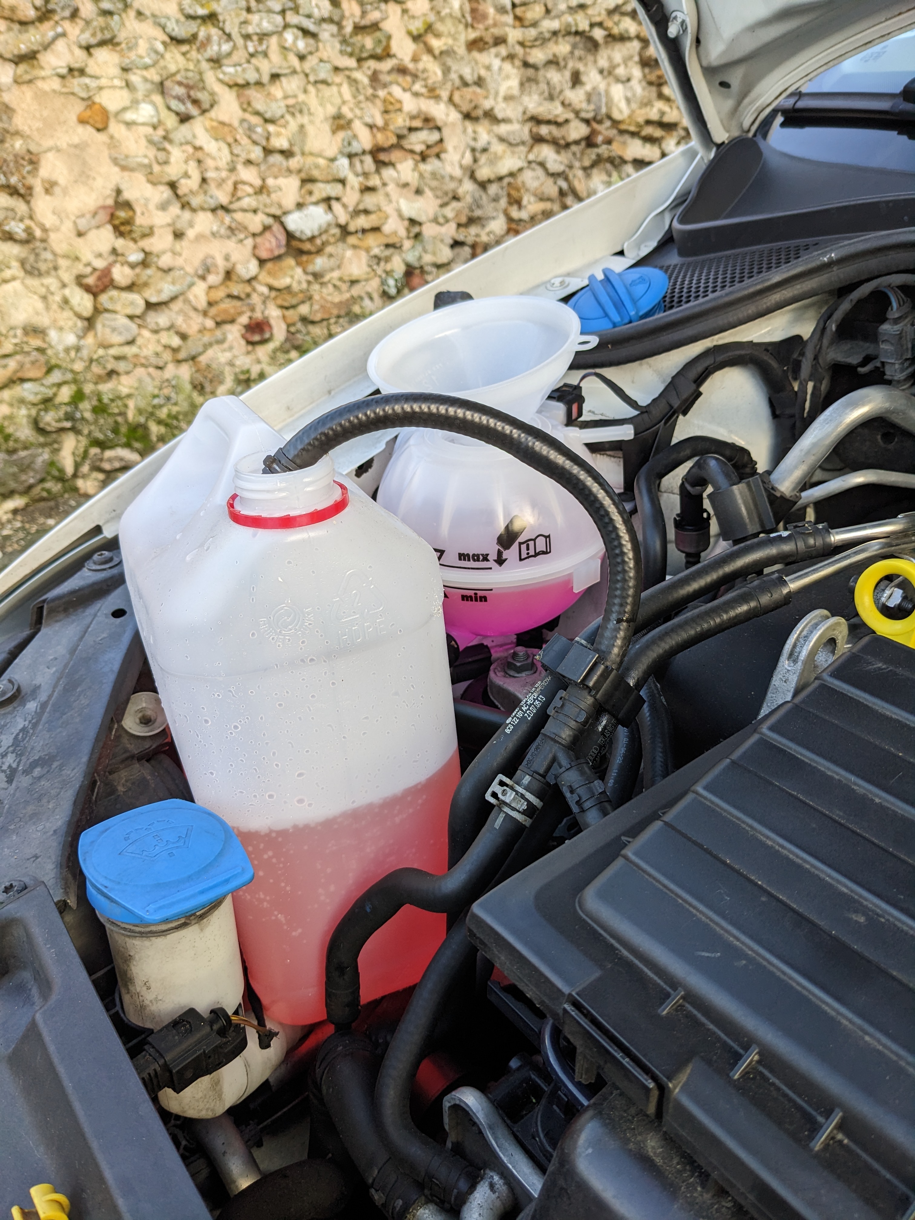

To be honest, you don't really need about tool to vacuum the coolant system.
Here's what I did:
-Empty the coolant expansion tank
-Fill it with G12evo.
-Start engine idle
-Because of engine running, you have to fill the coolant expansion to keep level above minimum
-Wait until water temp reach 90°
-switch on heating system to max temp and wait until color inside the expansion tank is the same as the G12evo.

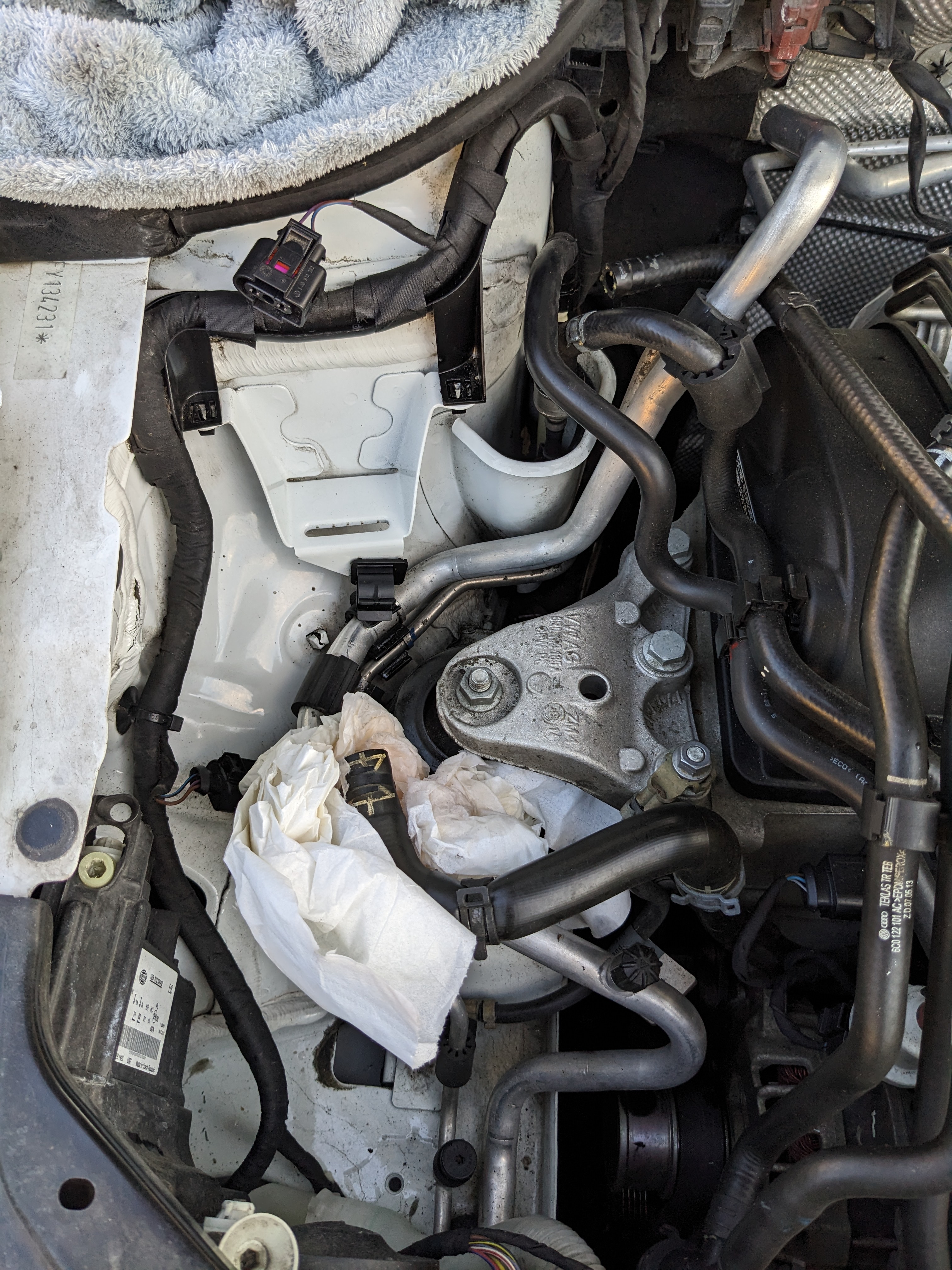

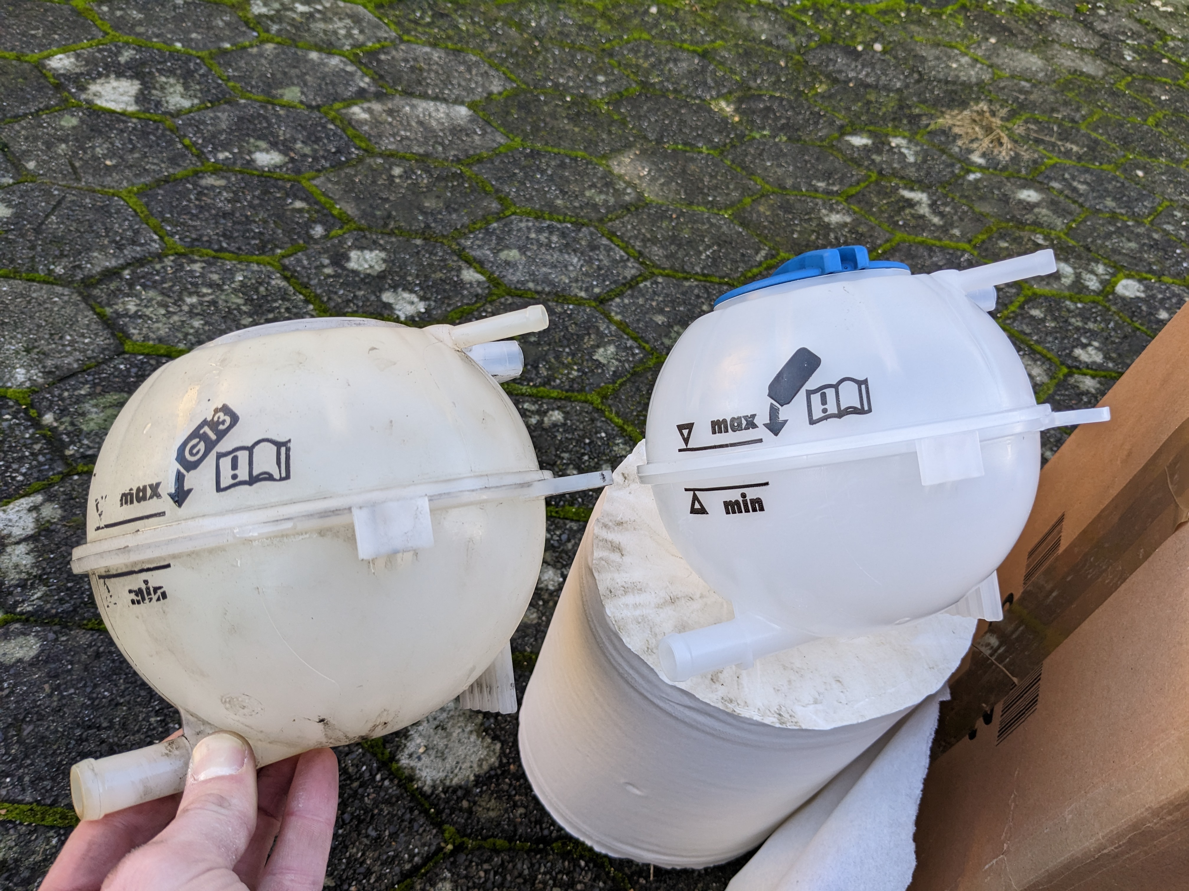

Could someone tell me the inner diameter of that pipe ?
I want to buy something to connect in it for the refilling process.
Le_Combattant i hijacked you picture. If there is any problem please tell me to delete it immediately.
Posts: 9037
Re: Refilling coolant system with vacuum kit

giannis20vt wrote: Sat Dec 16, 2023 1:02 pm Could someone tell me the inner diameter of that pipe ?
I will send you in jail for that !
Ahaha I'm joking man, be free. But IDK why, picture doesn't show up.
giannis20vt
Posts: 425
Location: Greece
Post by giannis20vt »
ciclo wrote: Sat Dec 16, 2023 6:30 pm Maybe it's 6.3mm (new unused coolant hose). https://www.oemvwshop.com/6c0121447-coo ... e-p313874/
🤔... :arrow: viewtopic.php?p=598431#p598431
This is the information i want, thanks.
So i need a coupling with 8mm Outer Diameter.
