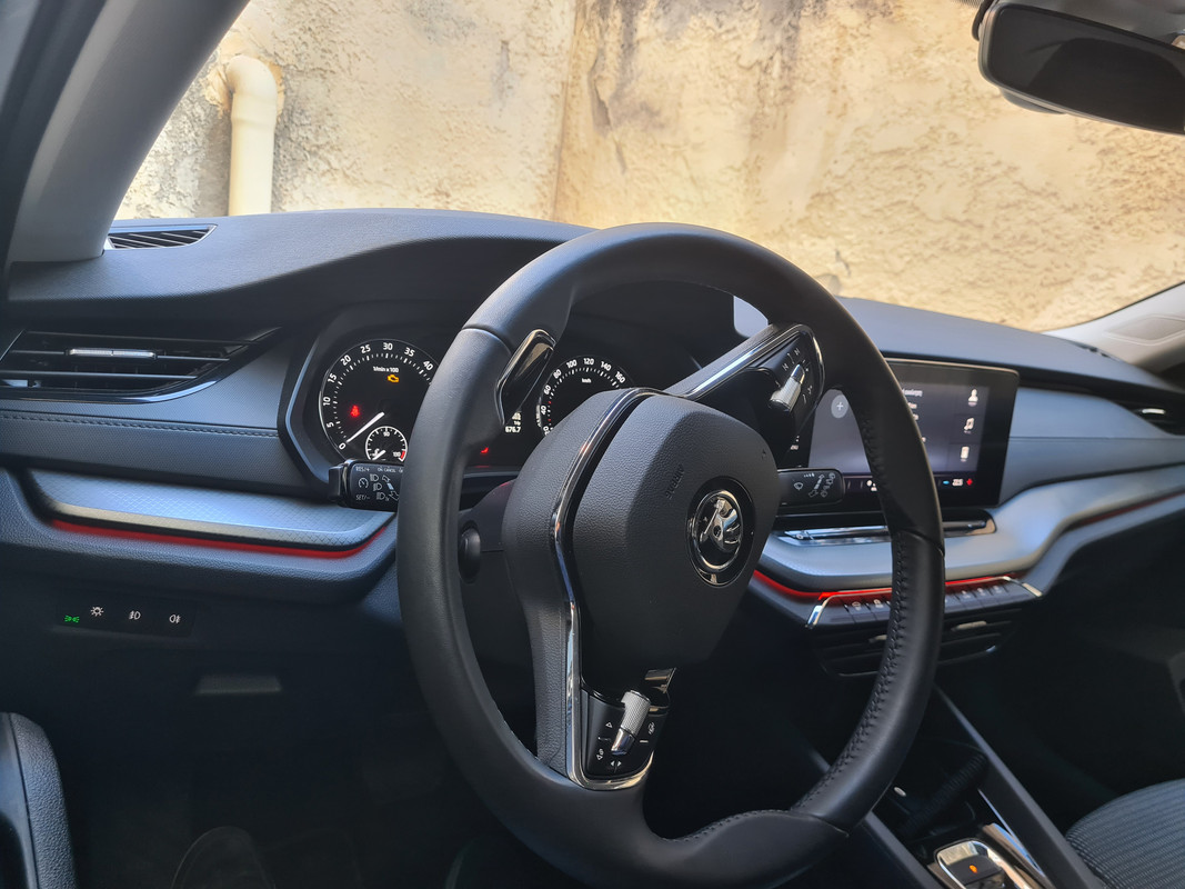

I removed the dash trim inserts (very easily, without any tools, just with hands)
This is the small dash decor insert. At the inner side has enough space for the OEM lights, so there isn't any problem with the LED strips to fit.

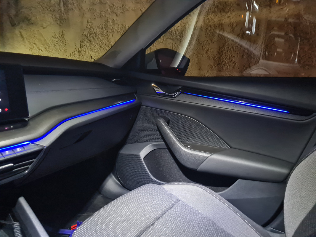

I cut a LED strip and attached it with VHB 3M double sided tape. This is the result
I did the same with the other (bigger) one.

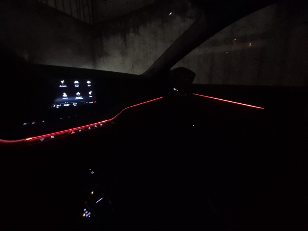

I route the wires for the LED strips though the dash and...
...ready for the final test.
