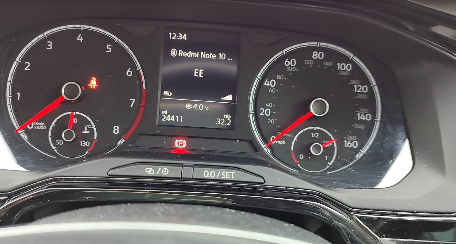

this past few days on getting into the car i get a display on the instrument pod.. looking for my phone model when connected I get this; I have never seen this screen before! and now it starts up in this screen every time I put the ignition on.
Screenshot 2024-01-10 125740.png (1.23 MiB) Viewed 1990 times
It was annoying because I didn't want that displayed at all.. i even accidentally got the phone calling someone as i was trying buttons to get rid of the screen .. LOL

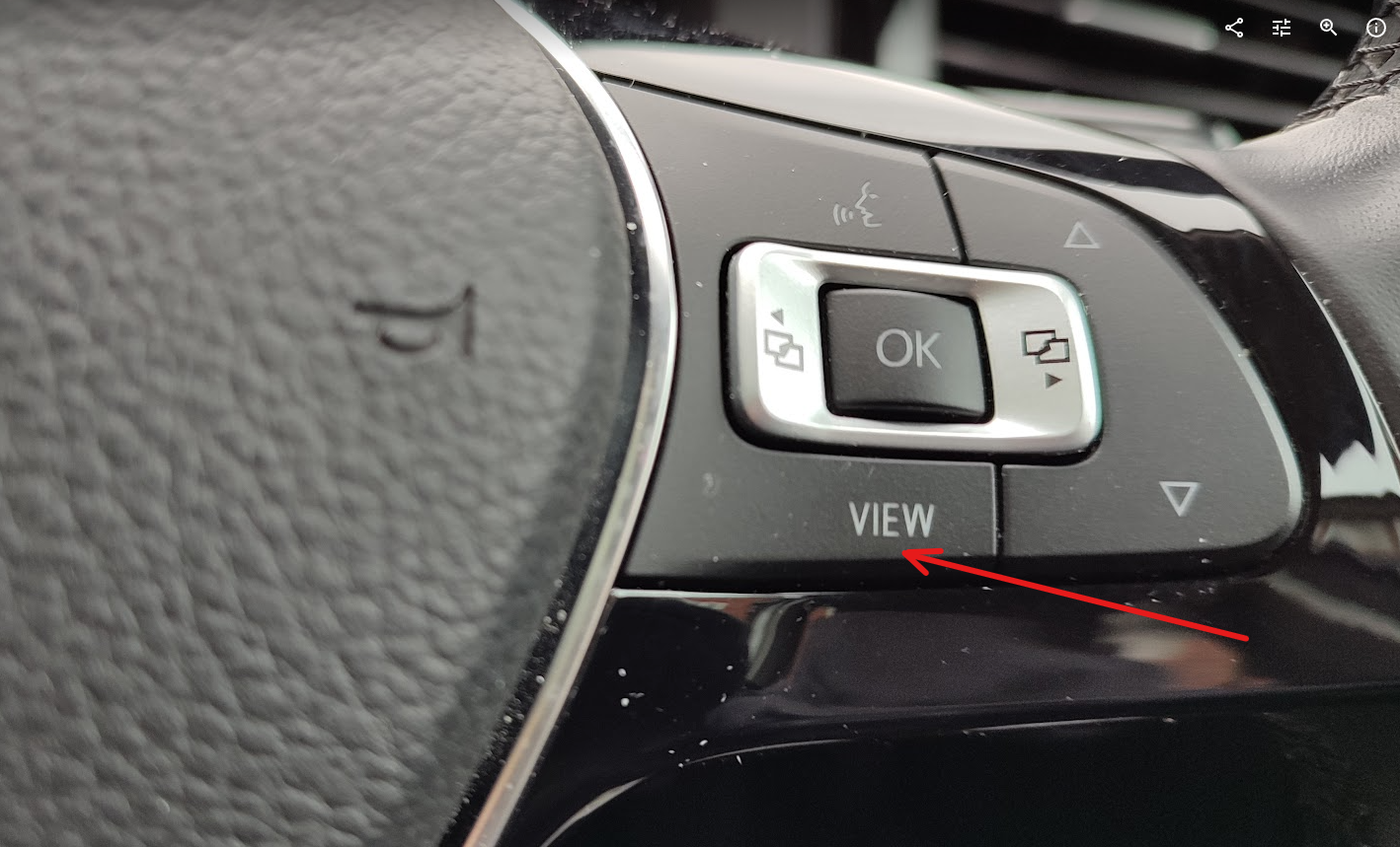

However today when getting a bit of time.. I noticed this button on the steering wheel.. VIEW which I have also never had to use..
Screenshot 2024-01-10 130001.png (1.2 MiB) Viewed 1990 times
Well.. VIEW button only switches between MPG/AVG/Oil temp etc and phone displays but at least I know what it does now.. I'll still not use the phone view but just wish it didn't default to the phone view rather than the one it left off with.

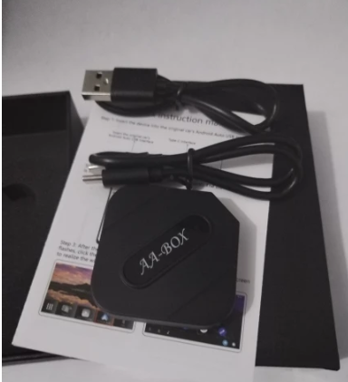

This is the device I bought some times ago...
Screenshot 2024-01-24 134542.png (128.73 KiB) Viewed 1657 times
after getting the problem mentioned here in this post of getting phone connection message on the instrument cluster (never seen this before) and not knowing how to get it back to usual display fuel average consumption etc... It has made me re-think the Wireless Android Auto problem.
Having got some time to sit and mess with this 'once working' wireless connection I sat in the garage today just to see if I could wake this thing up properly.. It always (pic above) connected the phone to the multimedia unit without any intervention from me at all, but stopped recently and the only thing on the Multimedia display was the phone's top line. Signal strength, batt level time etc.
Anyway .. I'm sat in the seat just looking at the display and notice a settings cog.. bottom right... only two things on the Menu.. top one was Use or Do Not VW apps.. can't remember now. Anyway in desperation of not seeing anything else to try, I took the tick off (thinking I can always put the tick back) and immediately up pops the Android map screen on the display. Amazed and sceptical i turned everything off (display, ignition, phone data and Bluetooth) and back on again.. it worked wirelessly again and a third and fourth time... it hasn't worked at all for a few months now so it is 'some' coincidence.
