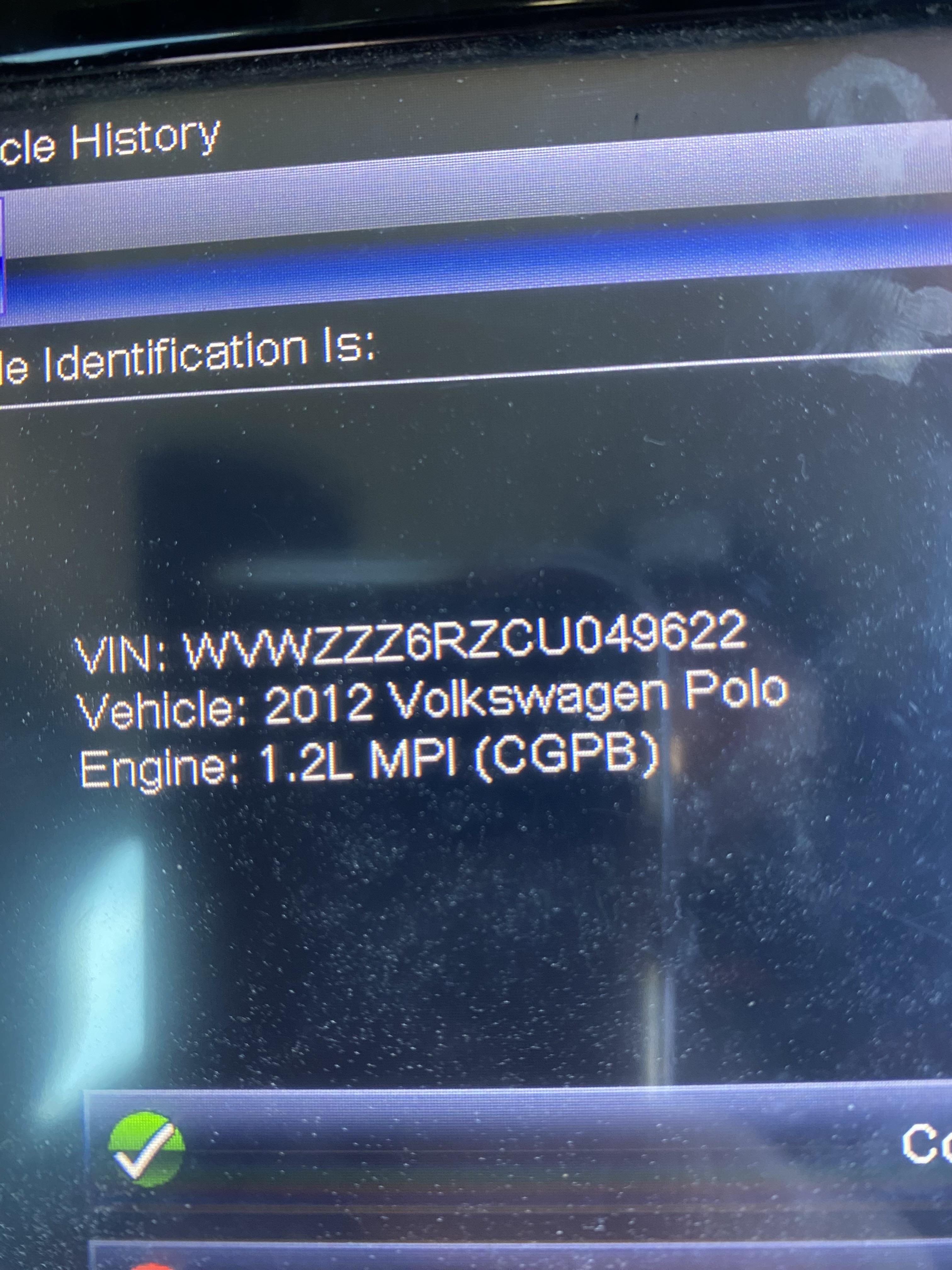

Hi, I have a 2012 1.2 in at the moment and the abs ECU code in is showing all zeros.
I have a snap on reader and launch that allow me to recode it but how do I find out the code ?
Thanks in advance
Polo 1.2 2012
WWWZZZ6RZCU049622
(CGPB)
