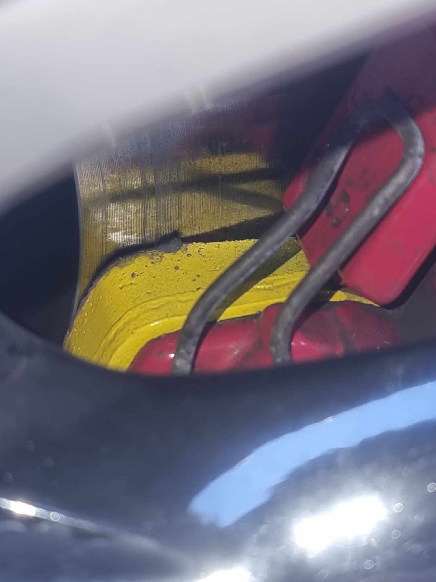

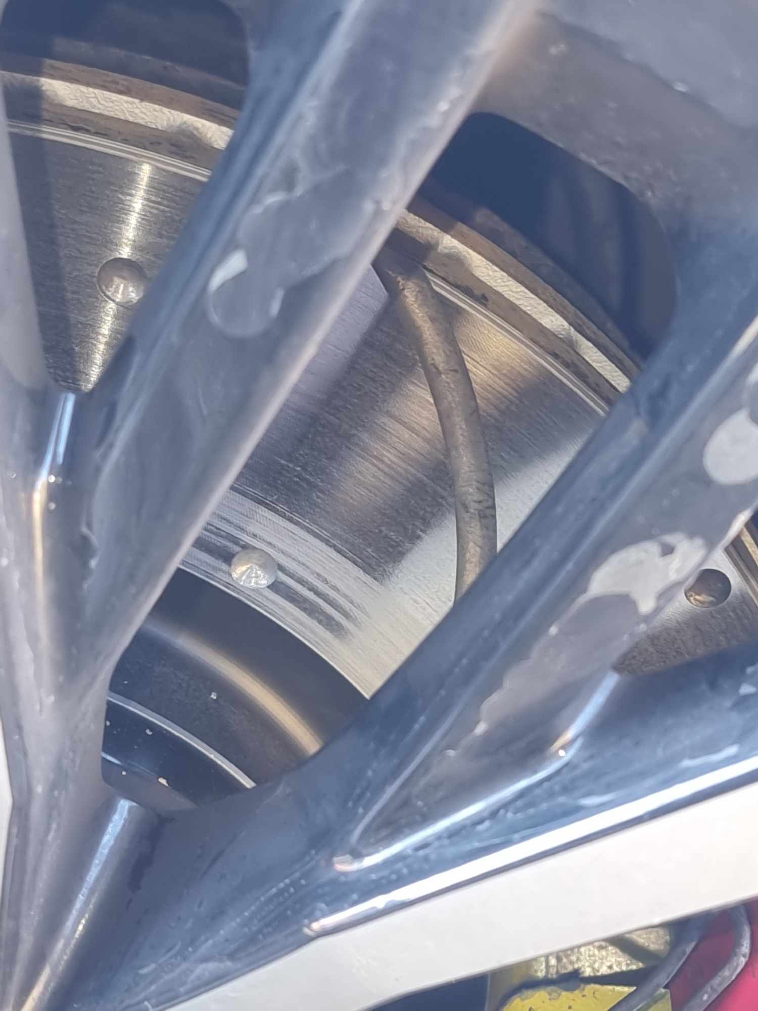

Hello. I had EBC Grooved discs and Yellowstuff pads fitted all around this week. I've done 30ish miles on them and I have noticed the inside of both front discs look differently worn compared to the rest of the disc. I also noticed it doesn't look like the pads are sitting completely flush with the discs, I'm not sure if this is normal or not. The brakes feel fine, although I am going easy on them. I will bed them in properly after 100 miles or so but I'm worried the garage didn't install them correctly. Any advice will be appreciated.

That's normal with new pads and used rotors

The rotors are brand new along with the pads
Re: New pads and discs not sitting flush?
I see. I wouldn't worry about it too much after 30 miles. Keep an eye on it for a while.
I've found its a good practice to clean the carriers where the pad slides with a file ( just file down the rust layer), the steel brush never cleans it properly it just shines up the rust layer.
And to make sure the pad slides freely withouth sticking in the carrier
