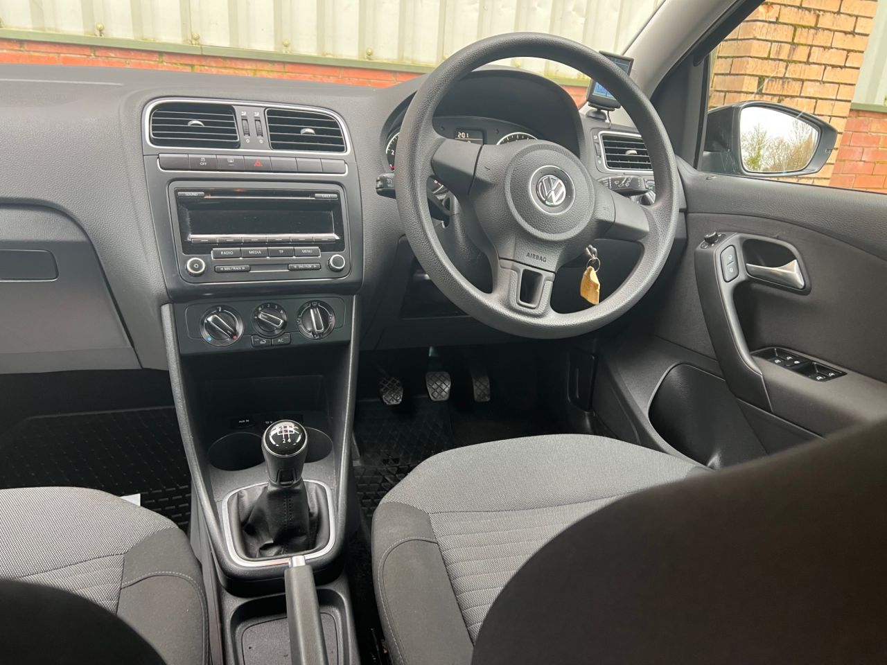

Just purchased a 2013 1.2 Polo Match. I want to upgrade the head unit to a Car Play (non VW) like this: https://www.ebay.co.uk/itm/354172367407
Can I simply swap the head units out or is any re-coding required?

if your car is 6R
its plug and play
its plug and play

How would I know if its a 6R?
Re: Non-VW Apple Car Play head unit install
Perfect, thank you. I didnt realise it also tells you in your VIN.
