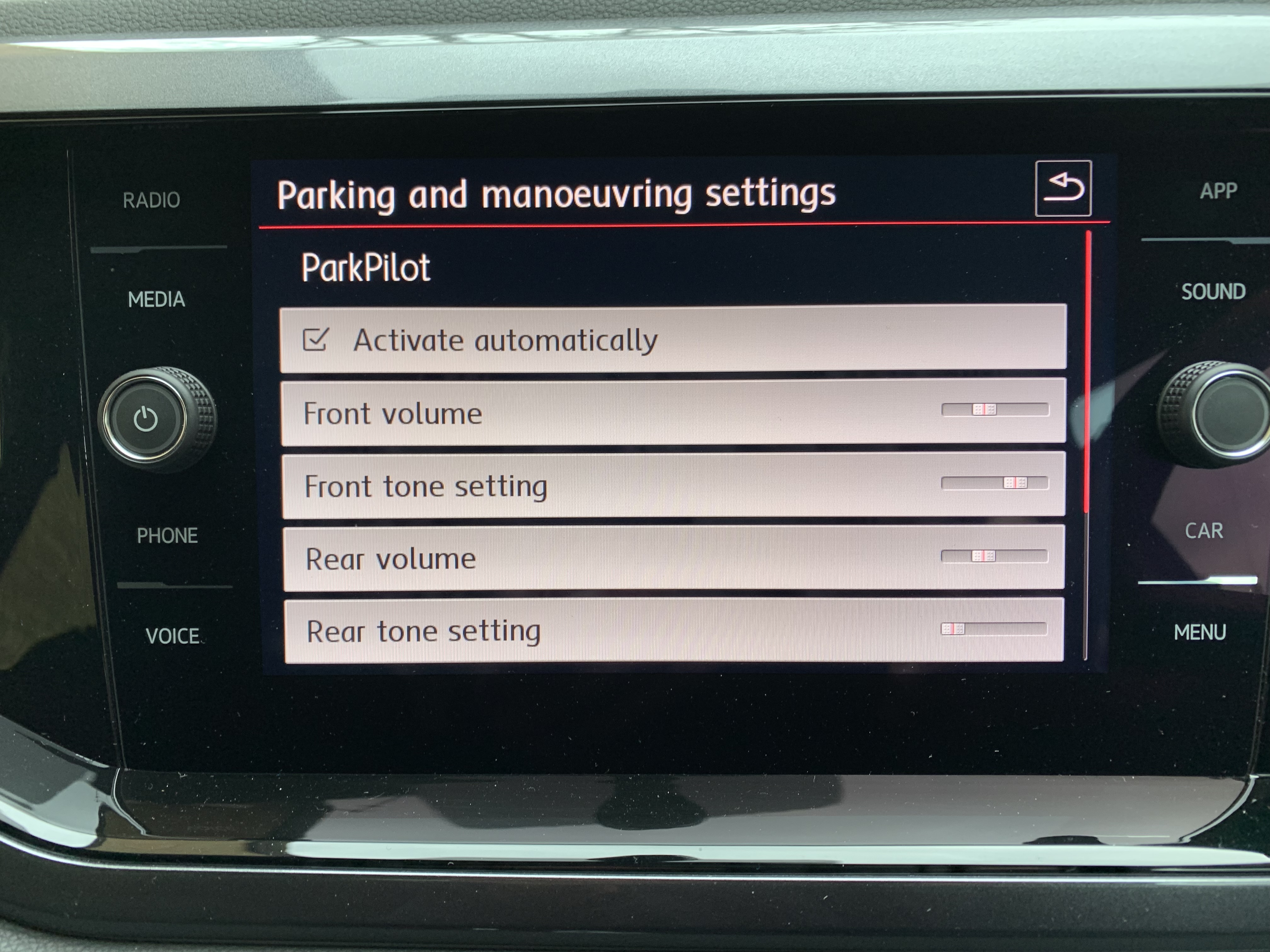

Posts: 3847
Re: Polo GTi + - Reverse Parking
RobJJW wrote: Tue Jan 30, 2024 10:06 pm
SRGTD wrote: Tue Jan 30, 2024 9:56 pm
RobJJW wrote: Tue Jan 30, 2024 9:27 pm Here’s a link to a vid, where you can hear the difference between front and back:
https://youtube.com/shorts/33i-lb08SbE? ... vxtvpFAYJv
That definitely doesn’t sound right.
Cheers for confirming. The fella I bought the car from has taken out an extended service plan, which I’m gonna continue. I’ll ask them to look at it when it has its next service in March. Hopefully it’ll be covered by the warranty!
These are the settings for my parking sensors - the volume sliders are towards the lower end of the scale but the sound from sensors is plenty loud enough for me.
