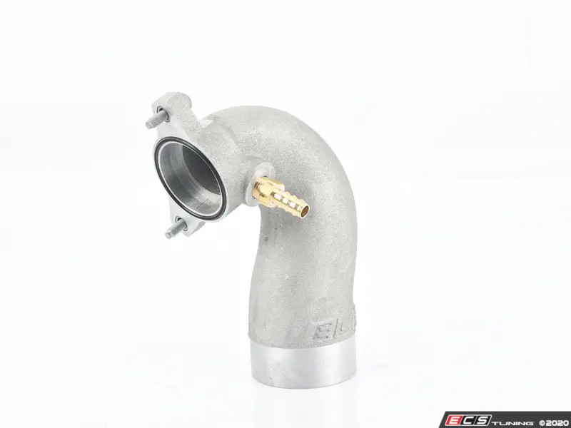

I have ECS intake arriving next week. No idea if it'll fit, but, hey, it was free (kinda).
It has port on the intake side:
PS: Nice Ducky :D

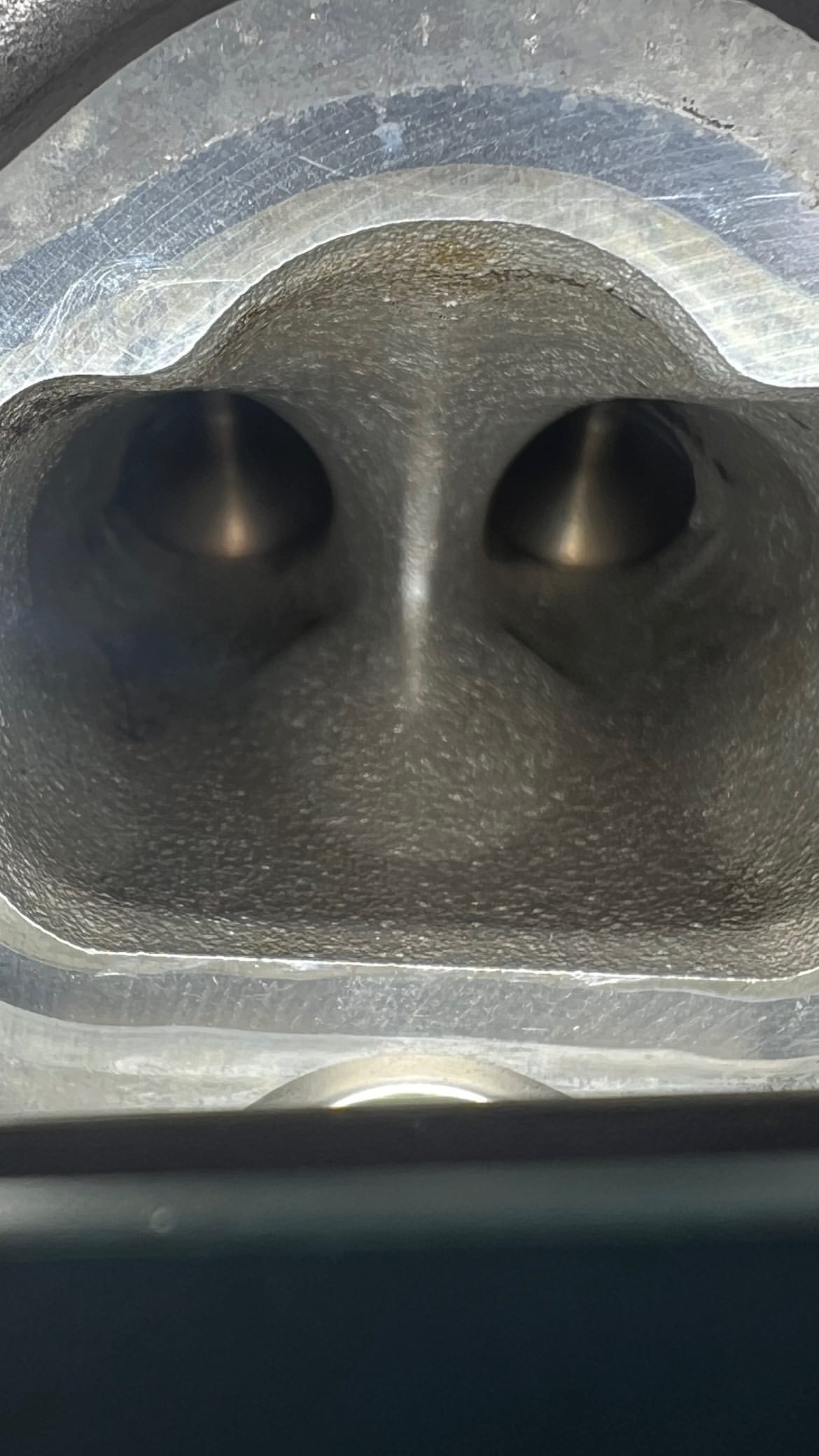

To be honest, I don't know. But each time I removed the pipe from turbo to intake manifold, this one is full of oil. So to me, turbo side is the issue.
Nice intake, you want so power upgrade to your engine ?
Before:
After:
The car feels soooooo much better. More torque, more power: more smooth.
With my VCDS I reset auto adaptative value of the injectors, recalibrated lambda sensors etc....
But yeah, I have the feeling to have a brand news car.
