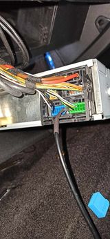

Hey! Was just hoping someone could shed some light on how I am to go about wiring up the new reversing camera I bought, to the quad lock of my mib 2. It’s the badge flip style one (of course of AliExpress). I can see many posts about installing the same thing, but I can’t seem to find the answer anywhere.

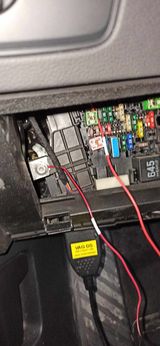

Positive thick red wire with fuse tap-- connect to +30 signal(battery feed)
Black thick wire to-- any near by ground point.
Blue wire to reverse light ( tail light connector)

You've already connected correctly the video signal lines to blue connector of quadlock connector.

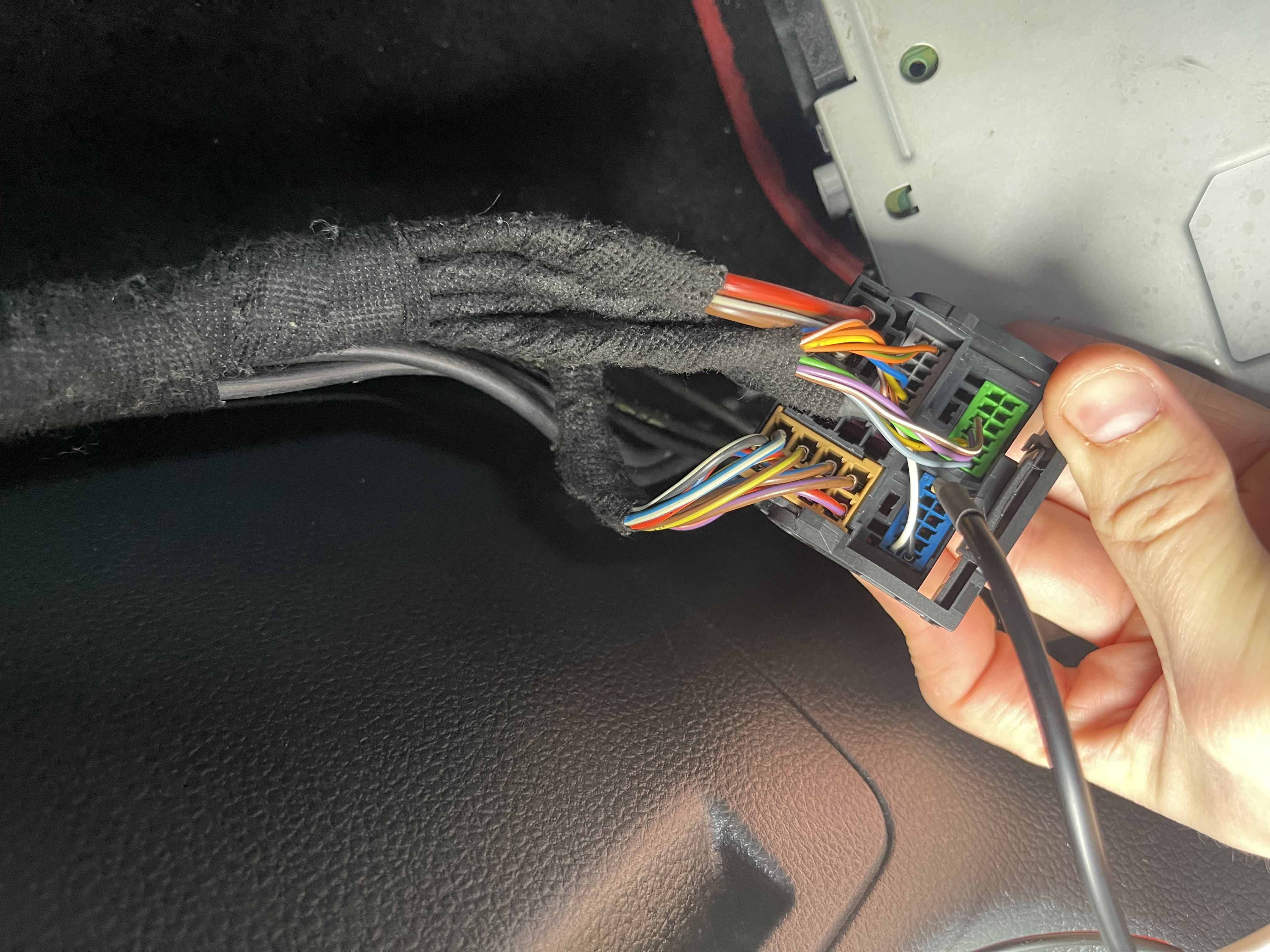

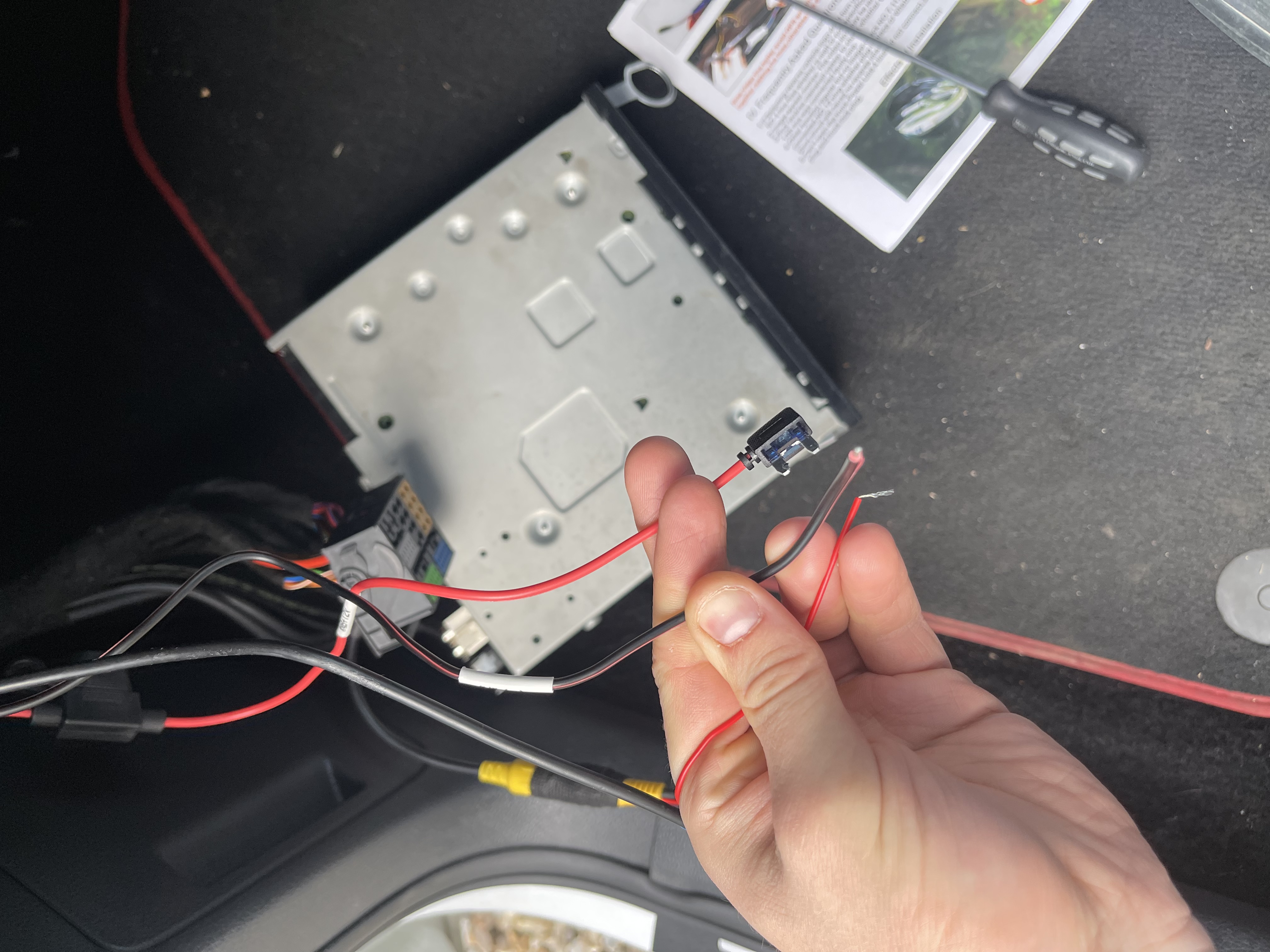

Hello, can you help me with the MIB2 coding, I have connected the camera as shown in the pictures but camera does not turn on, the emblem opens up and the camera shows, but no video signal to the screen is shown, just the park assist.
