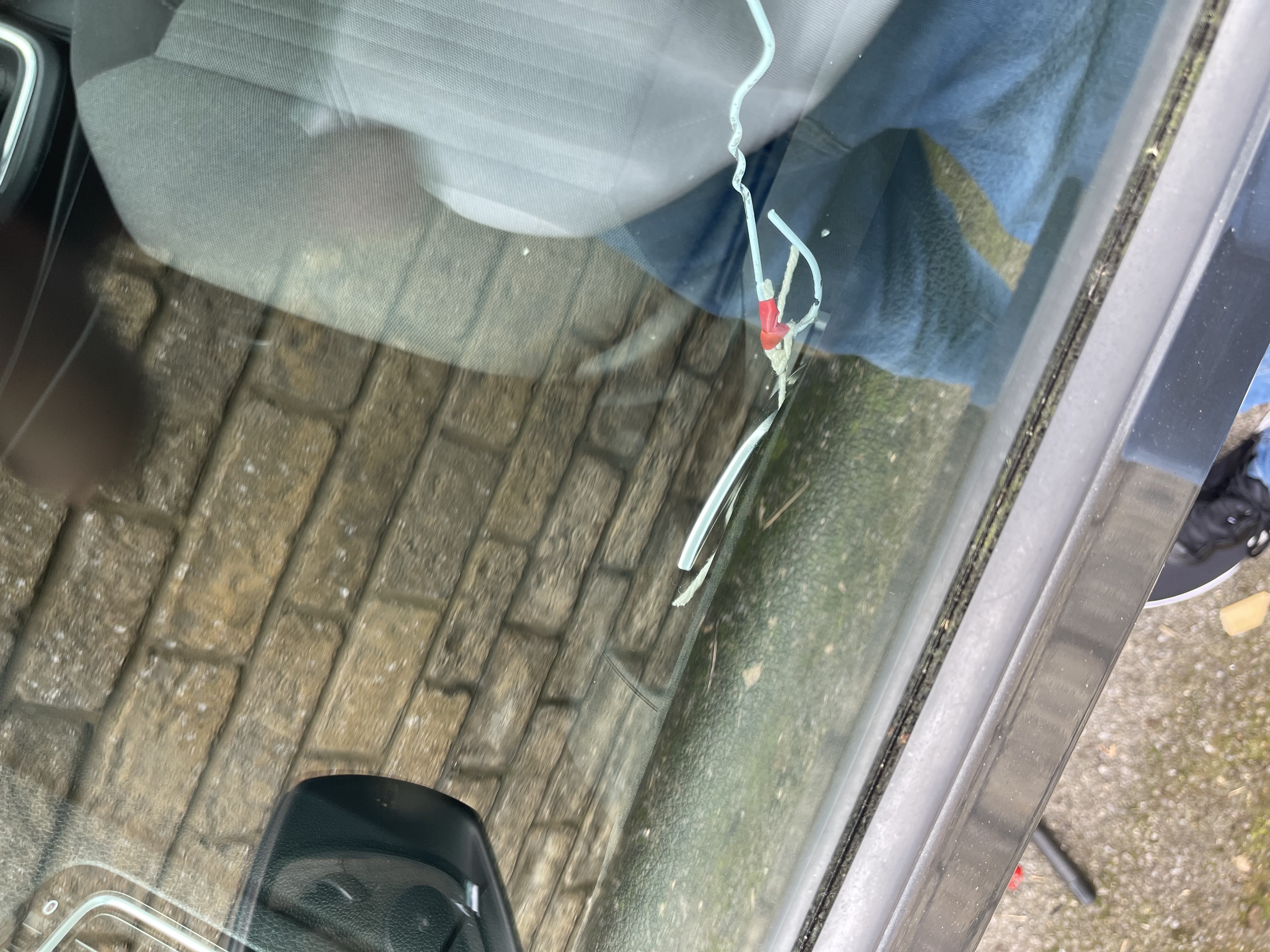

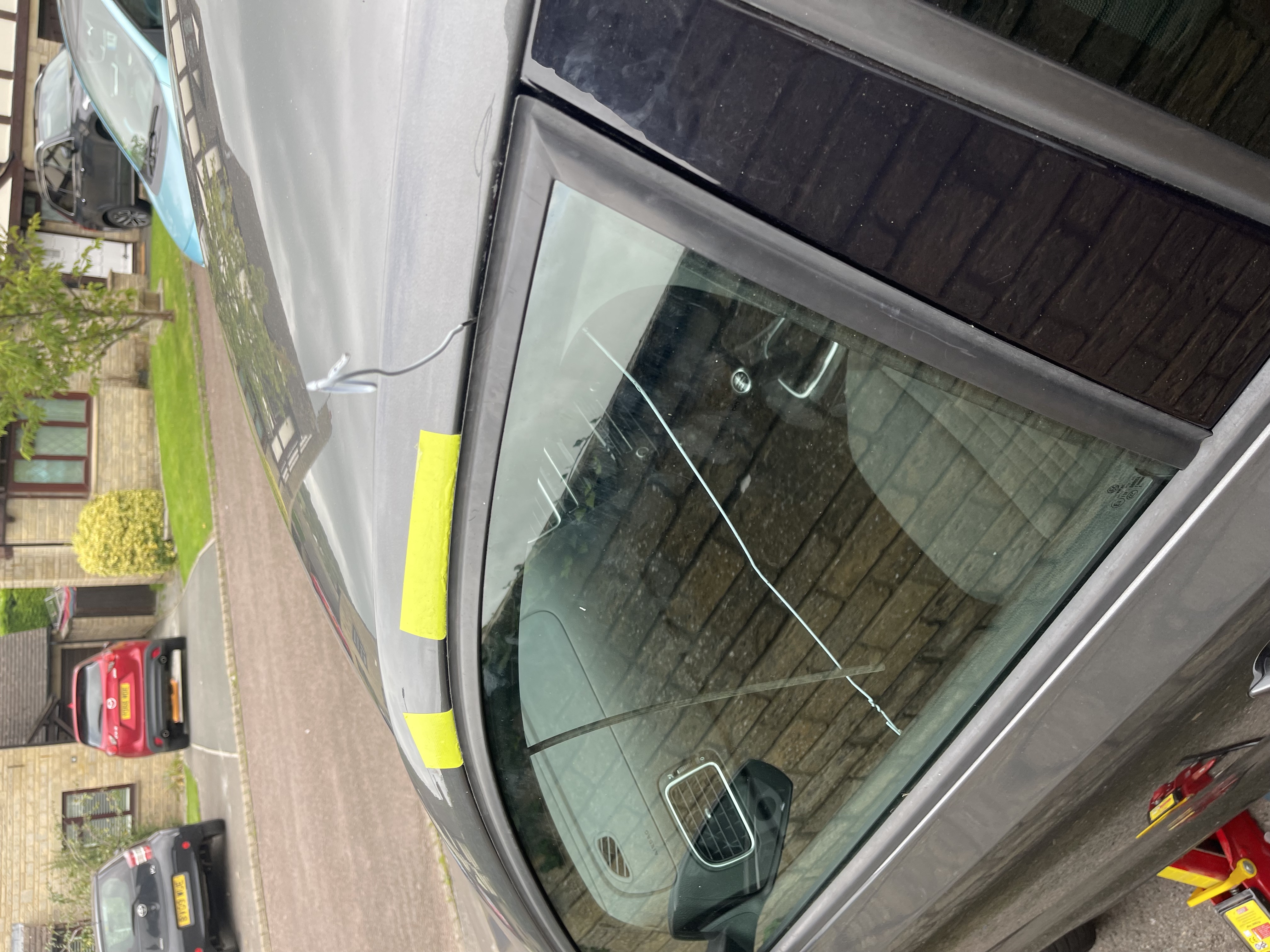

I've attatched some images of the door handle thing.
- IMG_0876.jpeg (2.77 MiB) Viewed 5063 times
- IMG_0875 2.jpeg (2.5 MiB) Viewed 5063 times

...ask yourself again why it doesn't open, then provide the vehicle with what it needs to open with the remote control.

Well, how did you get on, I hope that you worked out why pulling the internal door release could not work - if not, the locks will be deadlocked?
