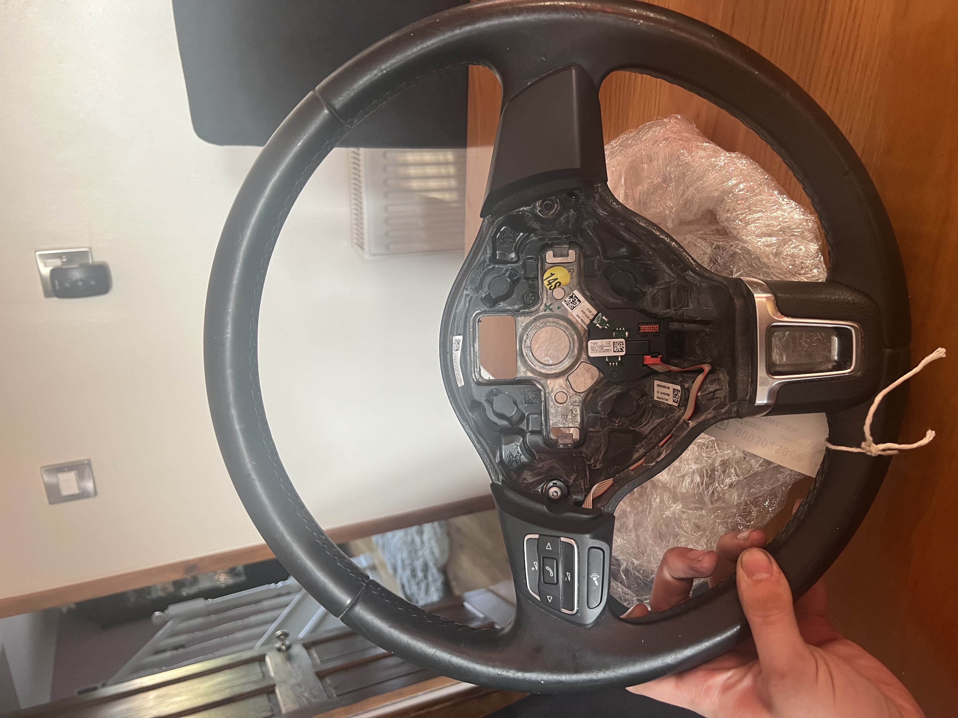

This is the wheel I have purchased and would like to fit

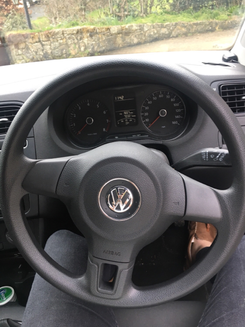

This is my current wheel
I have a Polo 6R I want to install this MFSW I’m querying if I need to get any adapters or any whole new looms entirely to fit it, I’ve never done this before and I would really appreciate some help for you very knowledgeable fellows I’m sure the airbag I have fits the new wheel, the wheel is the same base I’m sure just with the Multi functions on it, do I then have to get worry about getting buttons assigned to my car as I have a RCD360?

for this you'll need to add two wires from the slip ring to the fuse box and bcm. you'll also need another airbag and a loom for the airbag. and something like vcds or obd11 to code your bcm.
