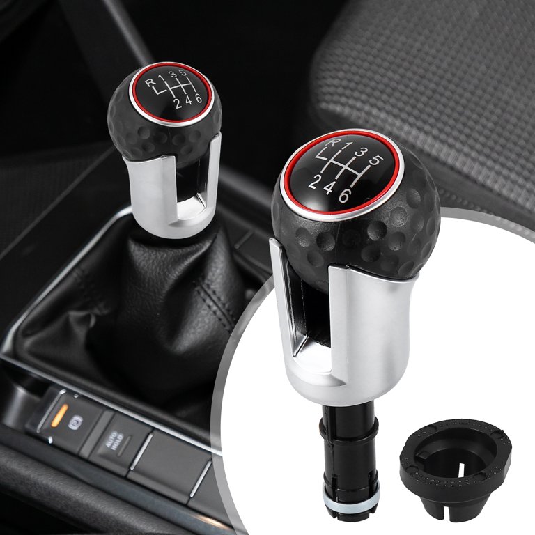

I have that type of knob, its leather ( its not original) and the car is parked outside and 0 issues for few years now.
I'd rather buy a replacement know if it breaks, 150+ for a knob seams outrageous.

Thanks Amer6R. I am going to have a go at replacing just the Gaiter with a leather one but just in case it goes wrong I'd be grateful if you could let me have to details of the aftermarket one pictured - due you have a link. Cheers

Re: Anyone Replaced the Gear Stick Gaiter on Polo 6c
Its golf 7 gtd shift knob. But I'd recommend sticking to 6R or 6C because this one requires modofication.Gee40 wrote: Sat Feb 17, 2024 5:34 pm Thanks Amer6R. I am going to have a go at replacing just the Gaiter with a leather one but just in case it goes wrong I'd be grateful if you could let me have to details of the aftermarket one pictured - due you have a link. Cheers
