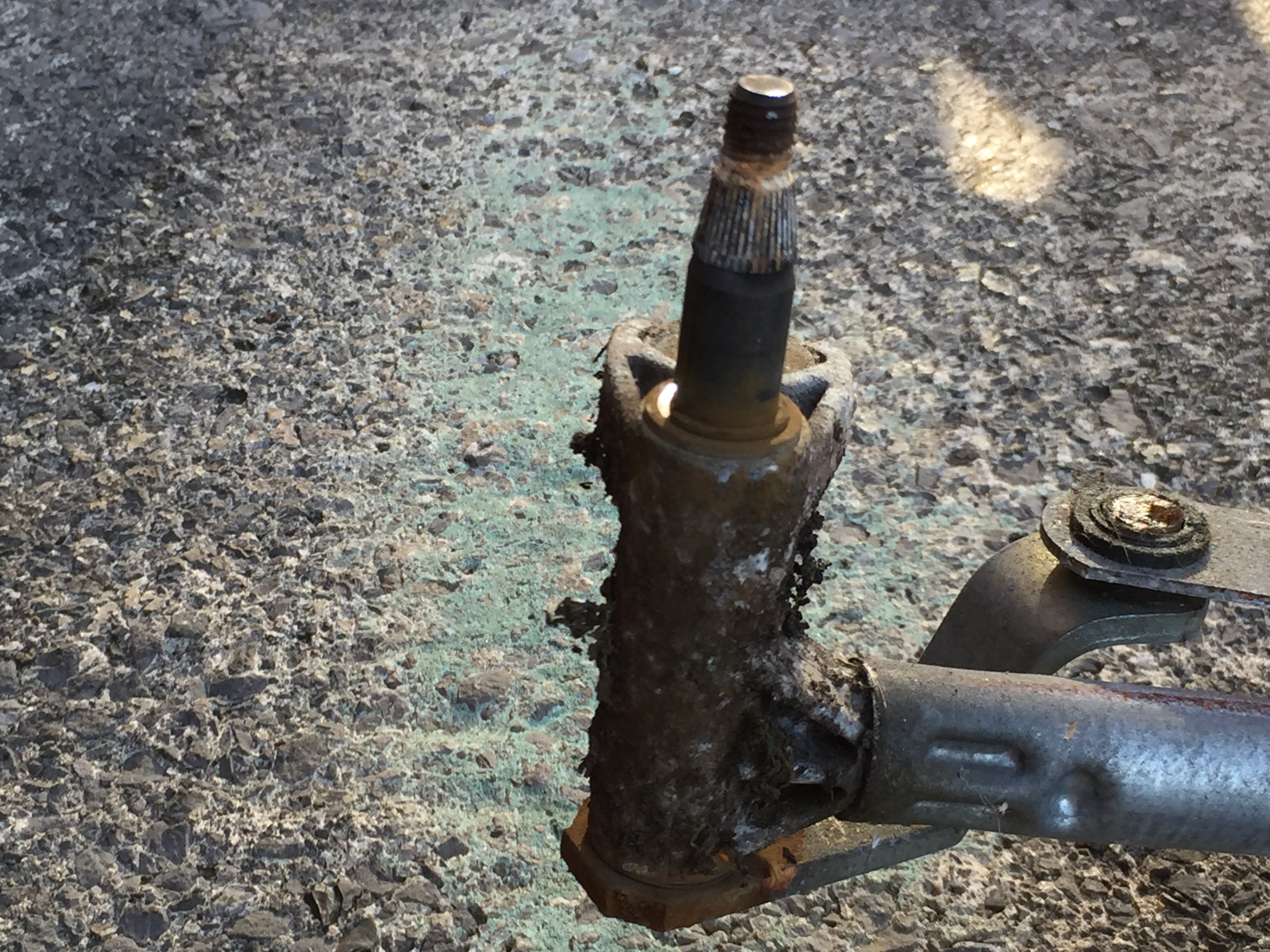

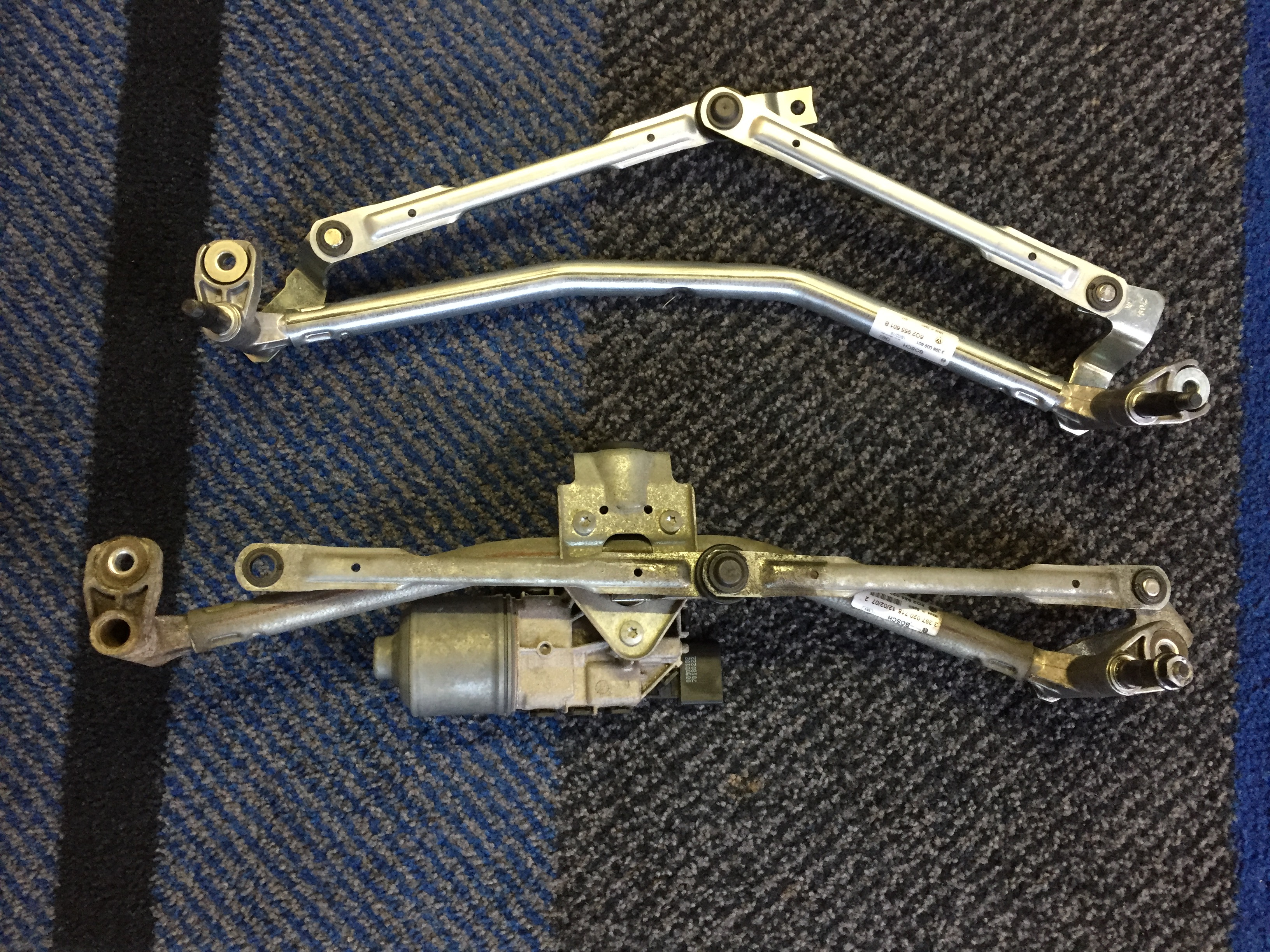

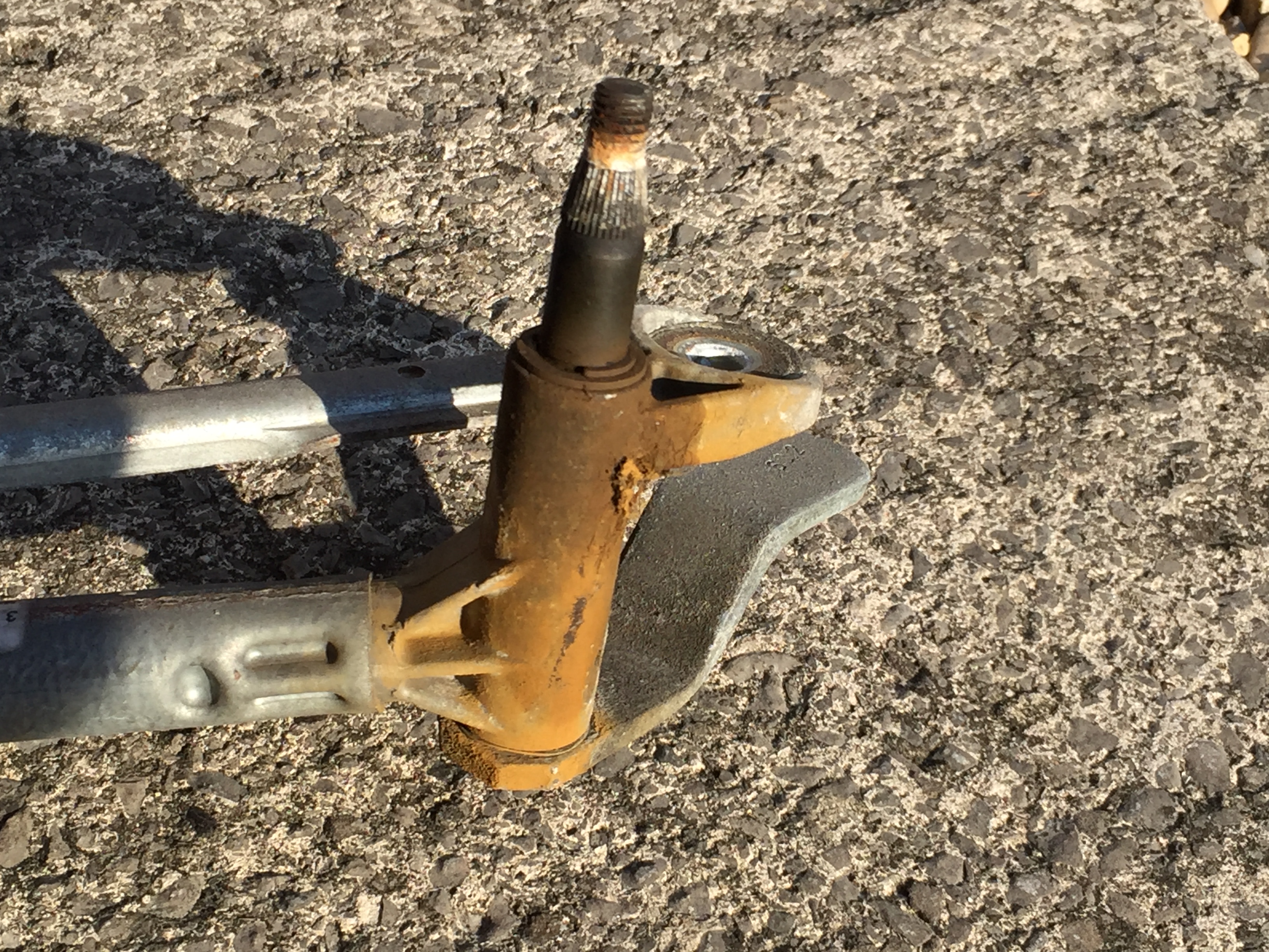

Hi, I’ve had this issue on my 9n3 and as said the spindles seize up ,i lubricated them but this was only a temporary fix.I ended up replacing the linkage with a new genuine part .

Last two images show the part that you need to push out from the housing. if someone wants to attempt a repair. On a 6r there is like a plastic gromet/ washer that goes on the spindle before the wiper arms and it greatly reduces water going into the bushings.CarbonChaos wrote: Thu May 23, 2024 11:15 pm Hi, I’ve had this issue on my 9n3 and as said the spindles seize up ,i lubricated them but this was only a temporary fix.I ended up replacing the linkage with a new genuine part .

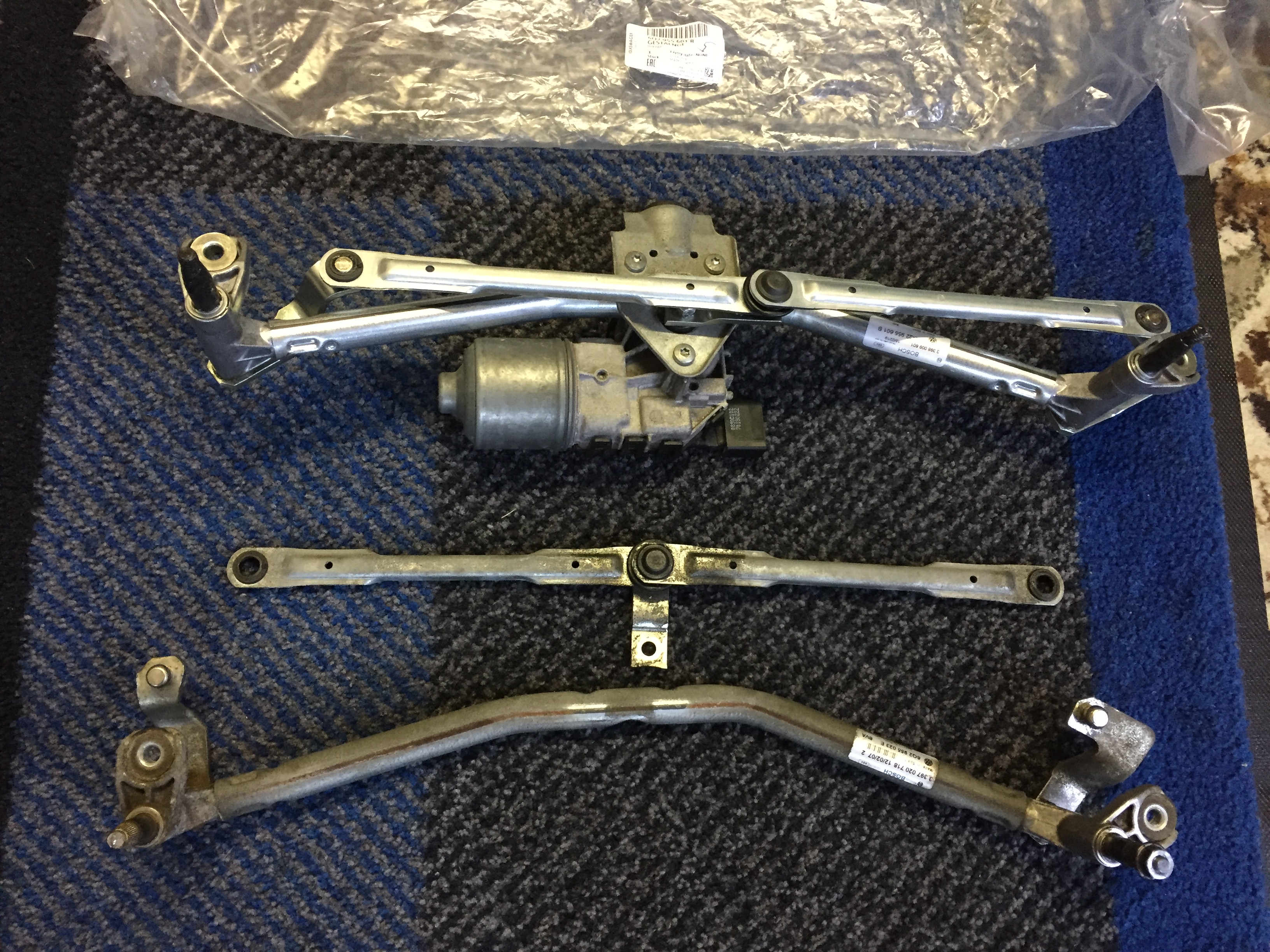

How long did lubricating them last , until I could order a new linkage and fit it .as said temporary fix.
As for needing a press absolutely not, the new OEM wiper linkage comes ready assembled all you have to do is remove the motor and swop it onto the new linkage its that straight forward.

Old and new hotness
Part number is visible in the picture
