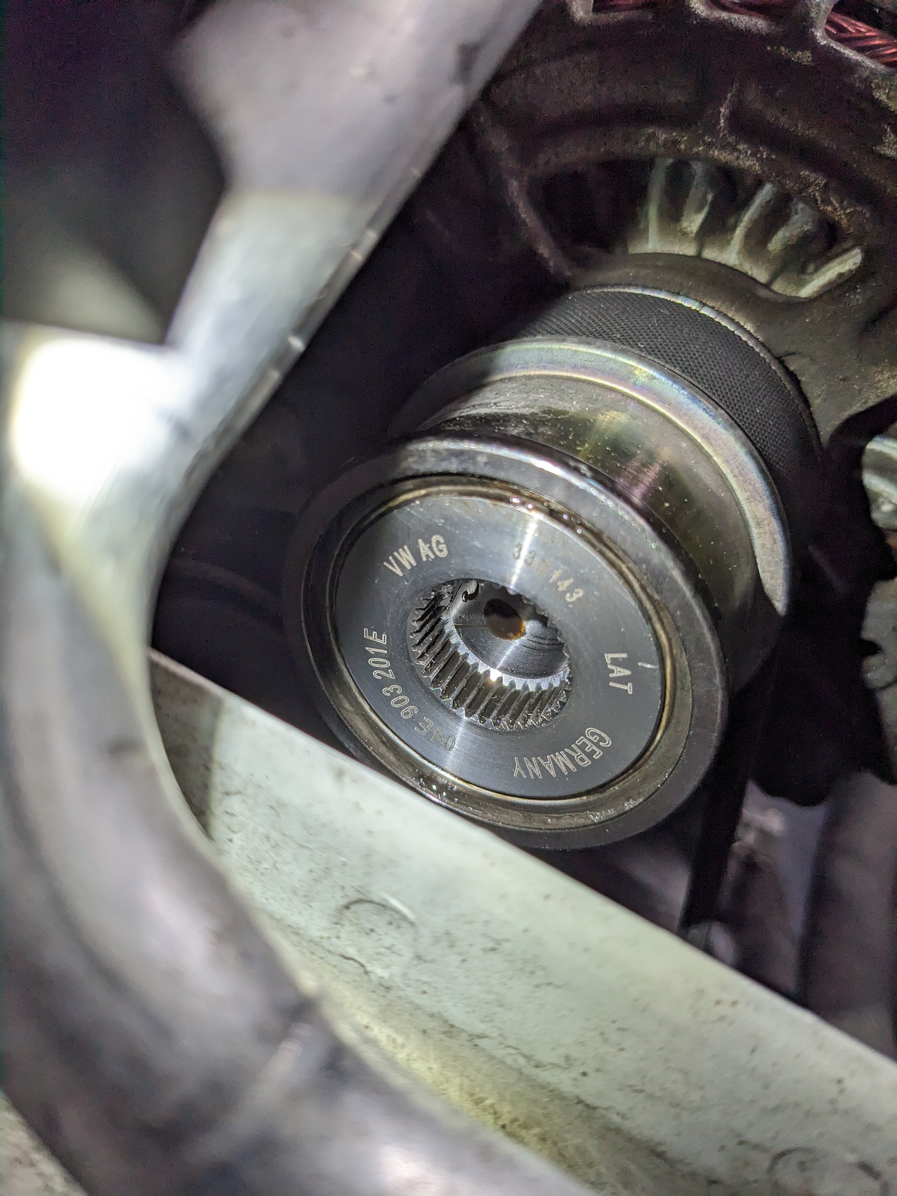

Also I'm thinking about replacing the freewheel pulley on the alternator. This items tends to fail over time, creating a non-smooth operation on the engine (shaking engine) on the deceleration.
INA produce the INA 535 0363 10 items and GATES alos, but under the brand Litens (original equipment from VW for belt tensionner for exemple)

I'm also considering to replace the freewheel pulley on alternator. It's a easy job and it could, maybe, make my engine a little be smoother.
I just remove the cap and clean the grease/oil and here it is:
Part Number is: 04E903201E
No more information available.
On internet INA and Gates (with Litens brand ????) on it, both are nice/quality brand.
But I'm not ready to pay 140 euros for the "official" one with just a VW logo on it.
EDIT: after some research, LITENS is the official supplier for our engine (at least, with the Bosch alternator).

Yes I saw the brand stamped on my V belt tensioner.amer6R wrote: Wed Jun 12, 2024 8:03 pm Litens is also OEM for belt tensioners, as far as i know they have a patent or something and every kit comes with their tensioners
When I removed the black plastic cap cover of the freewheel pulley, it was full of mixte of water, grease etc...Not sur if it's normal. Look like a failure.
