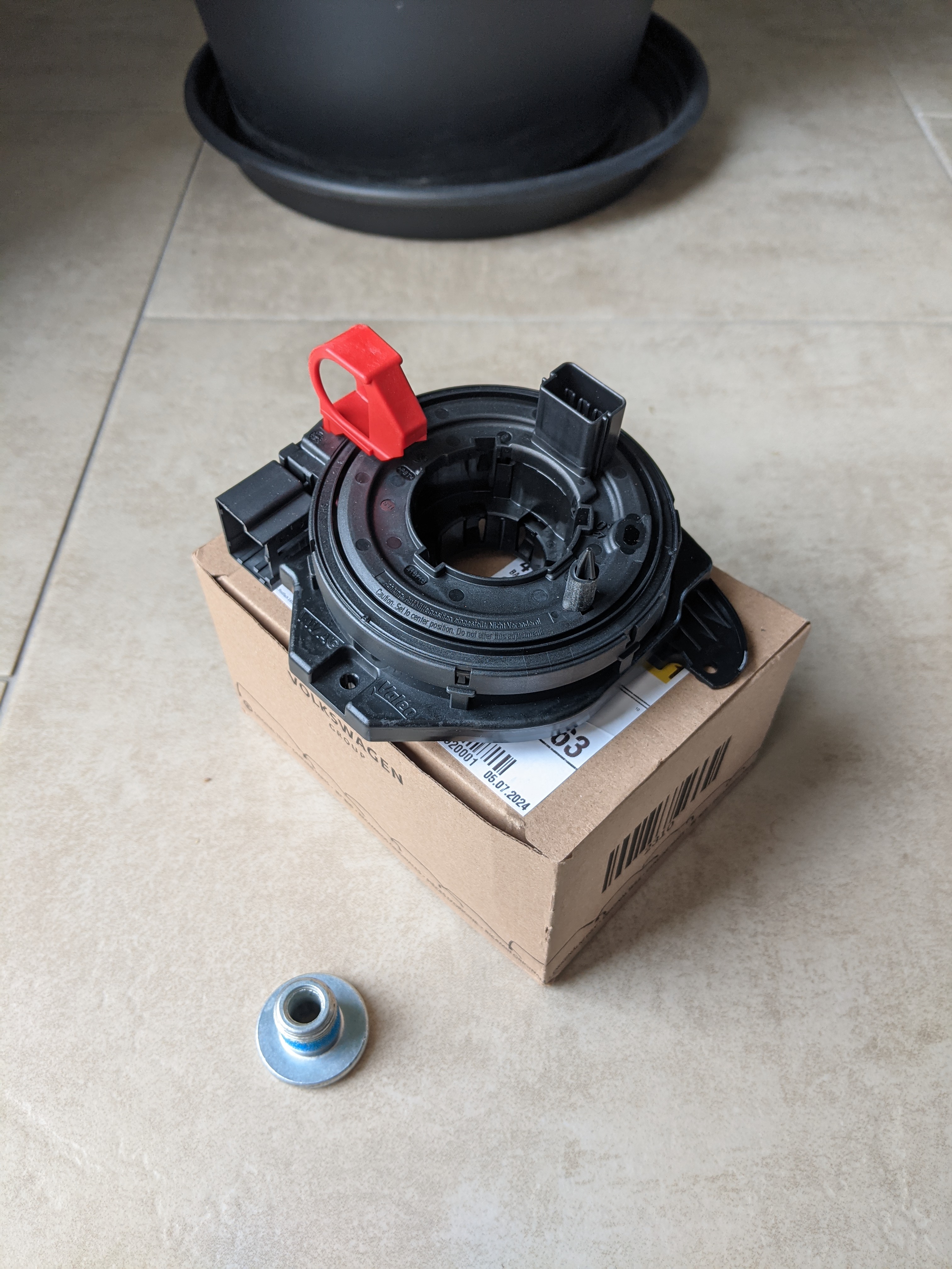

Lucky me, my dealership has all the parts in stock:
Next week I will change that.
