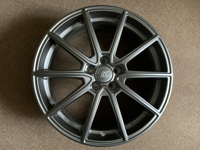

I like the look of those RC design RC32's. I assume that's what you have, if so can you kindly post a photo of them on your car mate

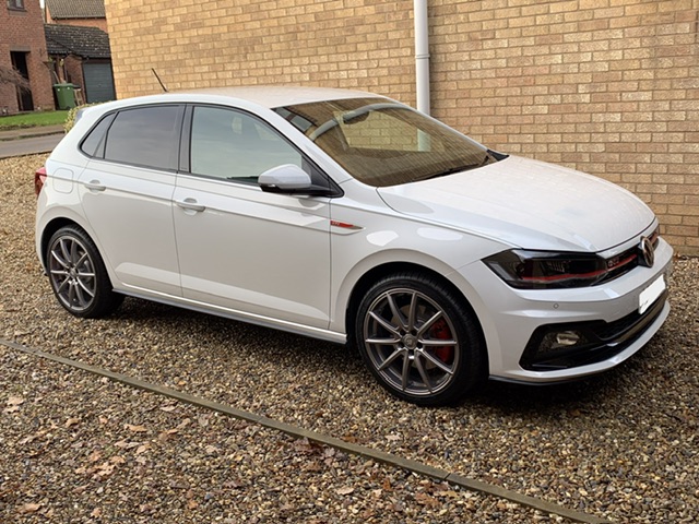

I had diamond cut alloys on a mk6 Golf GTD and two of them succumbed to white worm at around 30 months old, and that was in spite of me being meticulous in the way I looked after them. Since then, I’ve always swapped out any standard factory fit diamond cut alloys for something with better durability.
Yes, they are RC Design RC32’s in Ferric Grey Matt powder coat finish. Here they are on the car;

Thank you for posting.... I must say they look bloody great especially against the white, my car being Smokey Grey I wonder if they would look as good as they do on yours
