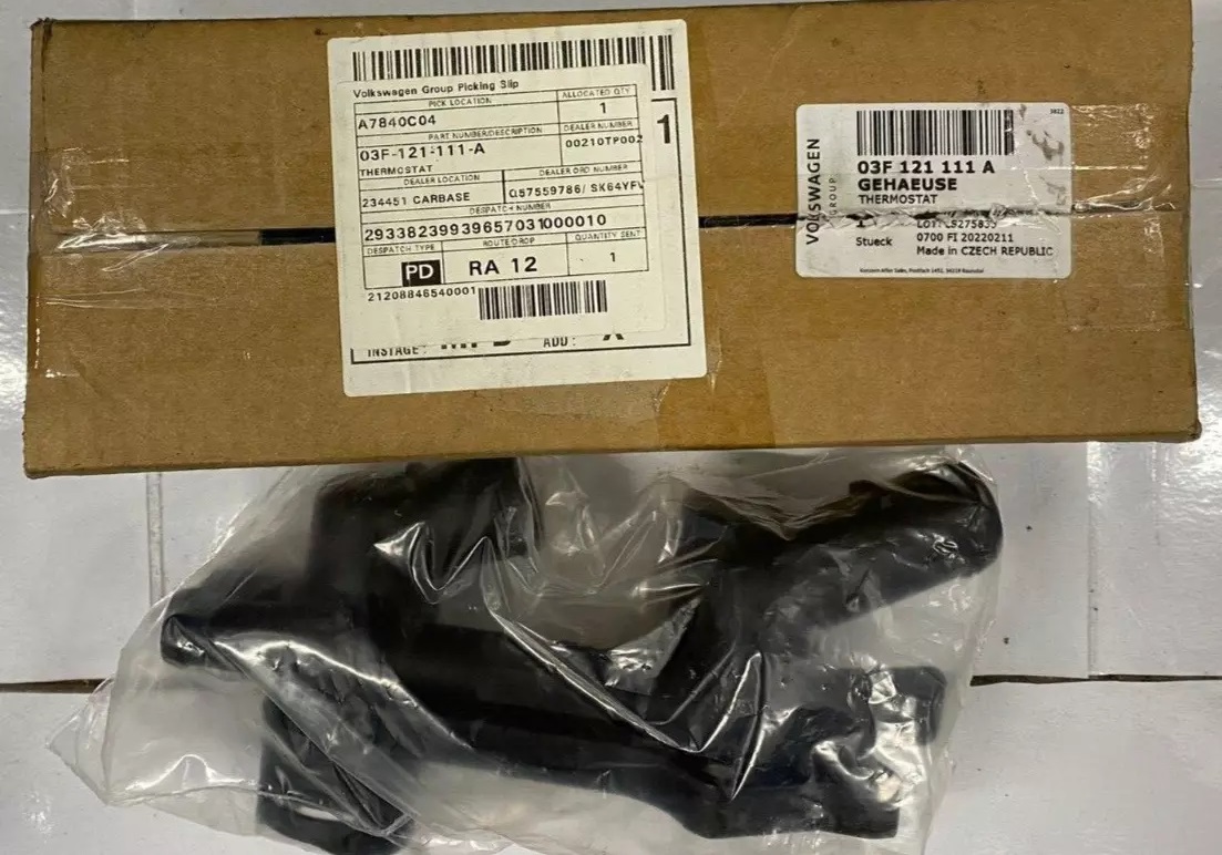

Luckily, I've managed to pinpoint the source of the slow leak to the Coolant Thermostat Housing , Part # 03F 121 111 A , [part 82 in diag]
VW Polo 1.2TSi Coolant Thermostat Housing.jpg (249.86 KiB) Viewed 3600 times

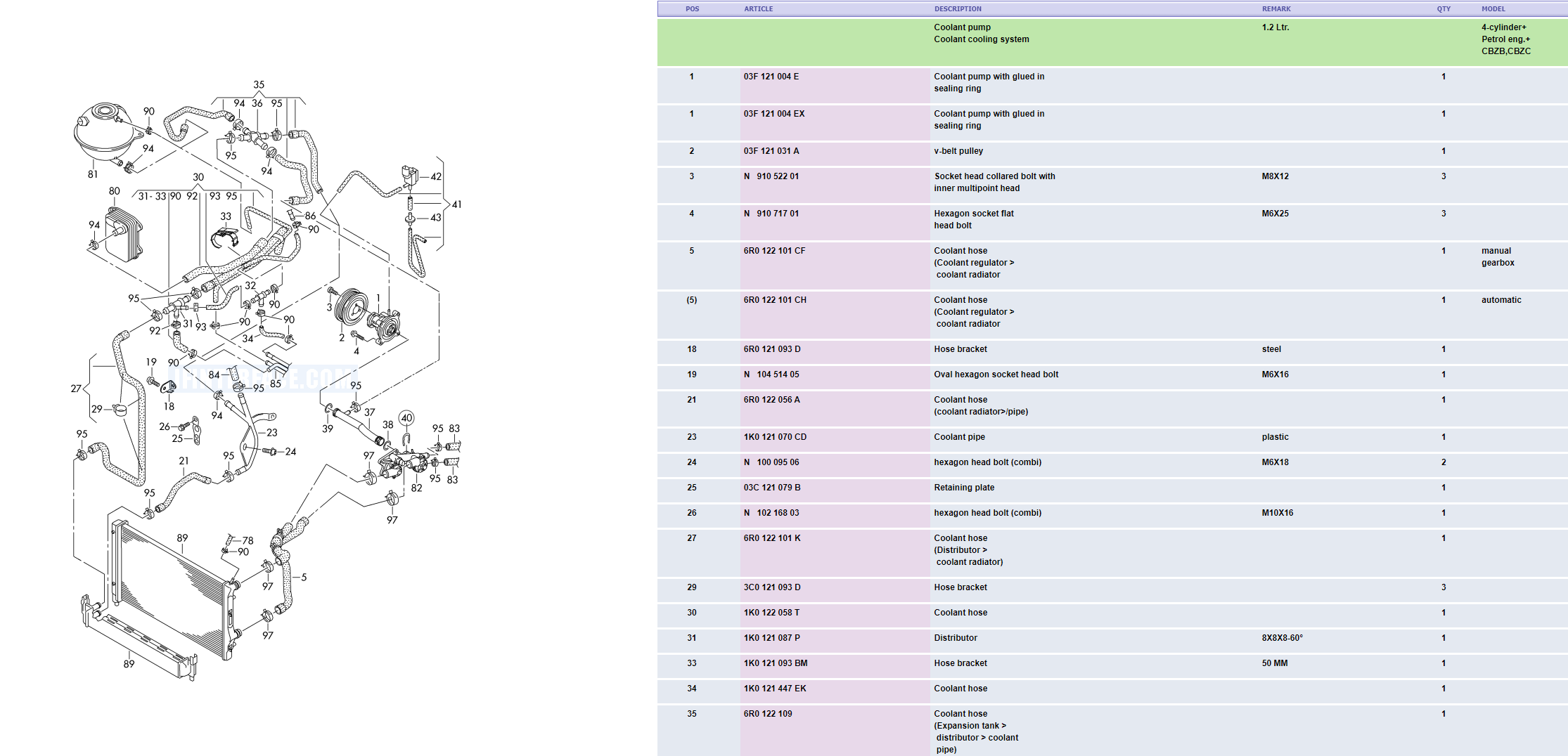

I've also purchased the Coolant Water Pump, Part # 03F121004E , [part 1 in diag] :
Coolant Regulator Housing Reservoir thermostat3.png (296.36 KiB) Viewed 3600 times

Question is, can someone please provide the Torque Specs for both the Coolant Thermostat Housing (# 82) and the Coolant Water Pump (# 1) bolts , please?
