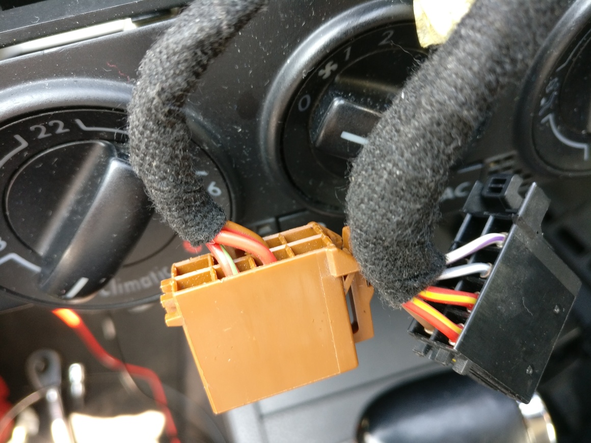

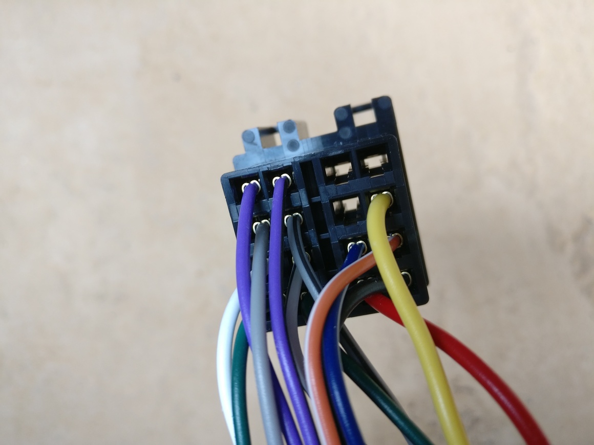

In the middle of a Android head unit install. Replacing OEM stereo.
The correct type of connector blocks are supplied with the new unit but the wiring does not line up with the original.
Do I need an adapter or can I jump some of these wires/pins?
Car connector
New stereo connector
Also installing a new DAB powered antenna that needs 12V. Can I take if from the car connector block?

Not sure what happened with the images. The first two are the existing car connector and the last is the new stereo connector.

The new radio needs an ignition live. You need to cut the red wire on the radio side unless it’s on a connector you can remove and feed a 12V ignition live to this.

Just to close this off in case it might help someone, the wiring was 'correctly' installed as in yellow from car to yellow on head unit and red from car to red on head unit. For some vehicles (e.g. VW) the wires need to be crossed. So red from car to yellow on head unit and yellow from car to red on head unit. On ignition key operation the head unit now resumes where it was set before (i.e. if it was off it stays off) and returns to the same source on power up.
