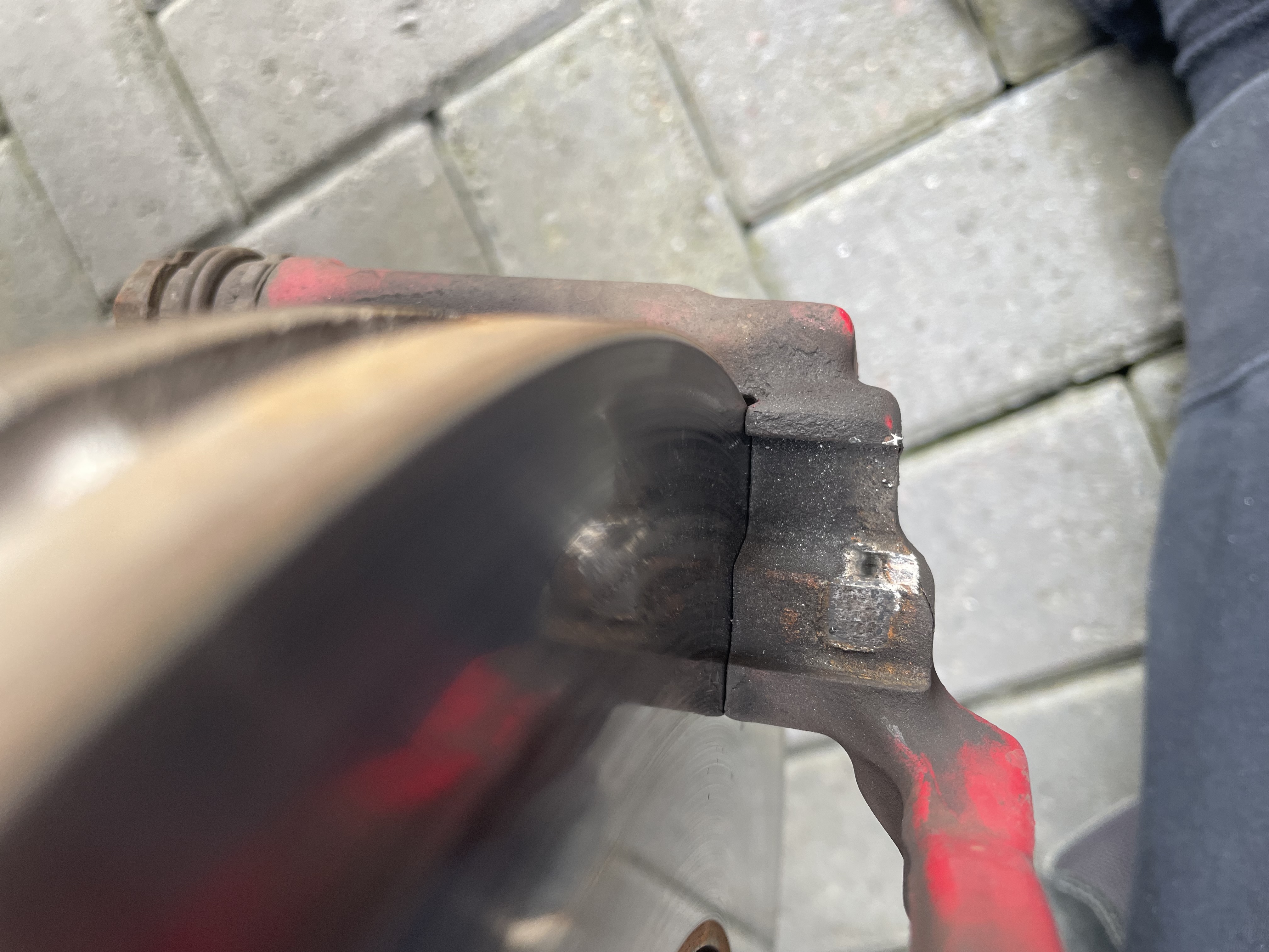

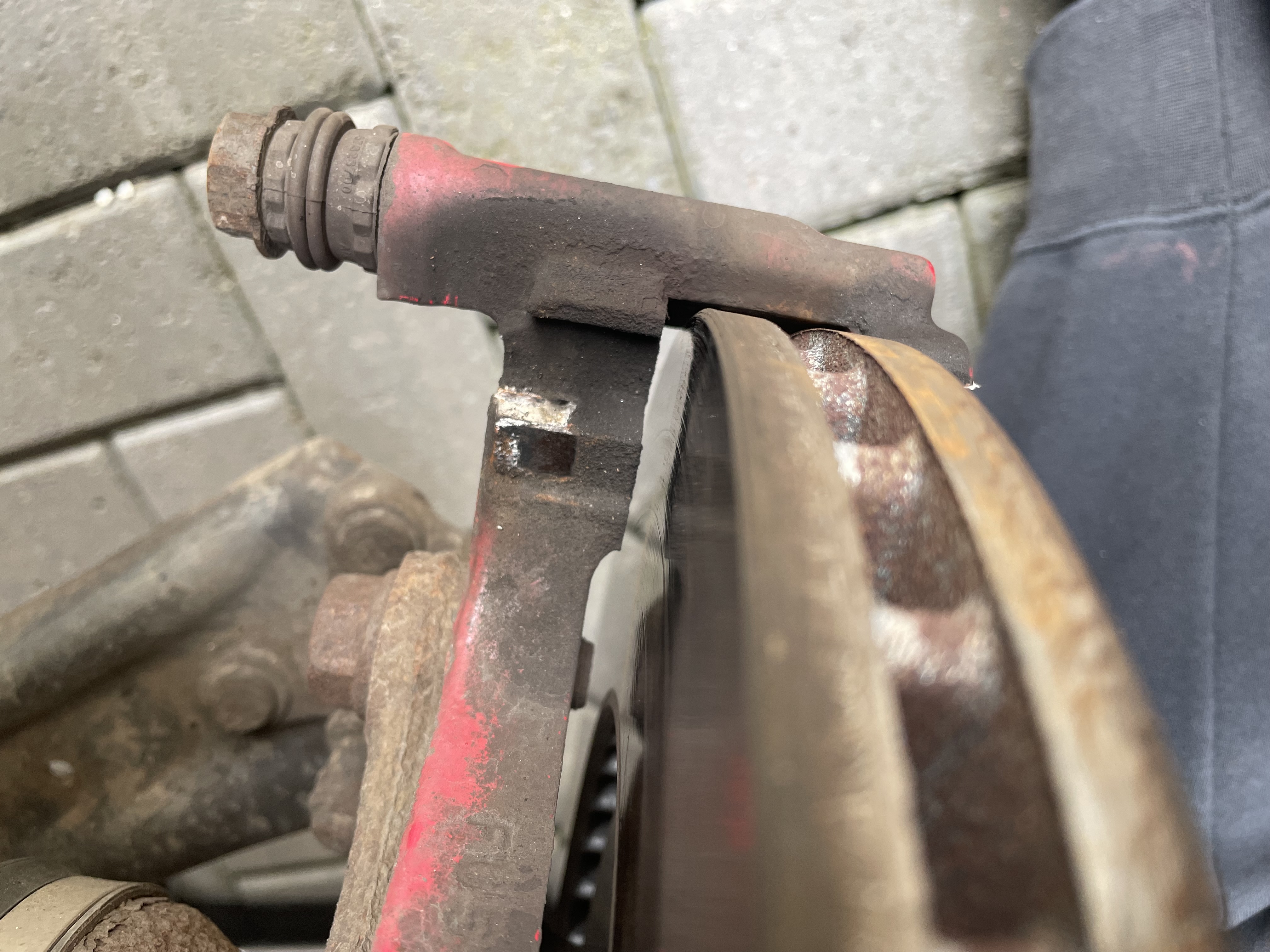

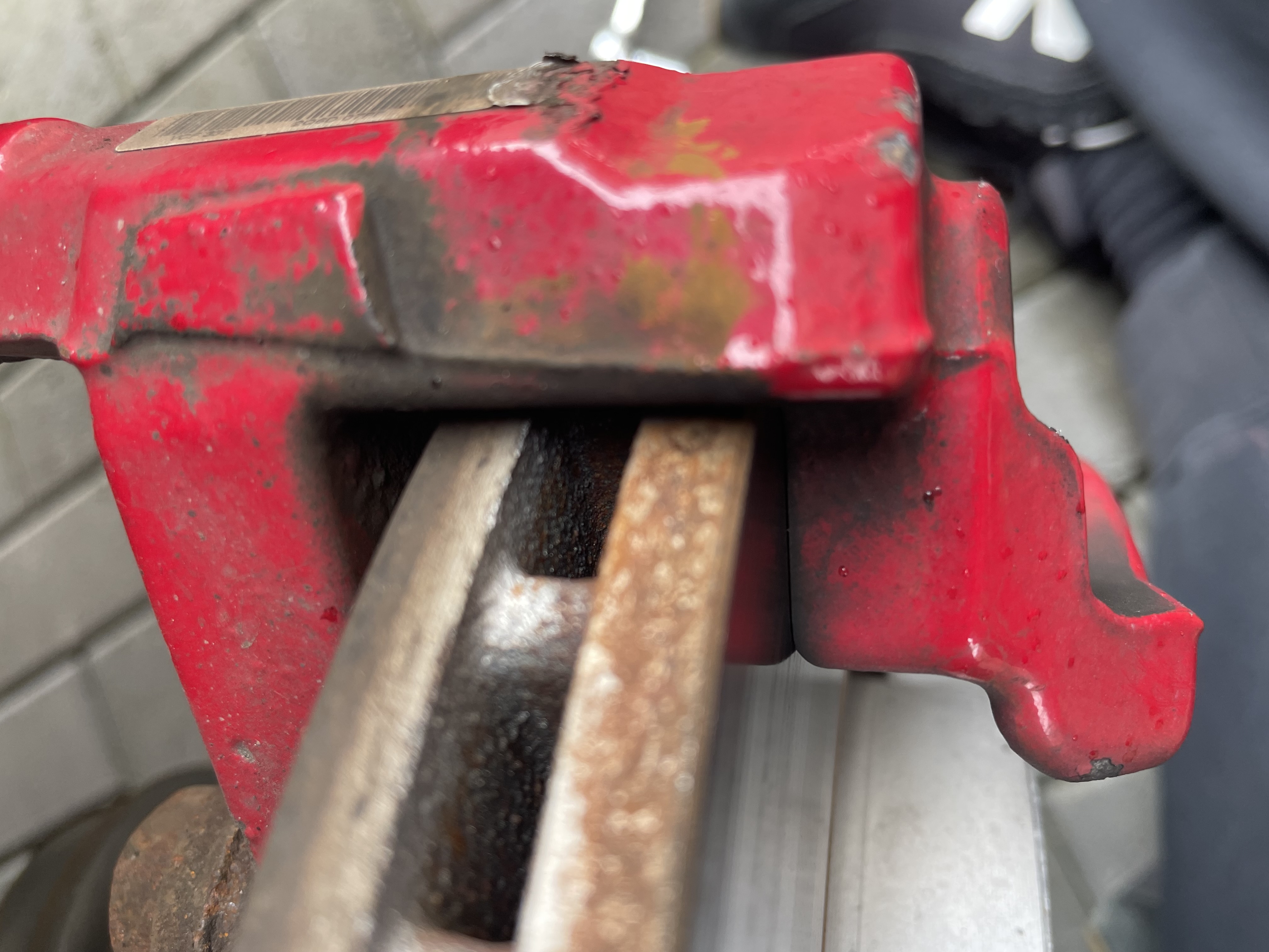

So having taken the wheel and brake calliper off to check for any debris I noticed the disk was very very close if not touching the other part of the calliper. See attached images. Is this right? This doesn’t feel correct, the spacing is way off imo but I don’t see what could cause it to sit so far out that it touches the brake calliper.
Can anyone confirm if the Polo GTI has a dust cover behind the brake disk?

Re: Front Right Wheel Squeak
Dropped my car off at a garage last night and got a phone call this morning - needs a new wheel hub.
Garage is speculating that the left side of the car has had all new suspension etc (forgot the other items he said but will confirm when I collect) which is either from a crash or just suffered damage.
£418 for new wheel hub (which is VW only supply) inc labour.
The right side (being replaced) was mauled and the wheel hub for whatever reason was not sitting flush, which then prevented the ABS sensor from sending correct signals throwing up all sorts of related errors with not being able to read the wheel speed... as well as the squeaking.
