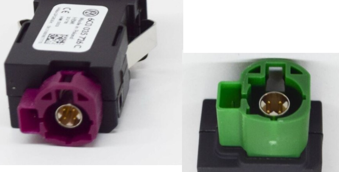

Hi everyone, after (unfortunately) being quoted around 300-350€ for AppConnect activation (via dealer), I wanted to take a look at the USB socket that also likely needed changing to be compatible with Carplay (Apple), because only one of the dealers I asked confirmed that this will need changing too.
I was able to pull out my USB socket without taking apart the entire center console (fortunately) and found out I have the "6C0035726C" socket, which I understand supports AppConnect and Android Auto, but does not support Apple Carplay. It is purple and has the main cable + 2pins on the side.
Now based on the info from viewtopic.php?t=74656, I now need a "6C0035249B" socket that supports Iphones. My headunit is 3Q0035824B, SW version H28.28.133_STD2Plus_EU, 6C 2017.
After searching, I'm not entirely sure of a few things and wanted to clarify:
1. Let's say I get my hands on a "6C0035249B" with the extra 2 pins - is the install straightforward, i.e. unplug the old socket and plug in the new one? Looking at the pictures I found online when comparing those two sockets, It seems that the new one would be physically able to be connected (see screenshot below).

I managed to order a new "6C0035249B" socket (green, HSD 4 pin + 2 pins on the side), just based on the pictures from the item listing, did not check with the seller.
Since the 2 extra pins supply 5V power to the USB port, and I currently do have those 2 pins, it made sense to order the same thing.
Some detective work followed - I checked pinoutguide.com and this HSD infosheet - https://www.delock.com/infothek/FAKRA_H ... hsd_e.html to confirm whether I need to do anything else or if this new socket is just a plug'n'play.
Good news is, the HSD 4 pin pinout for the socket should be the same (unless one is using a knockoff cable), the bad news is that based on the color of the HSD connector (e.g. green vs. violet), the little plastic tabs inside the connector are different (see the Delock HSD web above) which prevents using differently color-coded male and female connectors together, as was further confirmed by this video by mr fix: https://youtu.be/7yTYaxzeXfY?t=163
Luckily it seems that it can be solved by just simply shaving off one of the plastic bits that are in the way.
I plan to test it this week and should that work, book an appointment at the stealership for the appconnect activation code release, and code 5F myself afterwards to support iphones.

4. Check which USB socket you have. I managed to extract mine from the center console by using 2 small plastic trim tools without disassembling the whole console or damaging anything.
5. If you have the purple "6C0035726C" and you wish to use Apple CarPlay, purchase the green "6C0035249B" socket.
6. Disconnect the fakra connection and shave off a tiny plastic tab present on the car-side connector (follow this video https://youtu.be/7yTYaxzeXfY?t=163). This is to "force" the green USB connector to the "older" purple cable. This way you don't need to change the whole cable. For differences in connections, see the post above.
7. Connect the new green USB socket to the old purple cable connection (I suggest not fully pushing it down into the console trim just yet, without testing)
