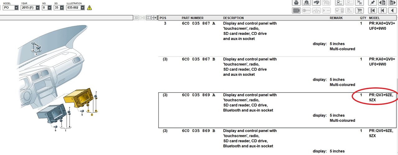

this is the printscreen from ETKA
There is no PR CODES for camera (KA0 or KA1), so i guess your infotainment is not capable for rear view camera.

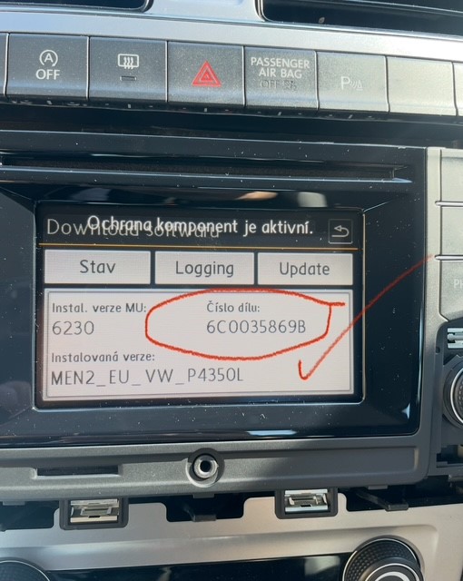

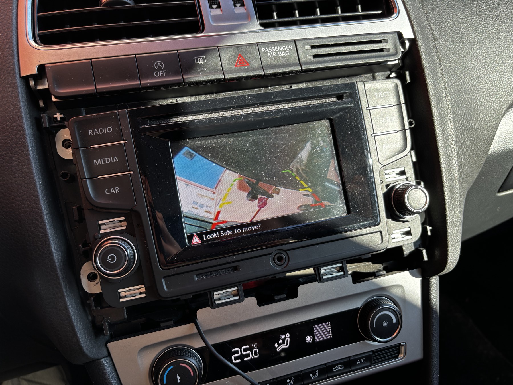

Hi there! Today I was able to test the functionality of aftermarket camera as we were discussing before.
My OEM radio is able to get the signal even that it doesn't have KA1 mark on the image that you sent to me before. All I had to do was to activate reverse camera on VCDS.
For everyone that wants to use NTSC camera on 6C0035869A, IT WORKS :)

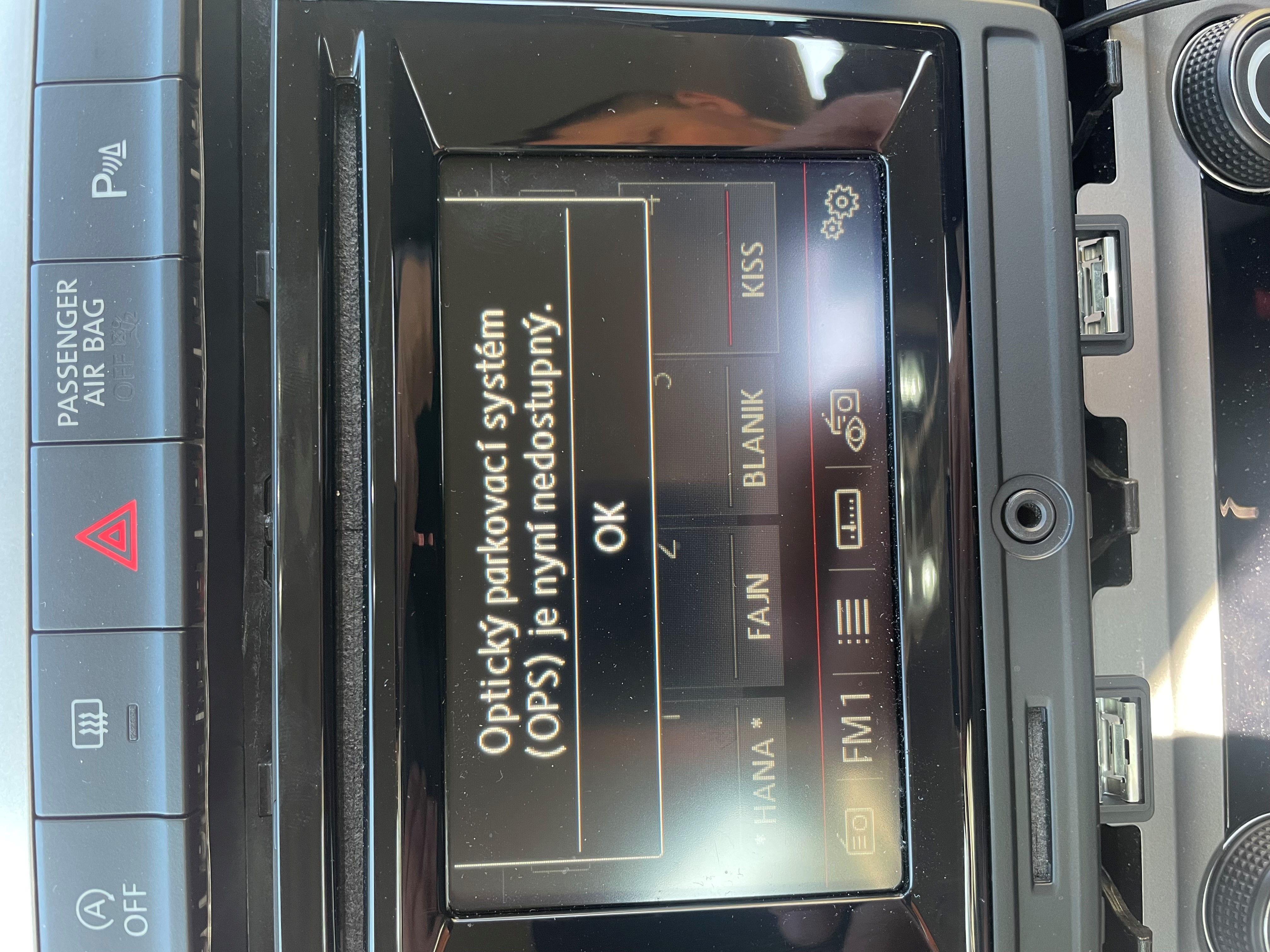

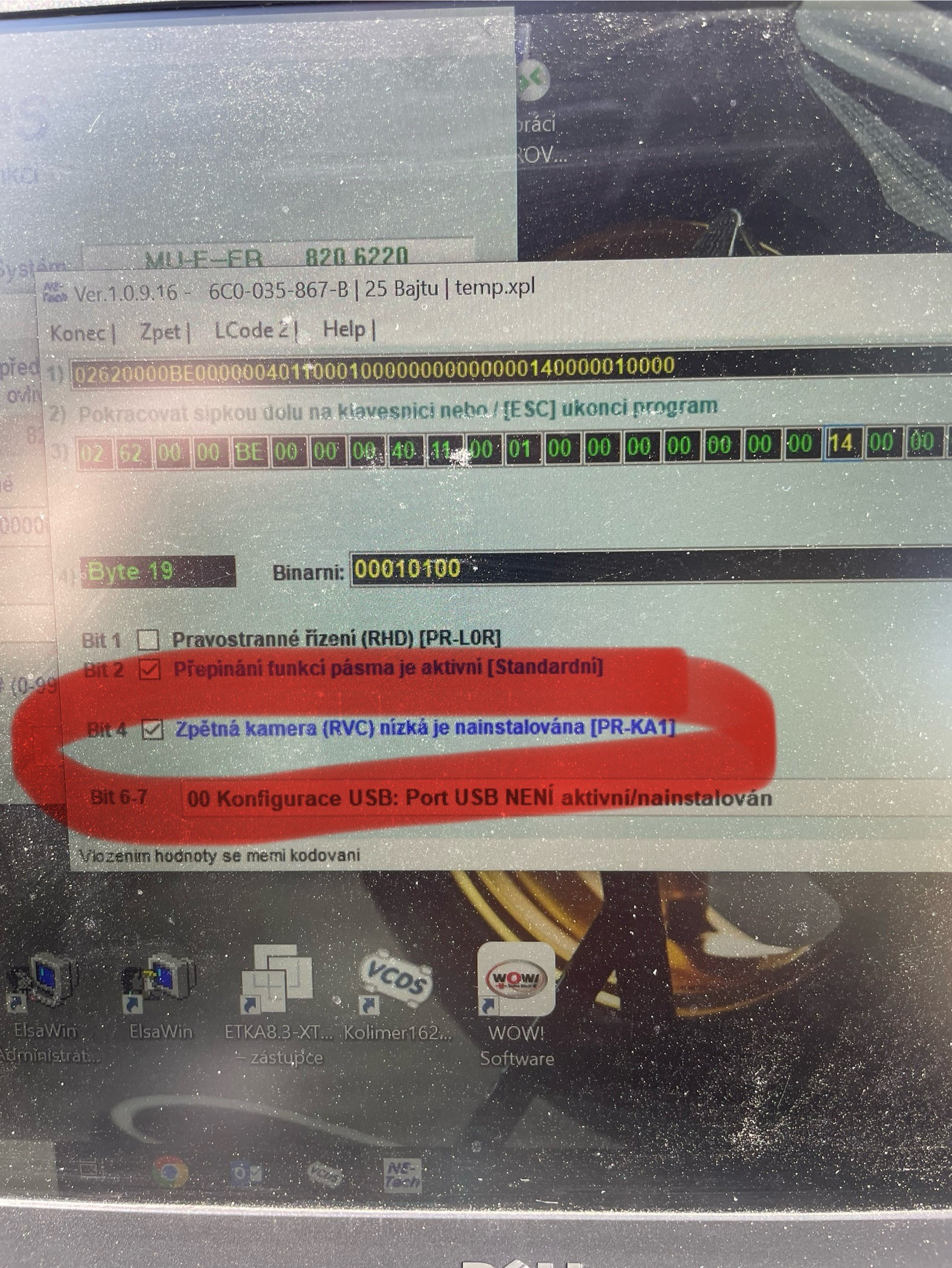

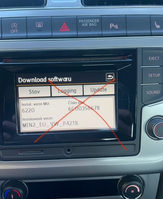

Hi guys,

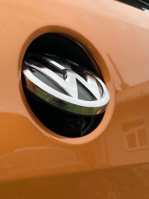

My wife has a 2015 Polo 6C with front and rear parking sensors and I installed the original rear camera.
When coding the 5F rear camera RVC unit, the radio displays the message (optical parking system (OPS is currently unavailable)
In the 5F fault memory, the control unit error is incorrectly coded.
Can you please advise me how to code it correctly?
Thank you very much to everyone for the advice!!!

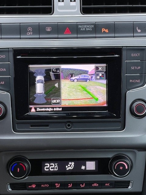

Hello,
I'm updating my post.
I had a bad radio 867B doesn't support camera. I replaced the radio with 869B and the camera works !! ;-)
