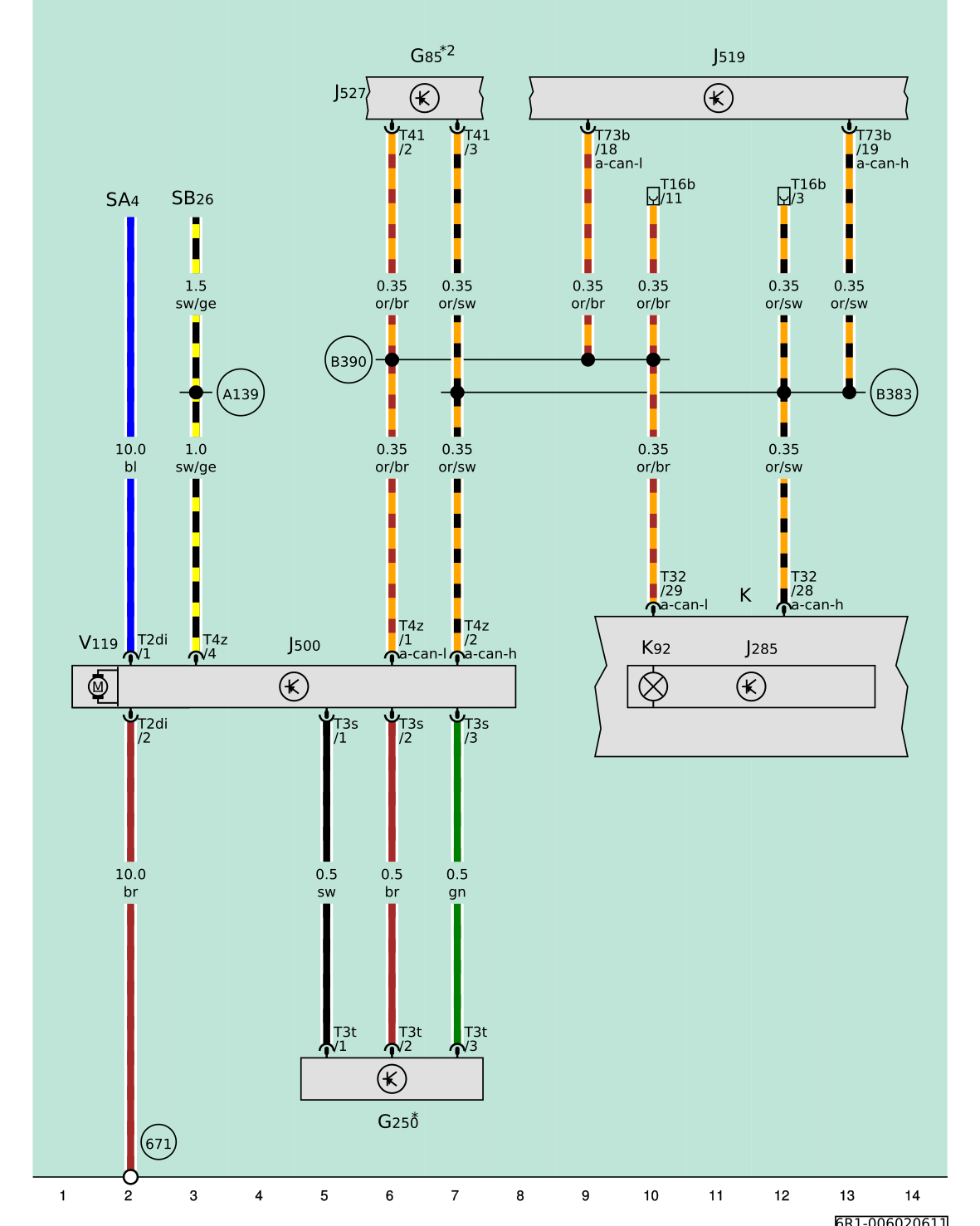

Re: Power steering problems
J500 is the steering pump
Wire color:
ws = white
sw = black
ro = red
rt = red
br = brown
gn = green
bl = blue
gr = grey
li = purple
vi = purple
ge = yellow
or = orange
rs = pink
sA4-blue is +12V
and Sb26 is +12V ( ignition on)
And can-hi low resistance 60-70 ohm ( battery negative terminal off)
check if the can hi, and can low isnt shorted to +12 or to gnd ( continuity test is ok)
If you dont have g250 then one of the connectors on your abs pump will have no wires coming from it.
