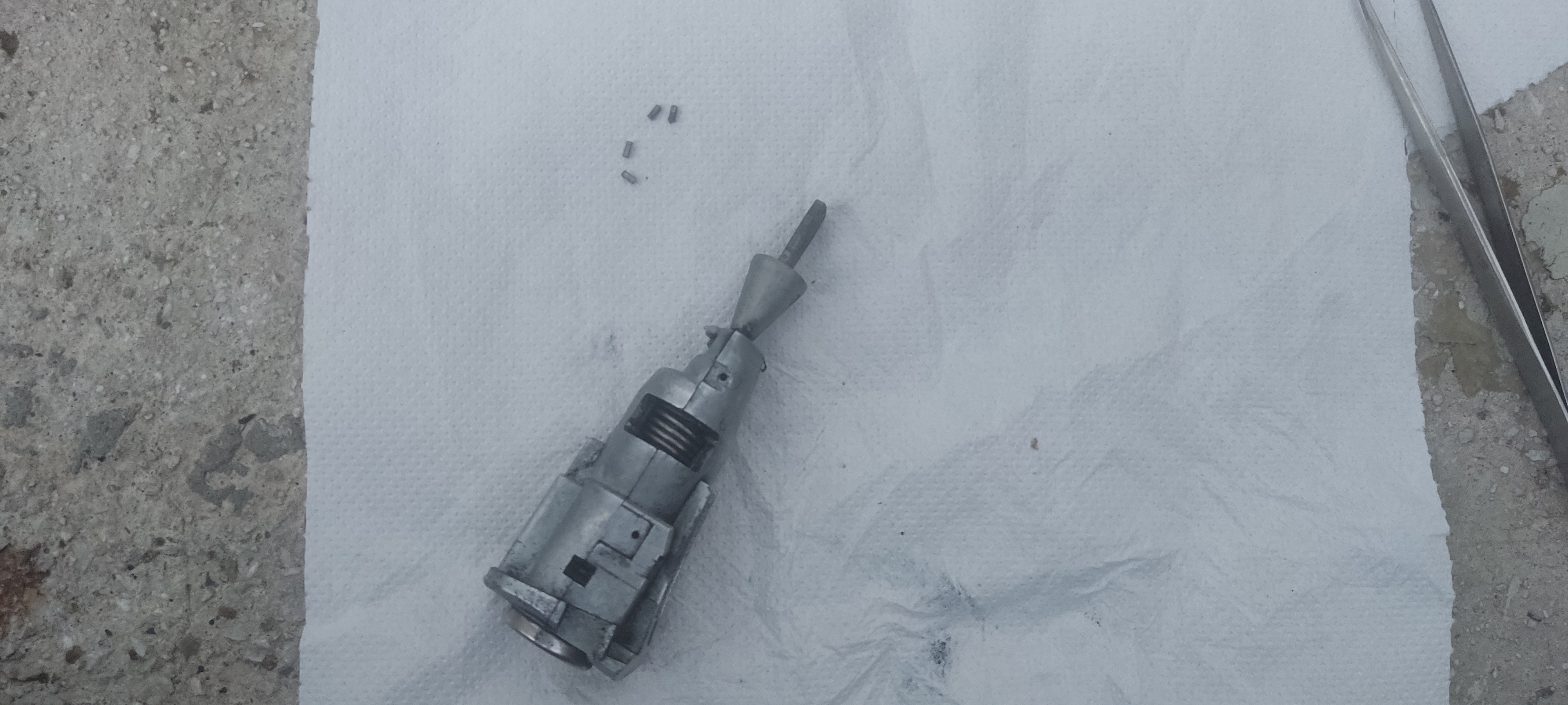

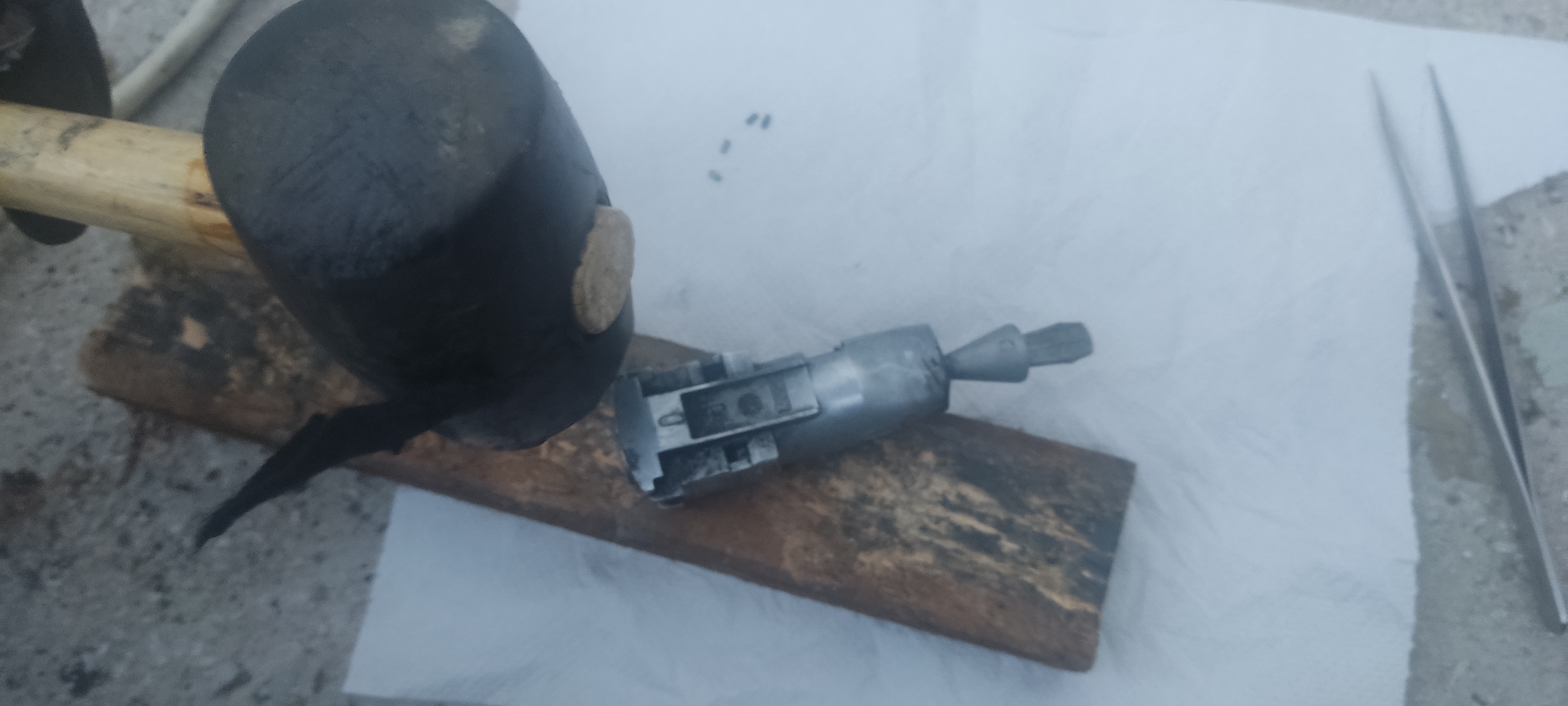

Put on gloves, rubber hammer ( it doesnt leave marks on the cylinder lock), regular hammer works fine, but it will leave marks.
Piece of wood.
The half's of the lock are attached with metal pins( they arent steel so magnet wont work to remove them).
there are 4 od these pins.

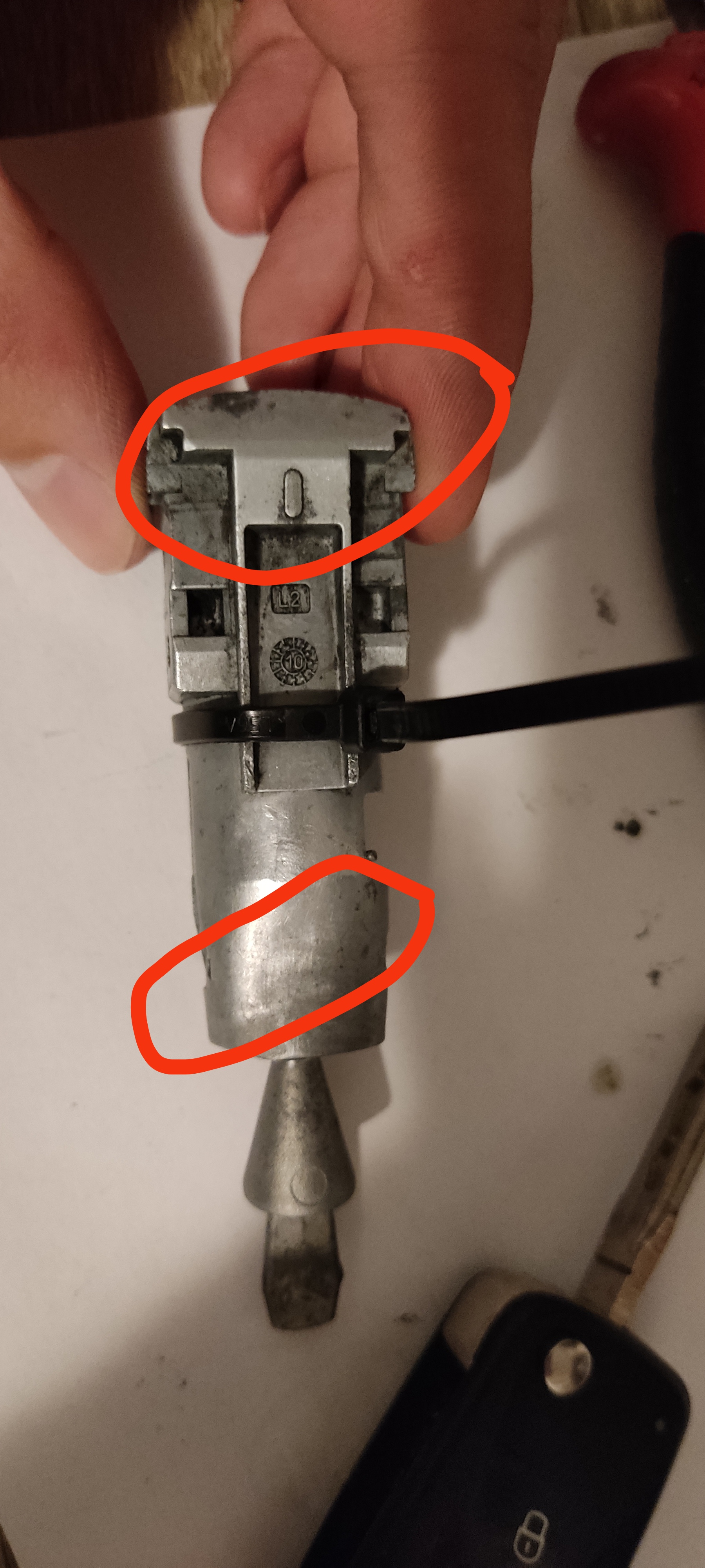

Id recommend hitting on this part
Also you will need some really good pliers that have a grippy end, when the pins start to move out ( from hitting vibrations) grip them and remove them.
This is my second lock. and i always have problems with last pin. But patience is the key. Do not use a screw driver you will brake the body.
Id avoid hitting the body in weak places you can bend it.
Some people drill these pins out. If you have issues removing the last pin, you can use a drill to widen the the hole at the top so the pin goes out easier. No need to drill it thru.

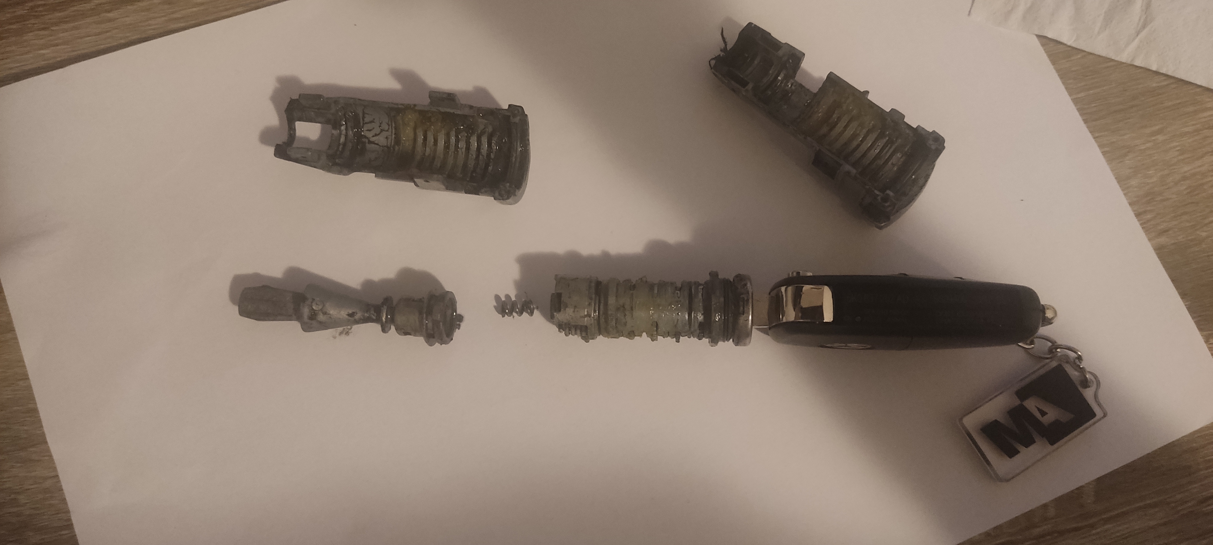

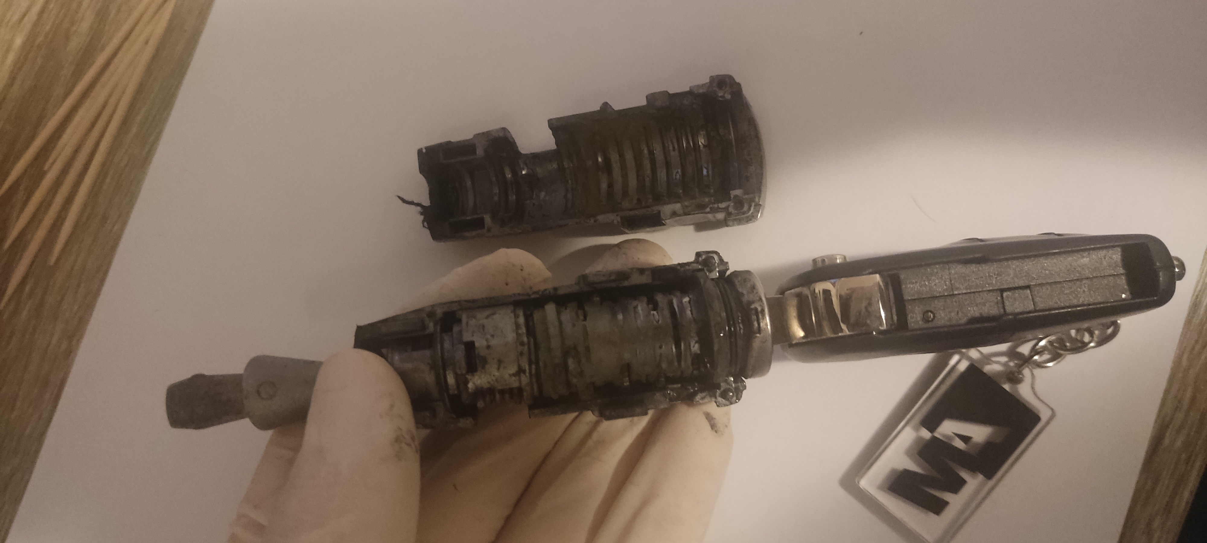

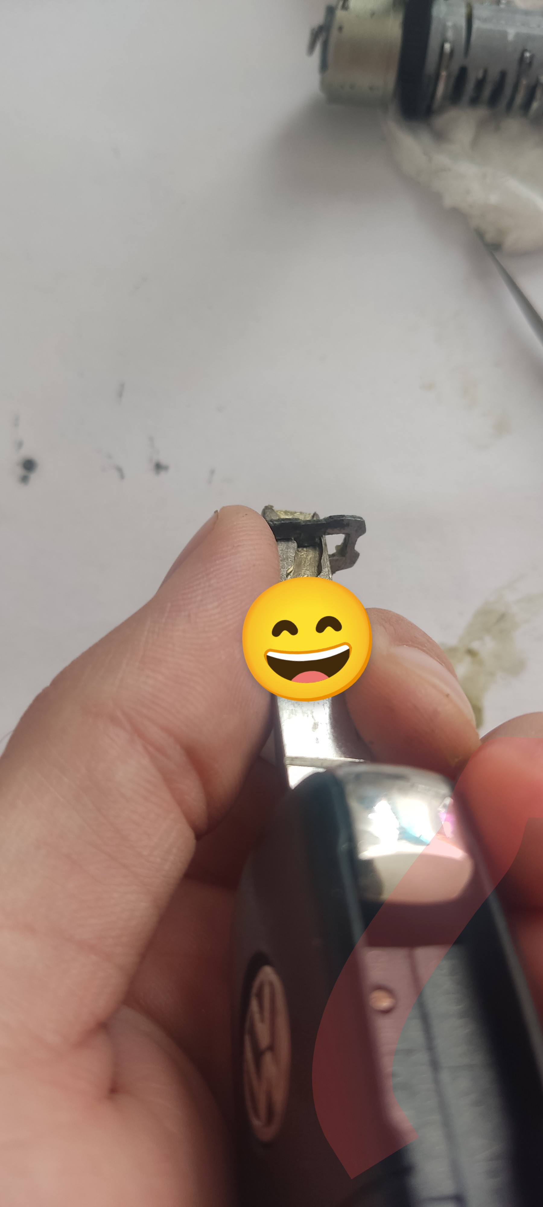

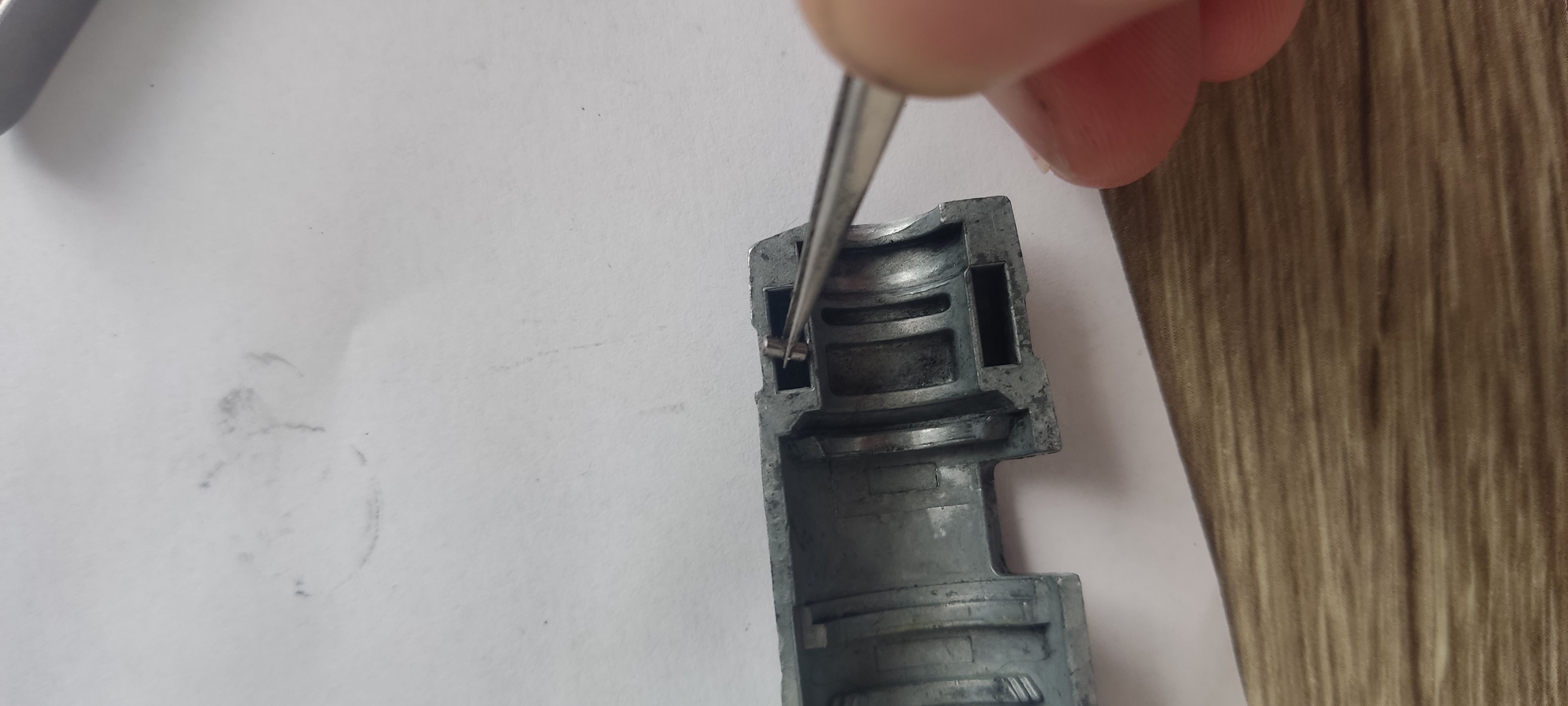

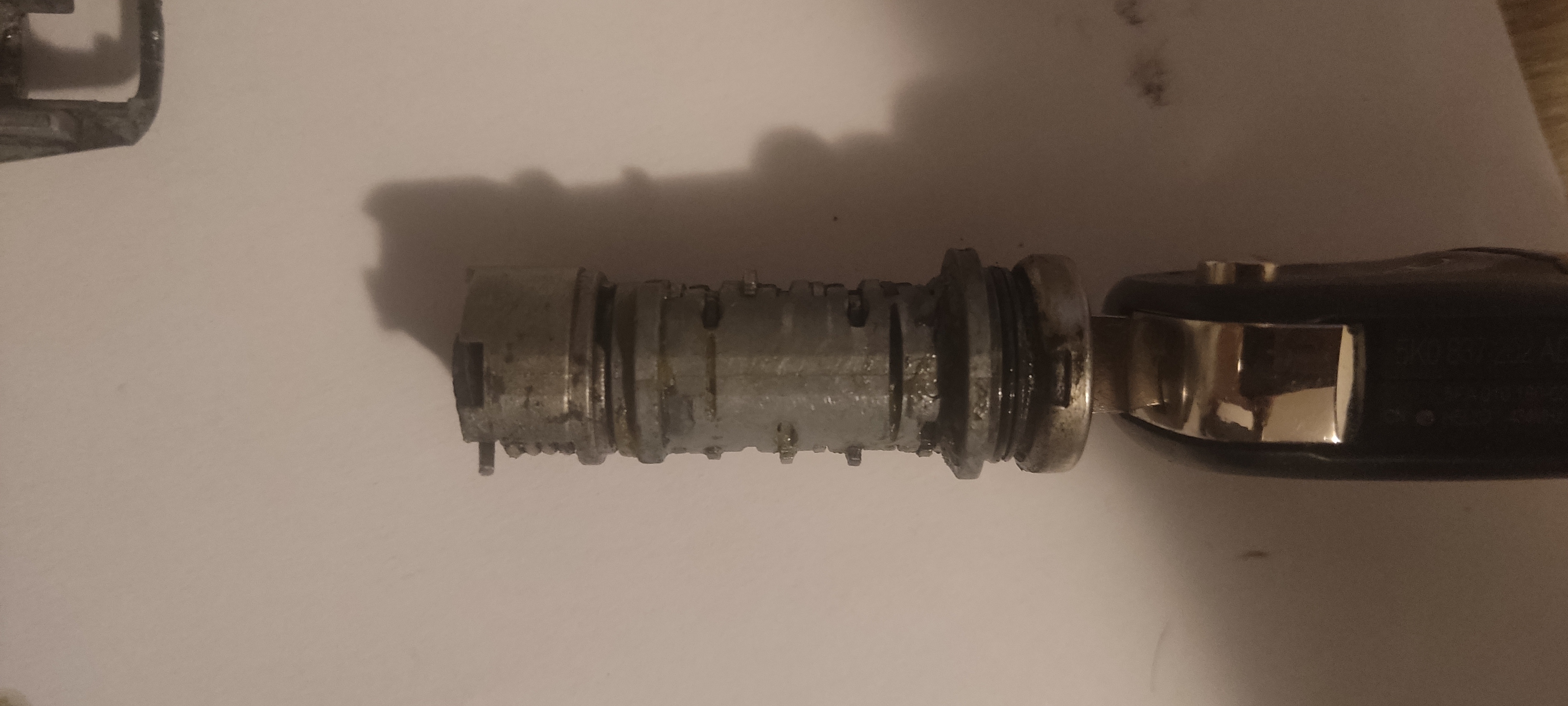

Next part - stick your key inside the lock. ( This will prevent the lock plates that are codes to your key to fall out).
When you remove it, clean the grease from these two half. and to clean the cylinder use oil and work them. If you want to clean them, remove the key one notch and you will be able to pull top and bottom lock plates and clean them.
Note the little spring

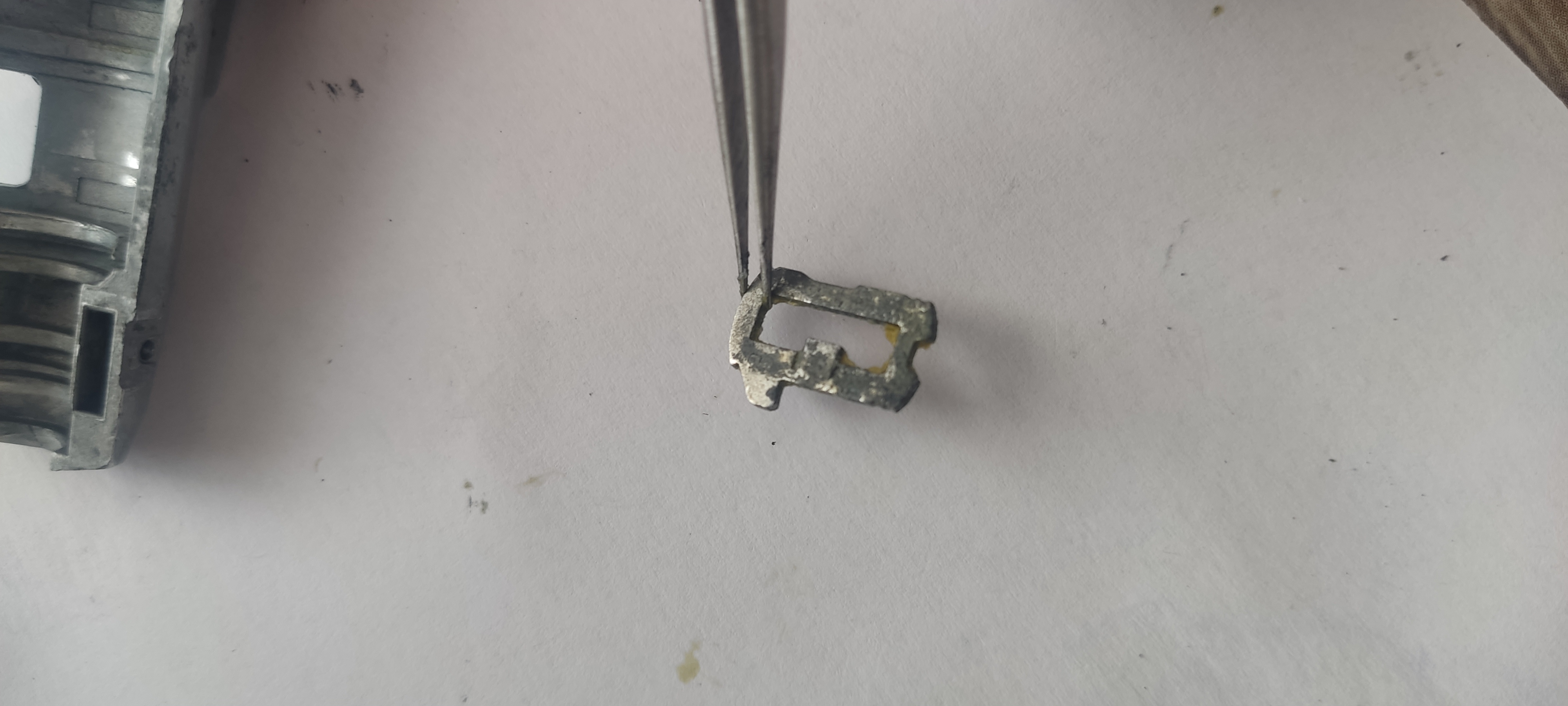

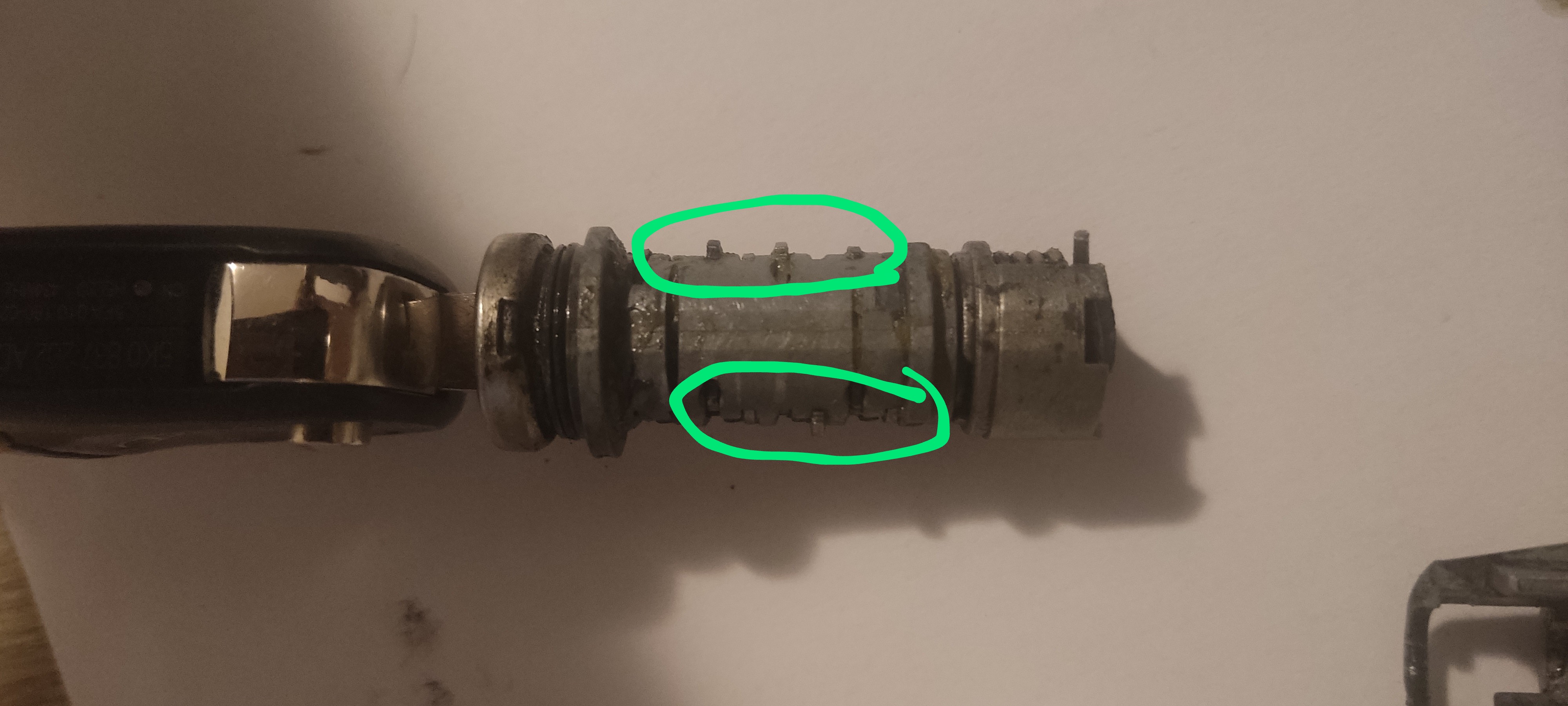

You can see corrosion on these lock plates now is the time to give them a clean/polish or replace.

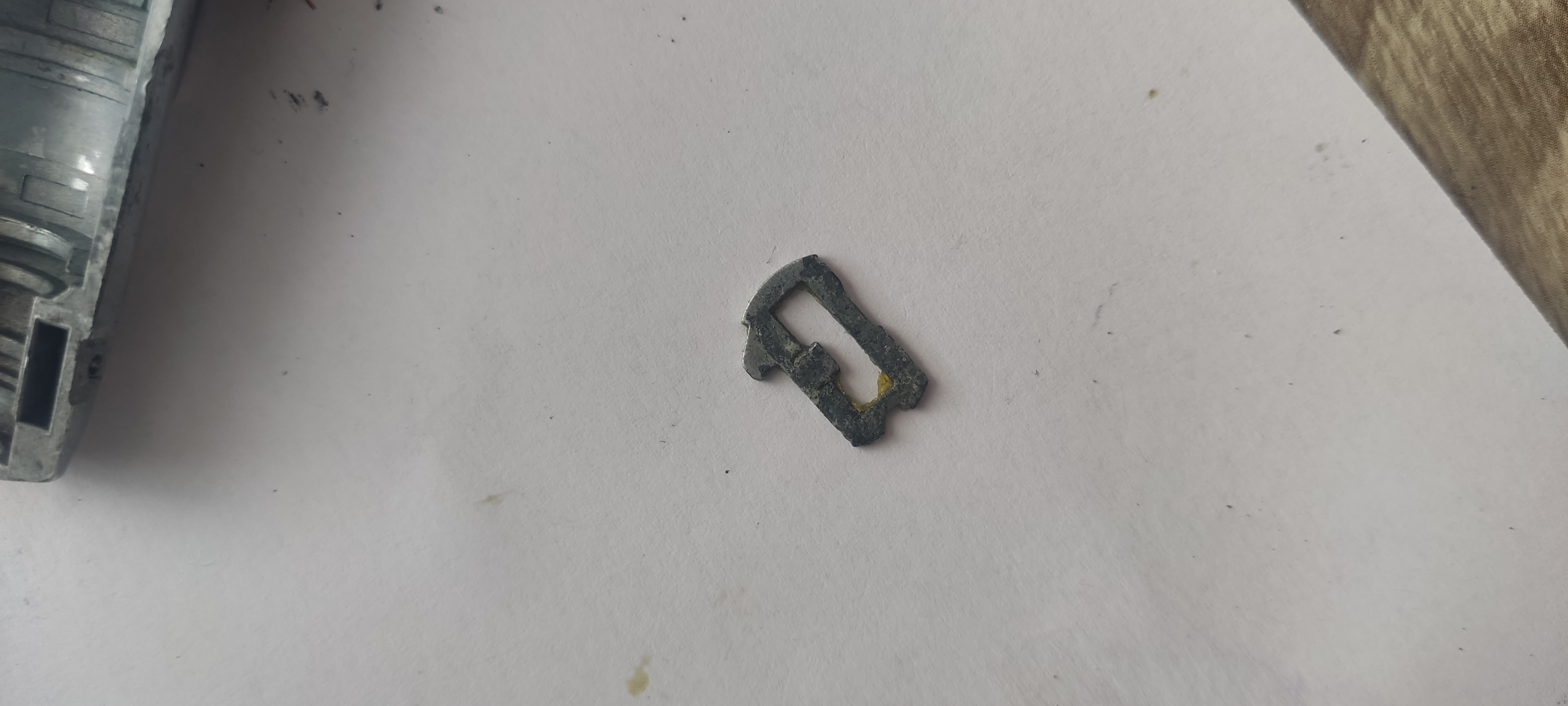

They are numbered (each shape has its code/ number)
You can buy these new on aliexpress ebay etc.

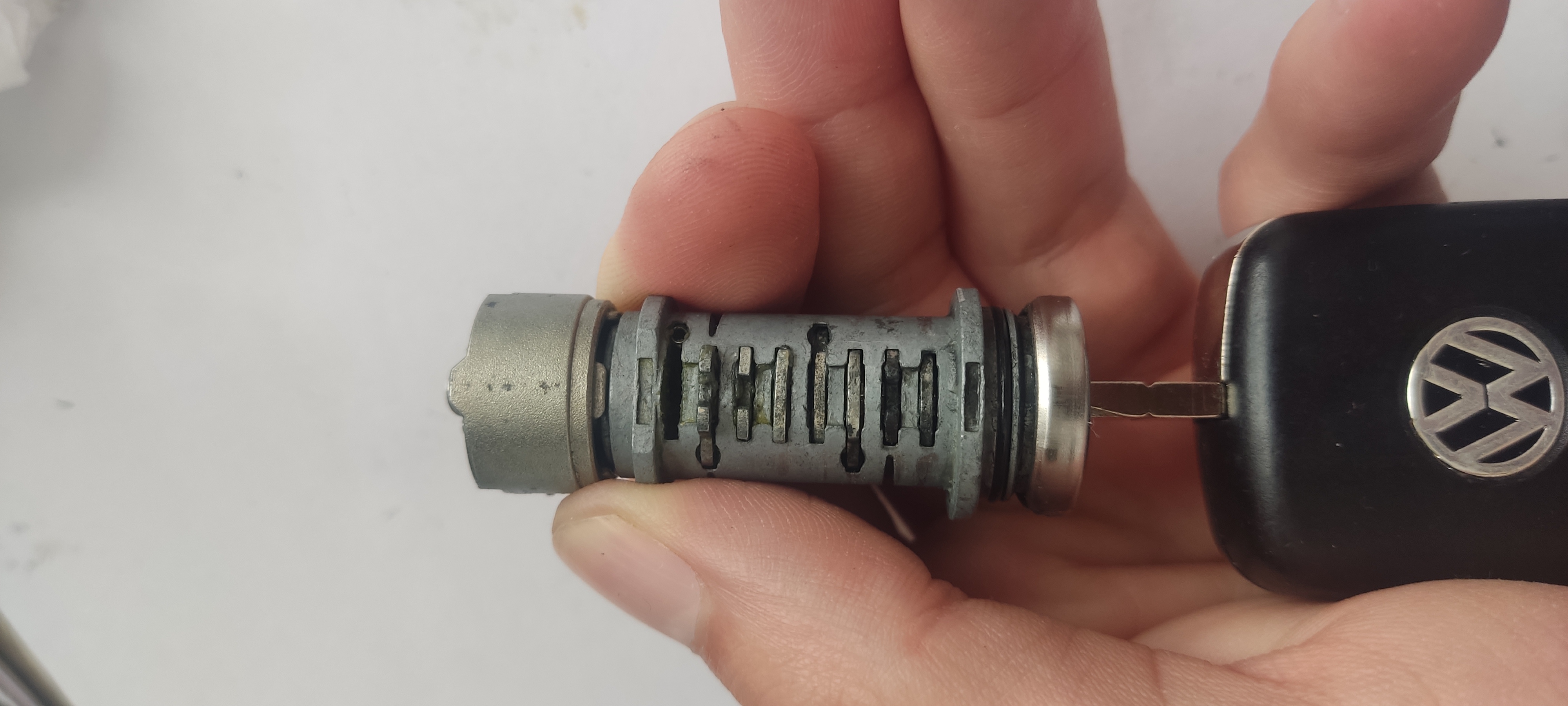

If you want to remove all of them( use a zip tie over the ones and work you way down the key, everytime adding a new zip tie so they dont shoot out!
they are called HU66 lock plates
When correct key is inserted these locking plates will become flush with cylinder lock making you able to turn the key.
If you buy a used lock, you can use a file and file these down so they are flush so you can use your key.
Or buy a pack of locking plates and replace the ones that dont sit flush.
You can see here they dont sit flush since this is a donor lock from scrapyard.

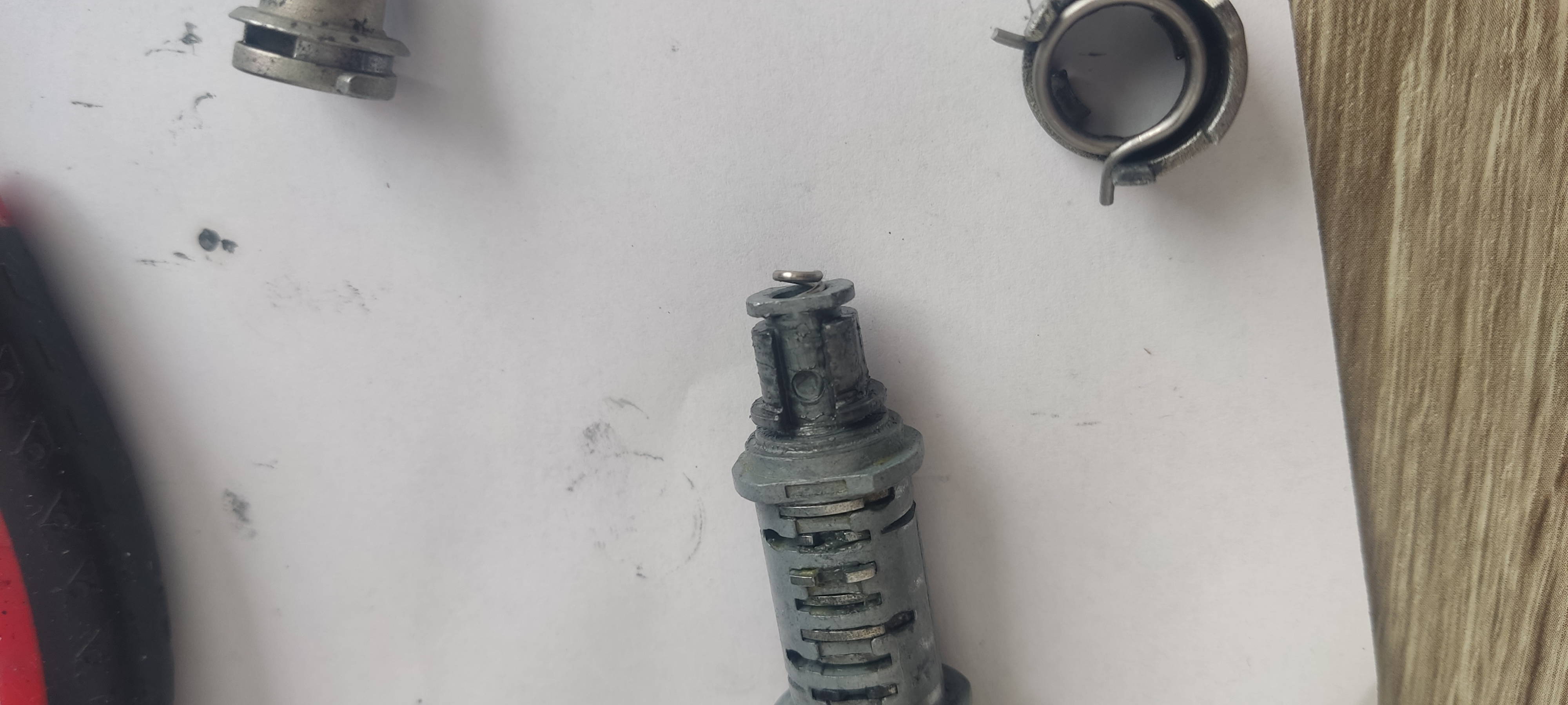

This is an overview of parts inside the lock.
You can even further disassemble these.

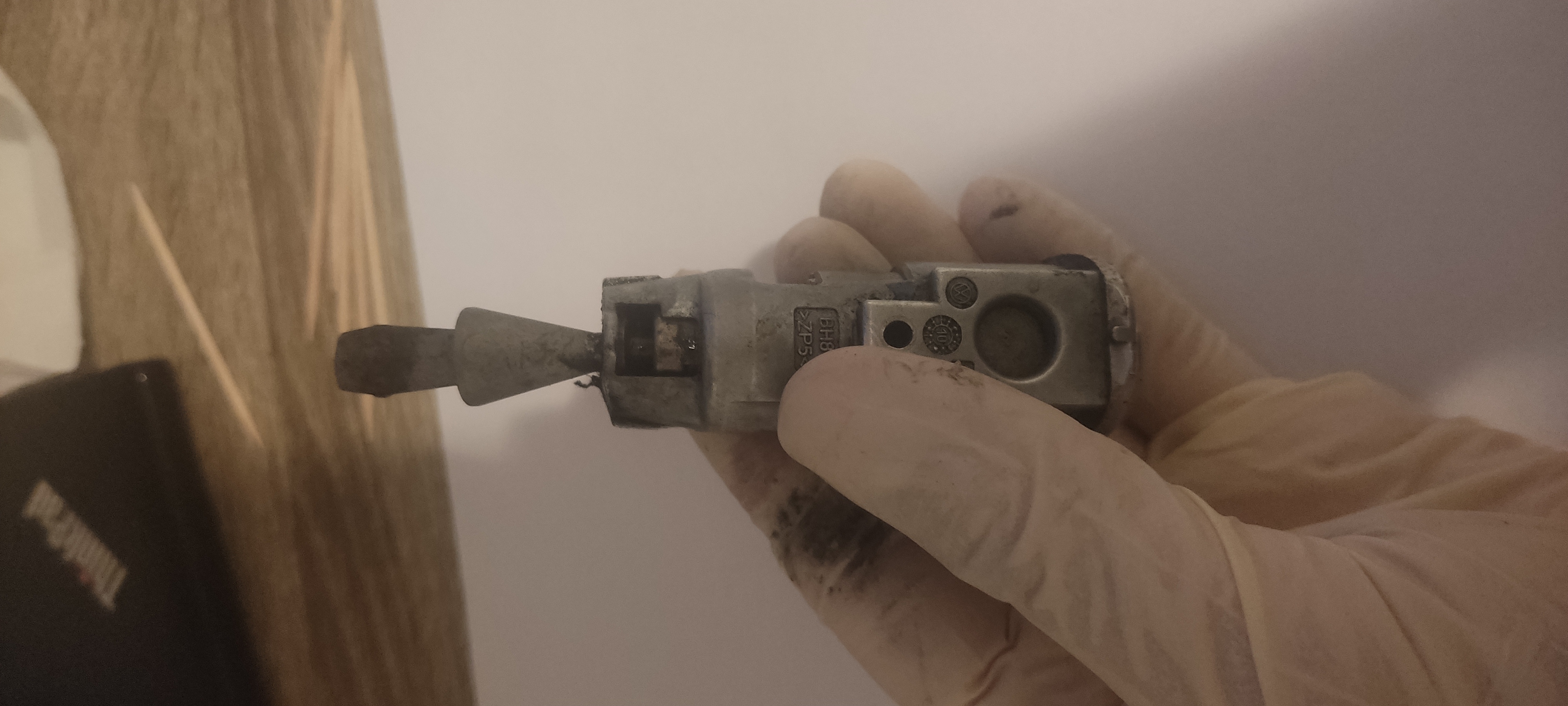

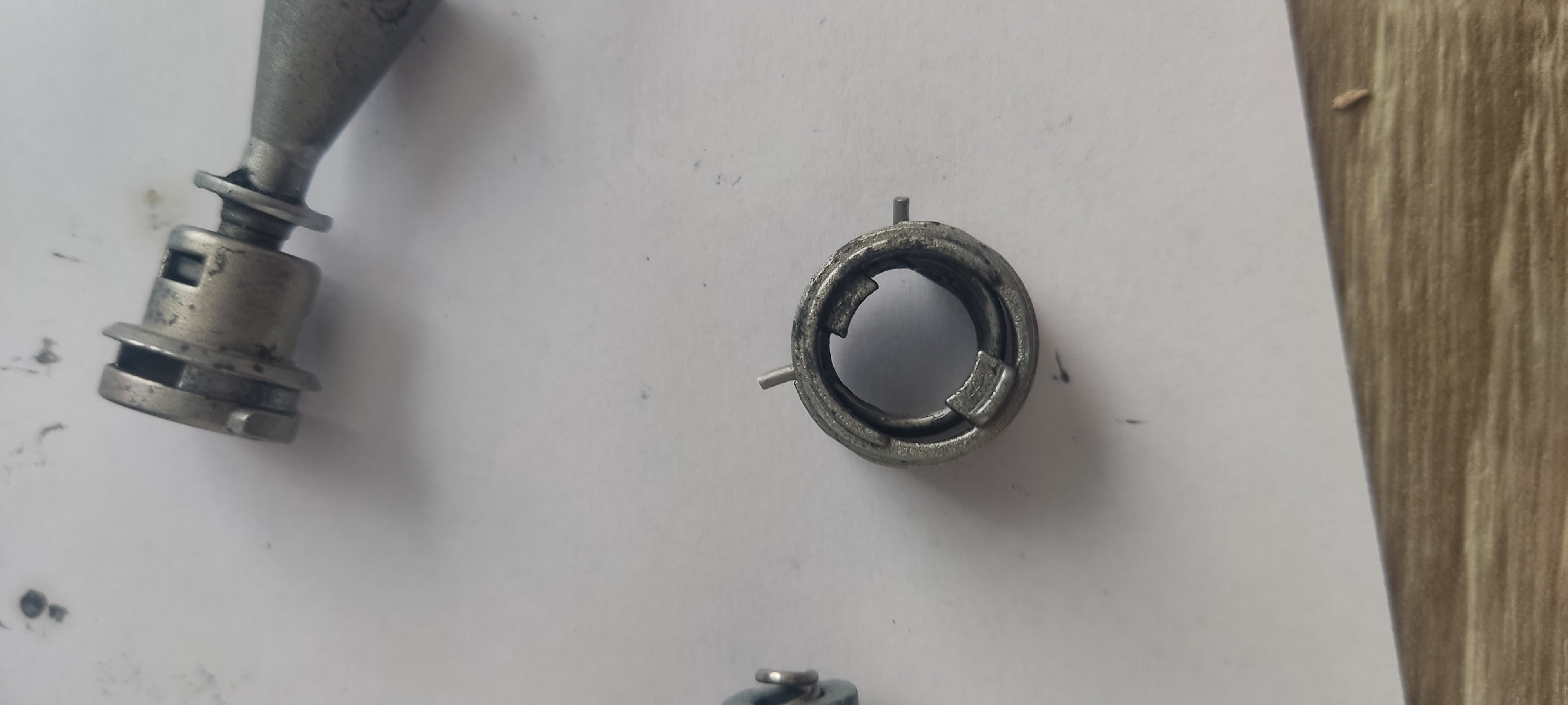

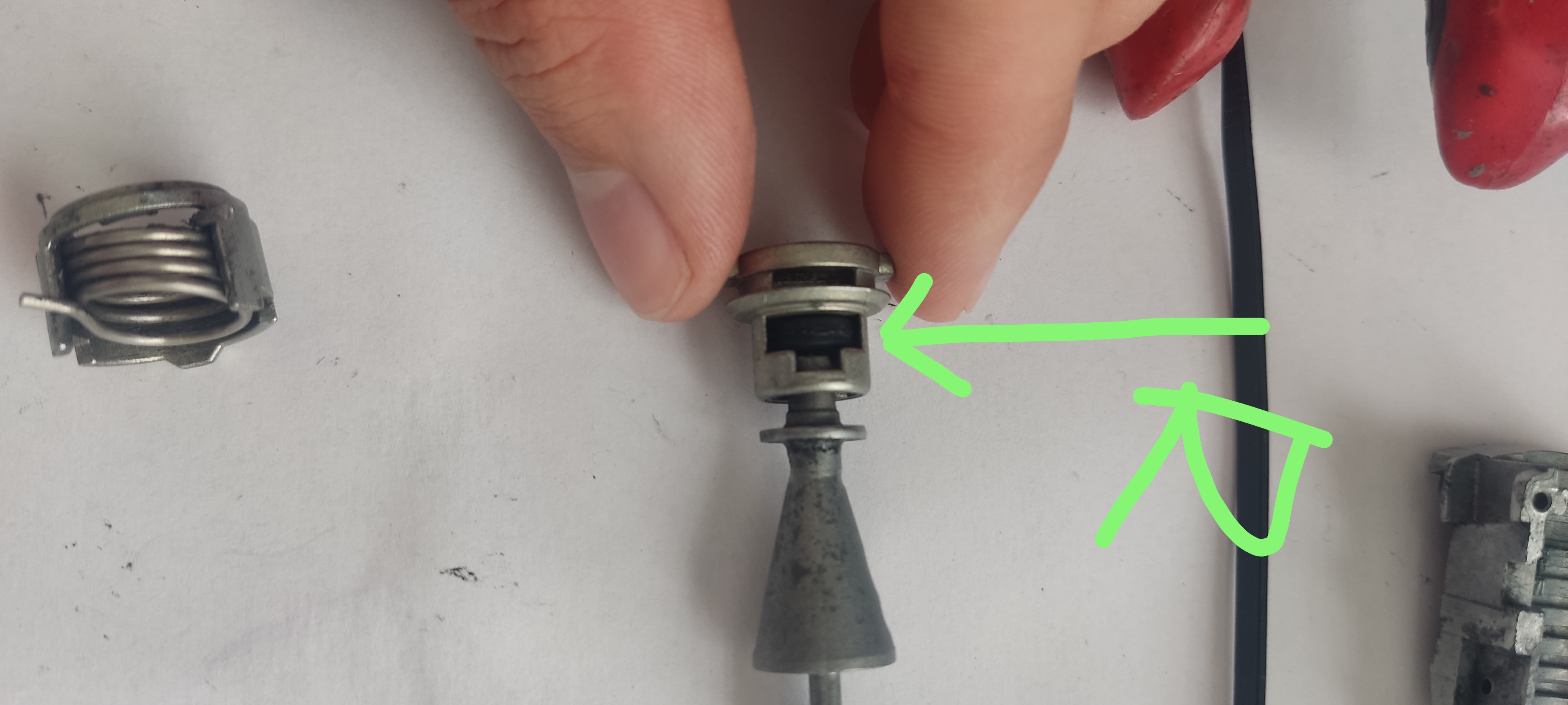

To remove this part like a paddle there is a rubber
bushing use a wooden toothpick and remove the rubber bushing- then you can slide out the paddle looking part.
The spring is under tension, so if you remove it you will have to put tension on it ( press down and hook the other end of the spring in its place - you cant mess it up since the paddle needs to sit in it place/ groove.
To remove the ring that holds the spring just turn it around untill the keyhole groove matches and slide it up.
