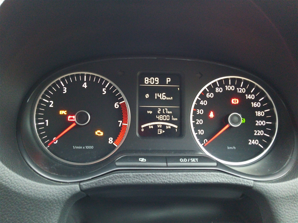

I have a 1.4 MPI 86ps, 7-speed DSG, trendline Polo, include "basiest" cluster(even no BC stalk) clean Steering wheel,Image
(same my)
then I upgrade by step until now the complete MFSW wheel(MFSW control unit-- 5K0 959 542B, GTI paddle shifter-- 1K0951527 and 8, and stardand two-side MFSW buttons). but not working on right button, I tried every code what I know, but no luck. seems every susess case works only with MFA even MFD+ I saw, but there is specil case show me the MFSW work perfectly with basic speedo(his 1K golf 6 Display screen even smaller then mine!!)https://www.vwvortex.com/threads/huge-d ... 6.5660041/ . serieousIy, I never seem any MFSW+basic MFD cases like me yet, I really want to know it's possible or not.
Im really confused.
