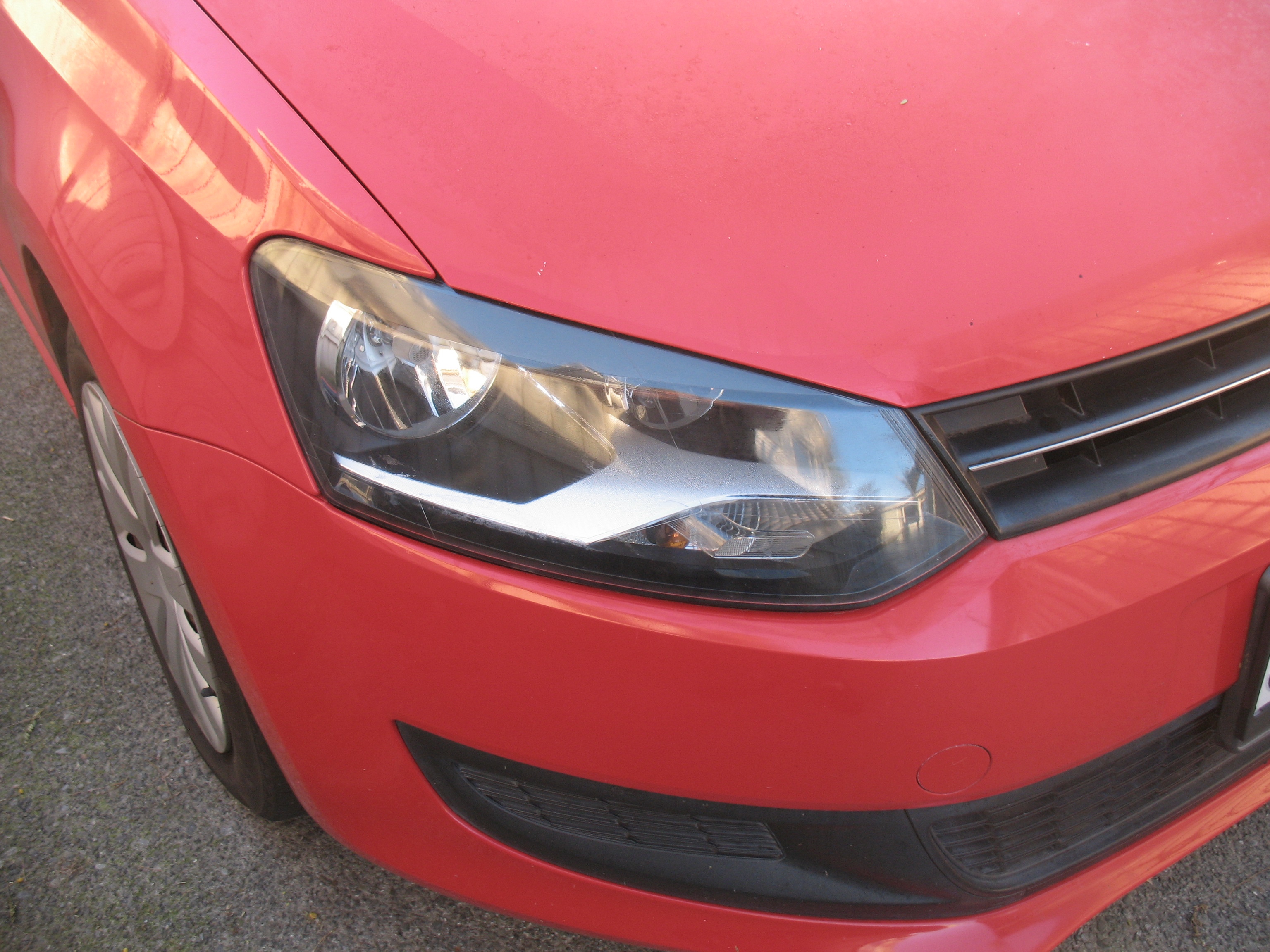

The lights currently fitted to my car are shown in this photo.

6R2941008F RHD Right
E was replaced by F.
you can even install the halogen twin headlights from the POLO '6C' (2015->...). Direct swap.
You mention that used headlights are expensive... hmm, what is expensive for you?
...no answer necessary... I guess expensive is something that doesn't suit your pocket.
At least there's a YouTube video showing how to disassemble (take a part) these headlights piece by piece, in case it inspires you to do so to get to those damaged internal wires, but I don't recommend it under any circumstances. Some parts of the video are a bit difficult to handle personally due to the damage caused to the headlight housing, despite the excellent work done by the author.

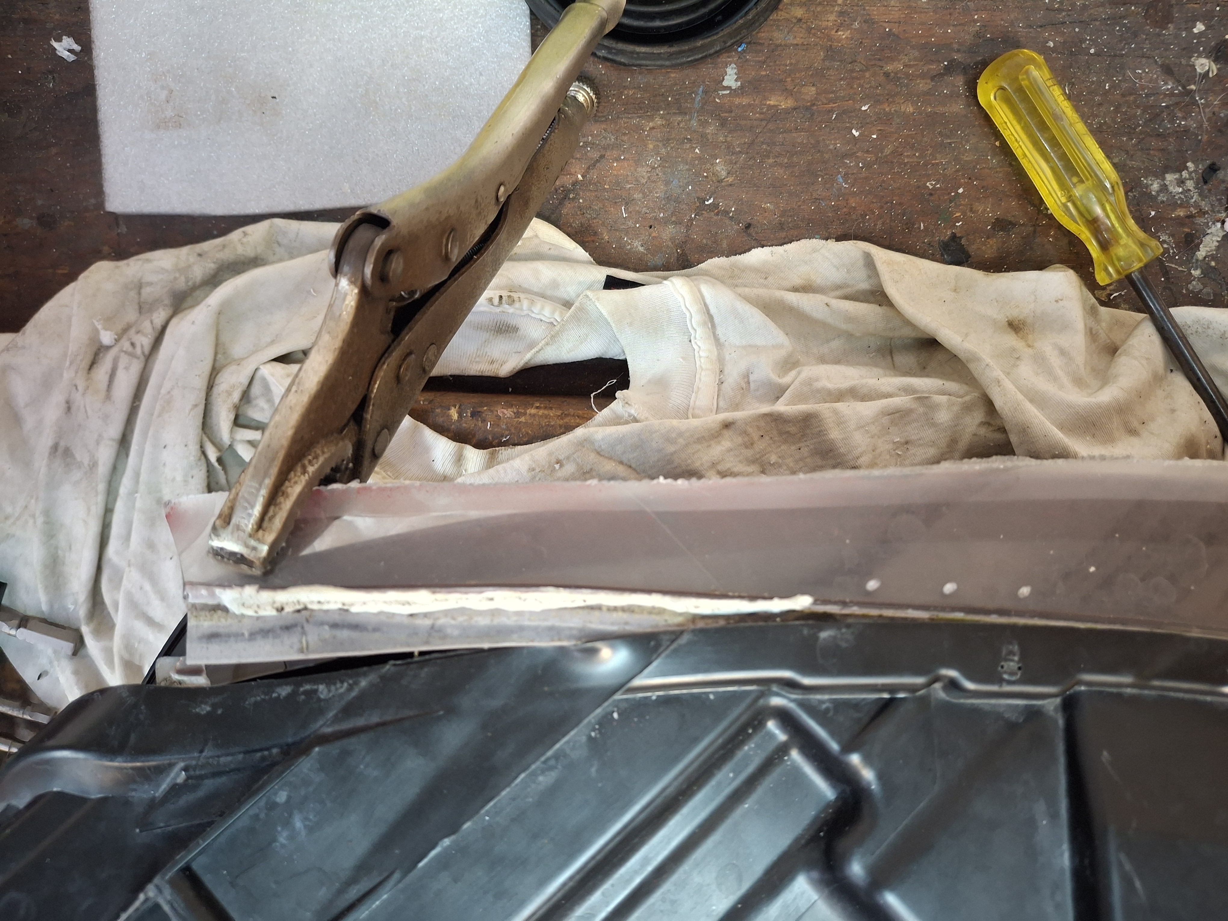

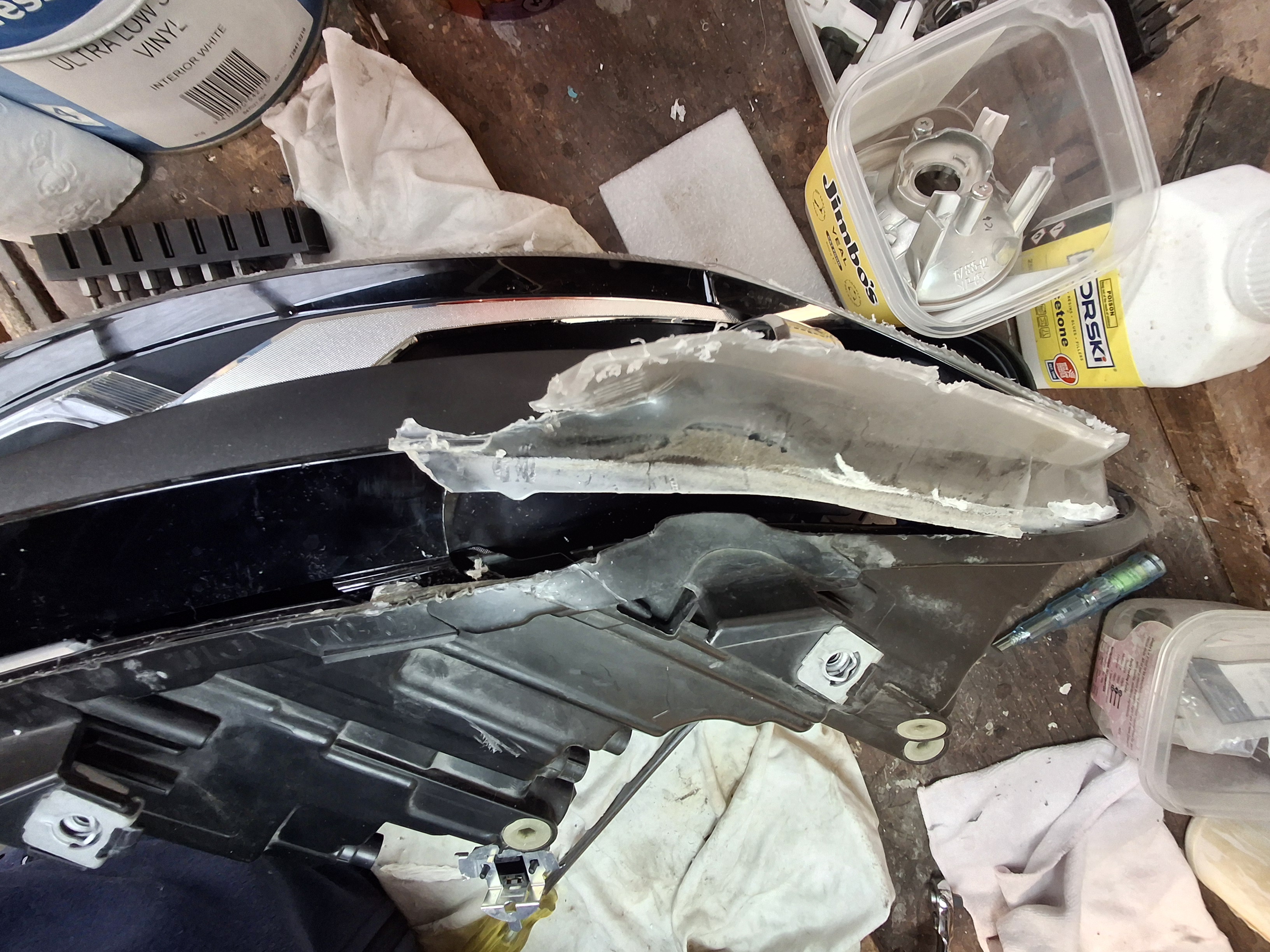

Hi
I sourced a headlight lens from Aliexpress. The lens looks OEM, and probably is. It is absolutely identical to the existing light lens.
I experimented with different methods of cutting away the front of the lens.
Sanding with a disc sander is very slow.
A wood rasp, with really coarse teeth, is the best hand tool.
I found a router to be the best method, but be very careful.
Cut along the corner of the lens.
The glue holding the lens in place is very strong. I found a 50% 50% combination of Acetone and Kerosene worked well to weaken the lens and weaken the glue. Acetone or kerosene alone are not effective. The combination significantly weakens the glue. The key to success is time.
The mix mix needs a couple of days to soak though the glue line. I ran a bead of toilet paper around the glue line to provide a reservoir of solvent, but the acetone evaporates quickly.
The longer the acetone/kerosene is in contact with the glue line, the weaker it will be.
If it is all done right, the remaining strip of lens will just peel out of the glue line. Easier said than done. IMPORTANT Be sure to wear safety googles. If/when plexiglass breaks it flies like sharp shrapnel.
I could not repair my light because the internal assembly is glued in place with tabs that are just too difficult to separate without breaking.
By the time I got to removing the remains of the lens, I had already decided to bin the headlight so I was not careful about damaging the remaining headlight assembly.
