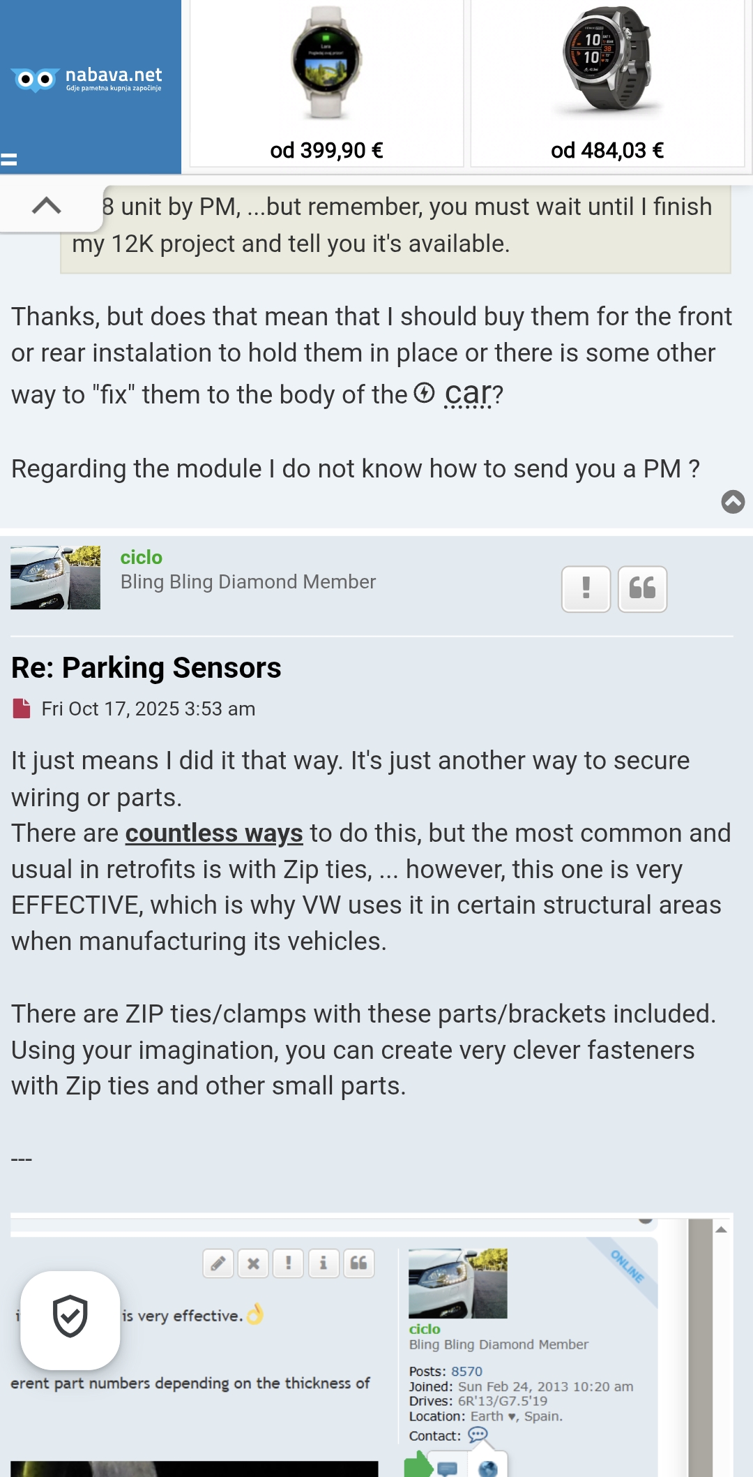

Thanks, but does that mean that I should buy them for the front or rear instalation to hold them in place or there is some other way to "fix" them to the body of the car?ciclo wrote: Wed Oct 15, 2025 3:21 am It is a component/part/bracket for attaching connectors and other parts/elements to the vehicle structure, widely used by VW in its vehicles. It is very effective.

Regarding the module I do not know how to send you a PM ?

It just means I did it that way. It's just another way to secure wiring or parts.
There are countless ways to do this, but the most common and usual in retrofits is with Zip ties, ... however, this one is very EFFECTIVE, which is why VW uses it in certain structural areas when manufacturing its vehicles.
There are ZIP ties/clamps with these parts/brackets included.
Using your imagination, you can create very clever fasteners with Zip ties and other small parts.
I had the private messages folder at 100%, maybe that was the problem. I've deleted 50%... try again now. Sorry.
