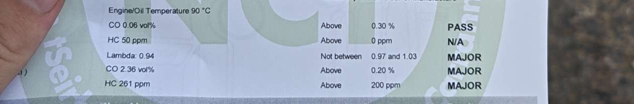

When i bought it it had a check engine light and i scanned the code it had a code for the bank 1 lambda sensor. I also noticed that it had a non genuine catalytic converter in it. I then failed on emissions (see the readings beside the pink highlighter)
After i failed emissions i scanned codes again and catalytic converter inefficiency came up.

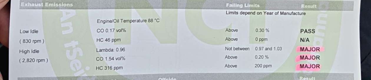

So I then put it through another NCT (MOT)
As you can see from the picture with no highlighter, the Lambda has now got even worse, the CO has increased, and the HC has improved slightly.
Where do I go from here. I obviously have some sort of rich fueling problem but with no fault codes I'm not really sure where to look?!

AFTER CHANGING CAT+ SENSOR
BEFORE CHANGING CAT + SENSOR
